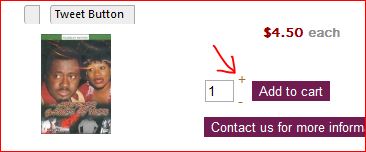

Thank you for the quick reply. I tried to follow your advice – but was unsuccessful. The link below has no variants for the products. If you click on the "plus" sign to increase the quantity to add to the cart, it won’t take it unless you type it. So I think the issue is other than the characteristics.

On that page, you have a javascript issue caused by the module mod_simple_marquee
If you deactivate it, it should work ok.
To avoid the problem, you could try to change the line:
$doc->addScriptDeclaration("<!--\n".$js."\n//-->");
to:
$doc->addScriptDeclaration("\n<!--\n".$js."\n//-->\n");
in the file administrator/components/com_hikashop/helper/cart.php
