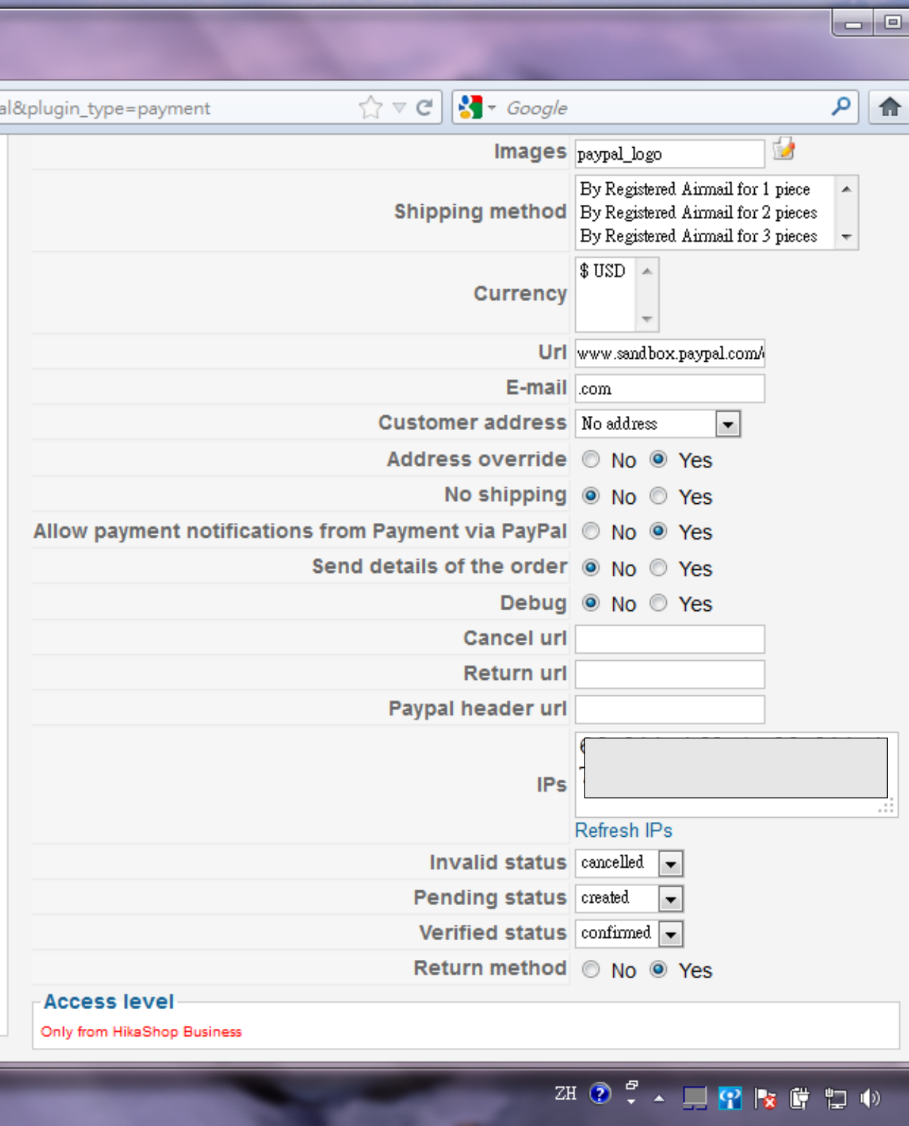

  • Posts: 92
14 years 7 months ago #37721
Did you think the following setting will occur this problem?
1) Configuration > System > Main -- Cart retaining period (there are two LINE FOR SET)
Please advise what is the normal in this setting should be?
2) Since the paypal is error but the order is created already at the back end.
So, does it will affect if client try to create another order again?
3) Attach is the paypal setting for your reference.
Thanks in advance.
Jade

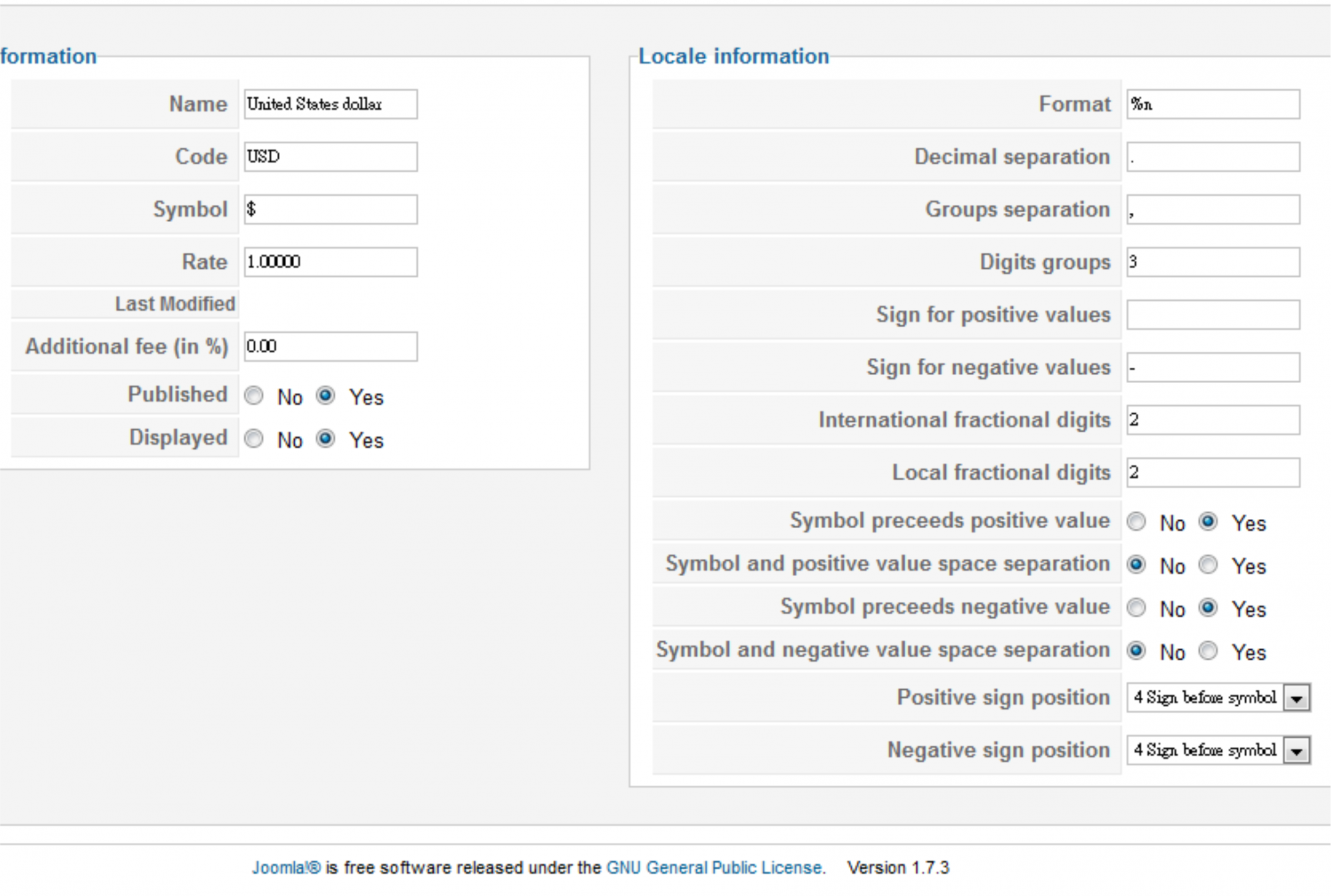

  • Posts: 92
14 years 7 months ago #37830
Good Morning!
Please see the attached and advise which part I need to be set?
Thanks in advance.
Jade

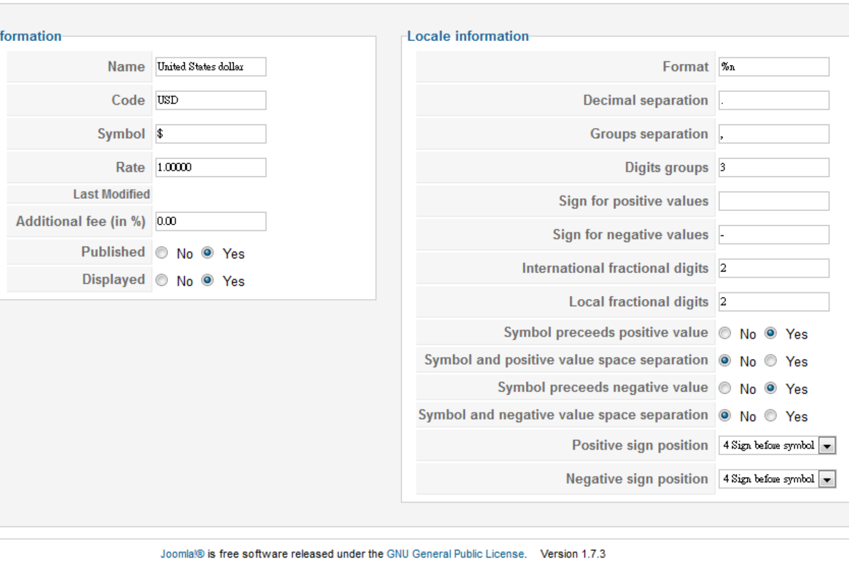

  • Posts: 92
14 years 7 months ago #37831
resent

  • Posts: 86114
  • Thank you received: 14210
14 years 7 months ago #38039
Mmm. That's configured correctly.

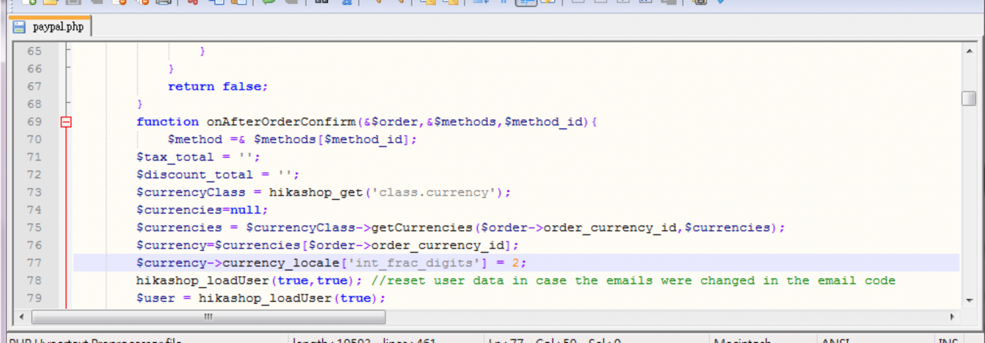

  • Posts: 92
14 years 7 months ago #38066
Hi Nicolas
Thanks for your reply.
Is it like the attached modification??
Regs.,
Jade

  • Posts: 86114
14 years 7 months ago #38167
Yes the modification is correct.
If you get a blank page when you edit the plugin, it's likely there there is a problem with your modification. Are you sure that you didn't change something else in that file ?
Because that modification doesn't seem to be faulty.
