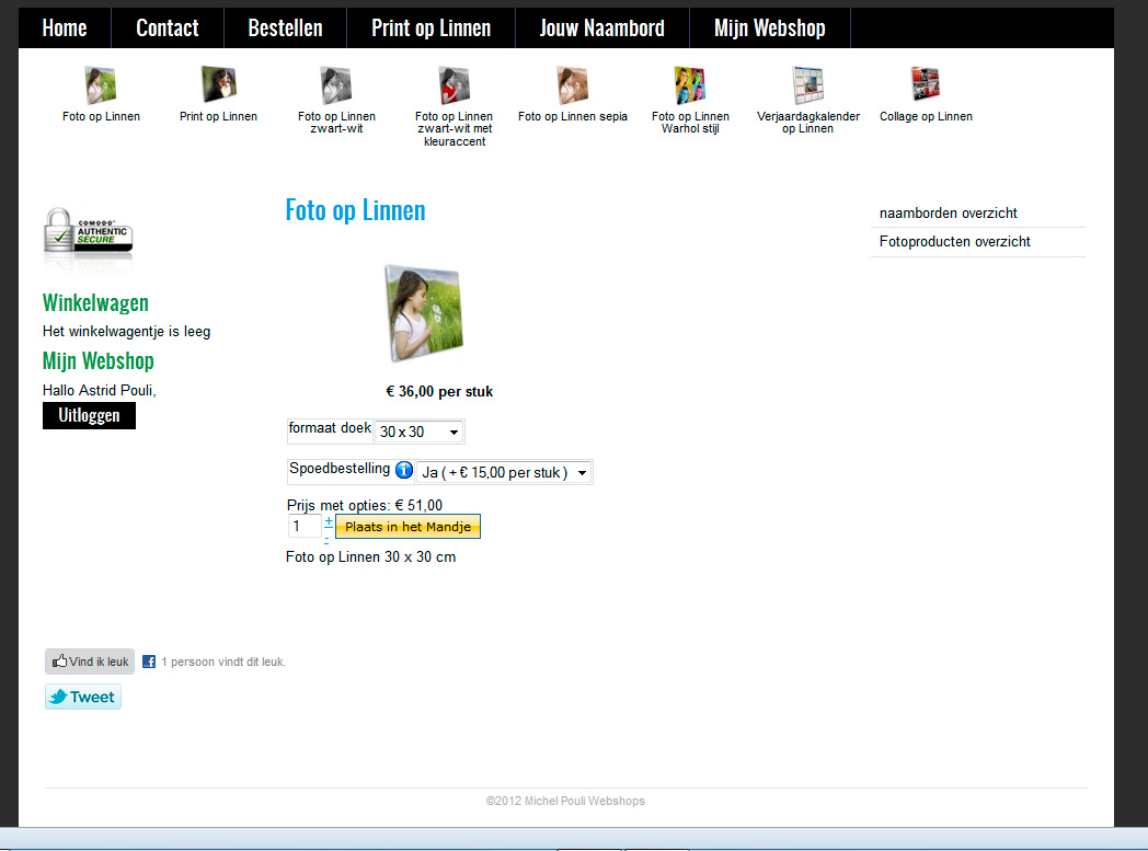

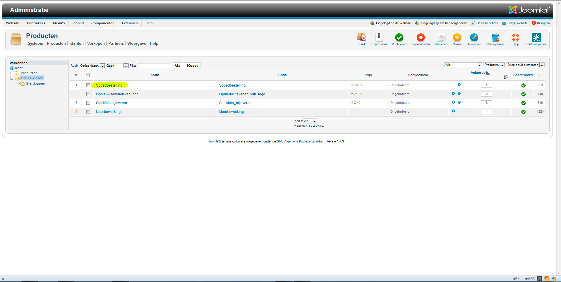

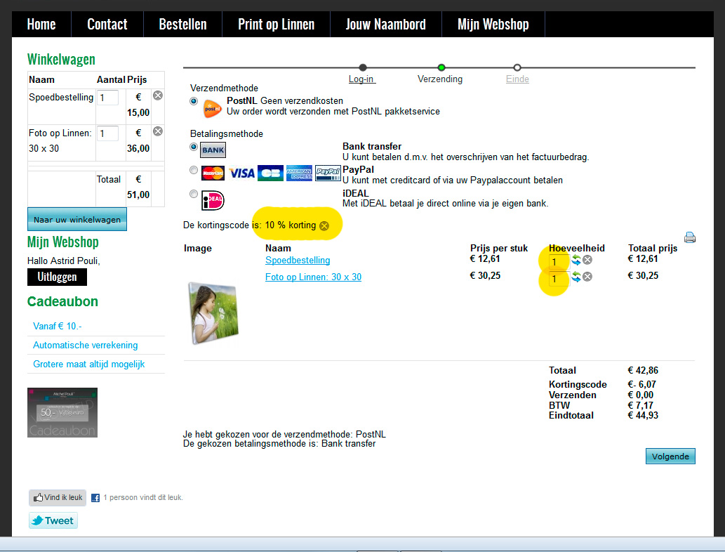

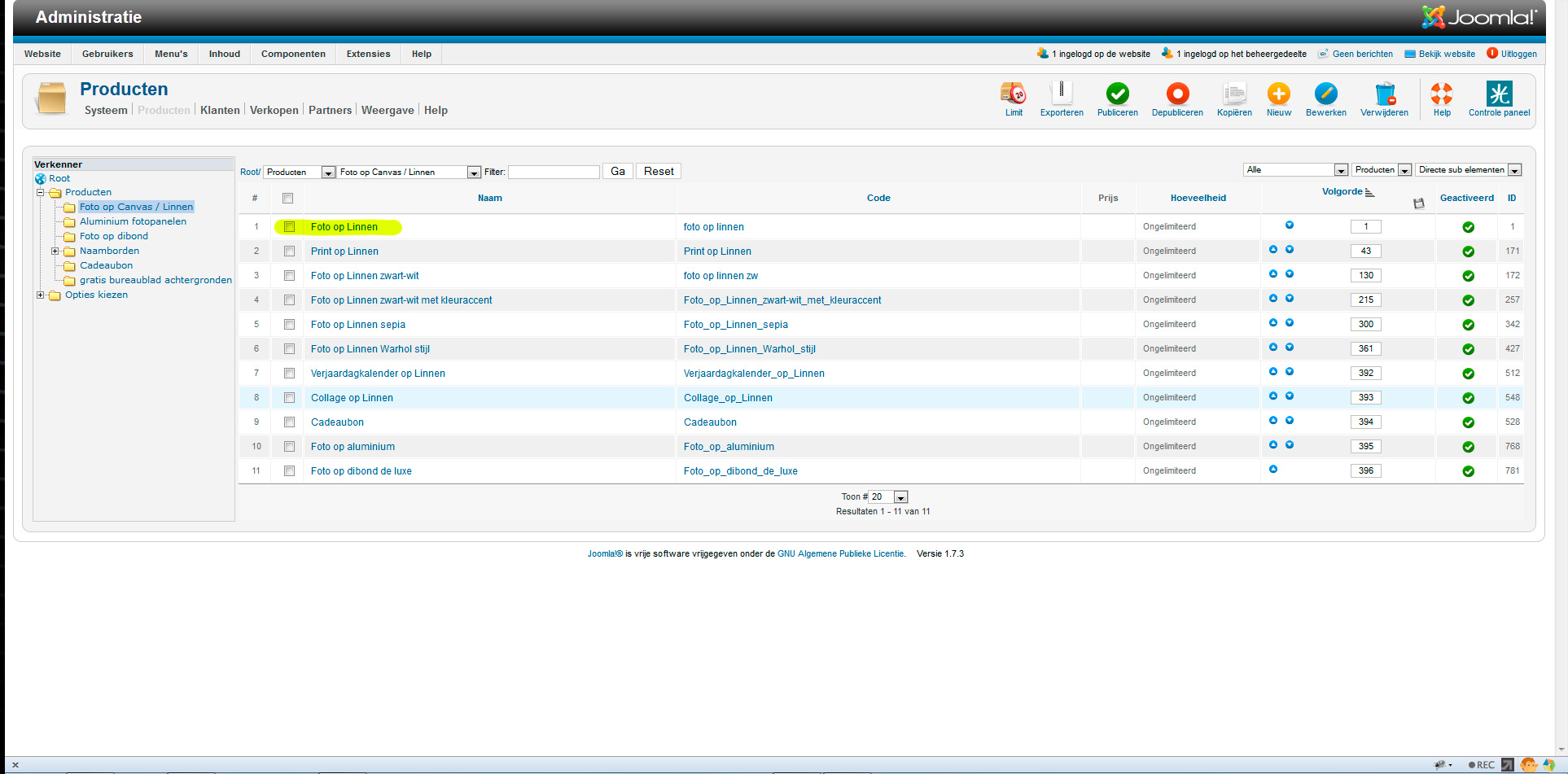

I'm using a discount on a product that has an option (1 day delivery). The discount is set for this particular product and the option is a product within a diferent category. However, the discount is given to 1 product, while the system acts like the option is a second product (2 products give 10% discount). How to avoid this?

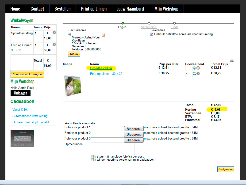

One thing I don't understand with your screenshots is that the total price before discount is 51€.
However, you get a discount which is over 10% of the total price, even including the option price.
So I don't see how that's possible.

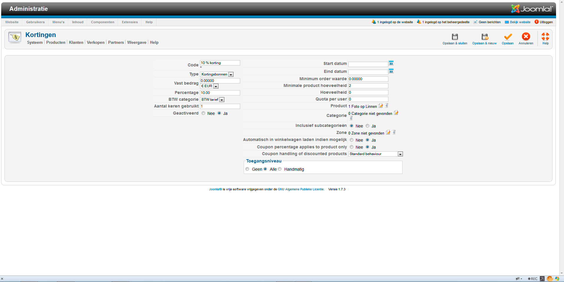

Your settings are indeed fine.
