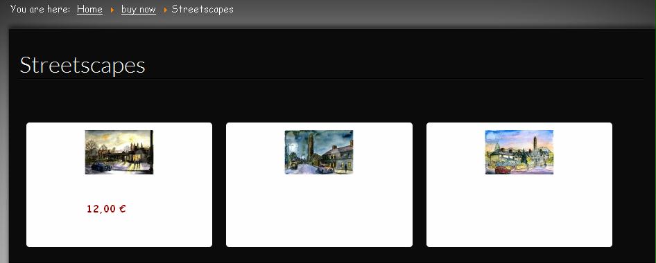

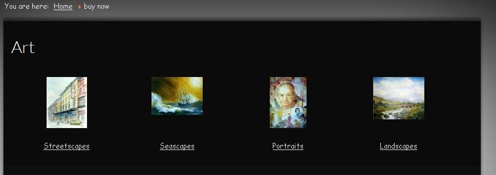

I have a menu item set up 'buy now' and it links to category view of the products
So all the categories are listed there as images and titles
The default view for this needs edited. (In particular my background is black so the white background doesn't look right).
I've edited this view and they now appear exactly as I want them.
But when I then selcect a category. when that page loads it then shows images of the products
how (or where) do I edit that particular view? They are showing with white backgrounds.
Thank you for your time.
Using HikaShop essentials on Joomla 2.6
Last edit: 14 years 7 months ago by beevo. Reason: added screenshots

When you are in the hikashop options of your menu, you will have a link to the hikashop options of the products listing module which is used to display the products. You should click on it.
There you will find similar options to what you had for the categories listing in order to setup the display of your products listing.
The following user(s) said Thank You: beevo
  • Posts: 10
14 years 7 months ago #39371
Thanks, that sorted it.
