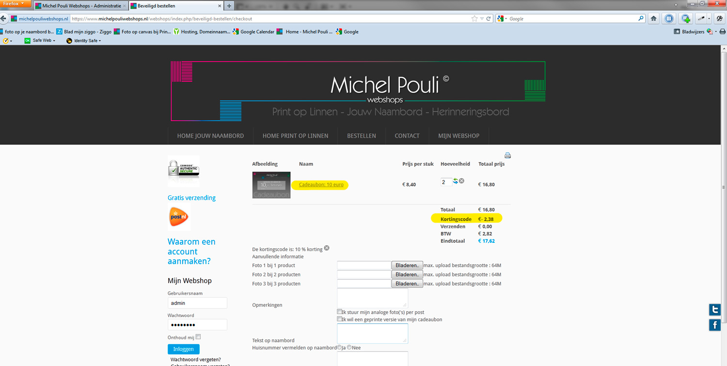

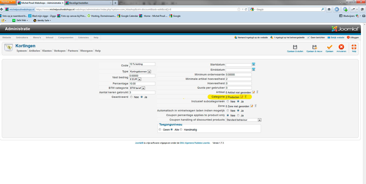

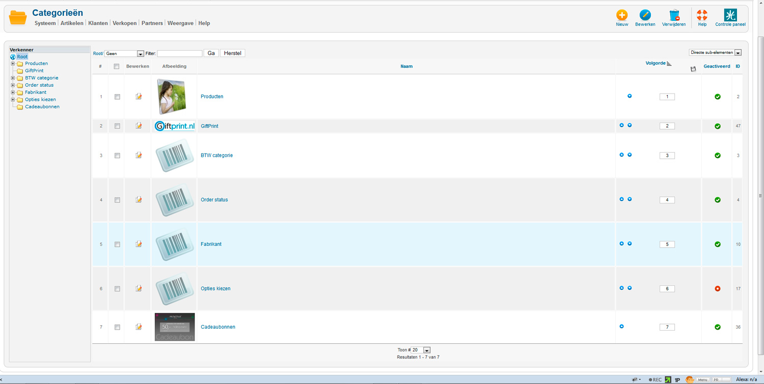

I found another weird behavior of the coupon codes. The 10% discount code is set for a particular category (producten) but it also applies to a completely different category (cadeaubonnen). I really don't understand how this can happen? See the attached screenprints. I also tried with the setting "coupon percentage applies to product only", but then the discount doesn't work at all.

14 years 5 months ago #46867
Indeed the "coupon percentage applies to product only" setting will have to be turn on for what you want to do. Otherwise, the coupon will apply to all the products as long as one product of that category is in the cart.
Also, make sure that you're using the latest version. If that's the case, then it probably comes from a bug that we corrected recently and which will be in next release of HikaShop. In that case please request a patch via our contact form with the edition you're using and that should hopefully help.

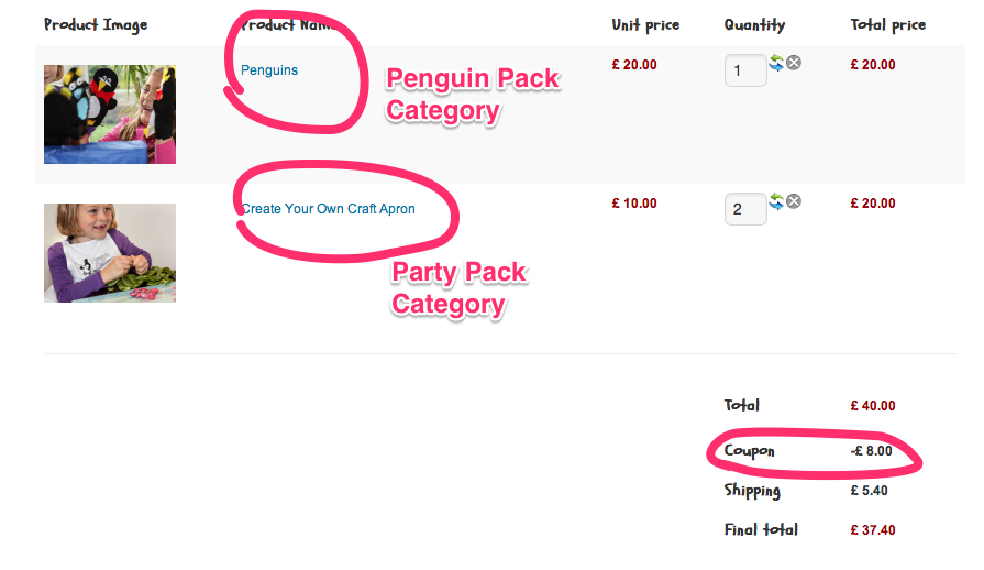

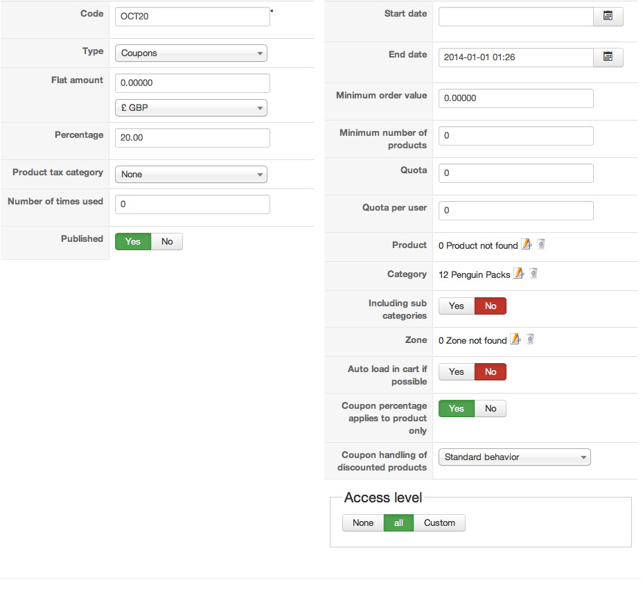

Running HikaShop 2.2.1 on Joomla 3
I am seeing the behaviour described above. I have a coupon which I've restricted to a specific category [Penguin Packs], however the coupon is being applied to all products in the cart whether or not they are a member of the Penguin Packs category.
And I have ensured that the "For product only" switch is ON.

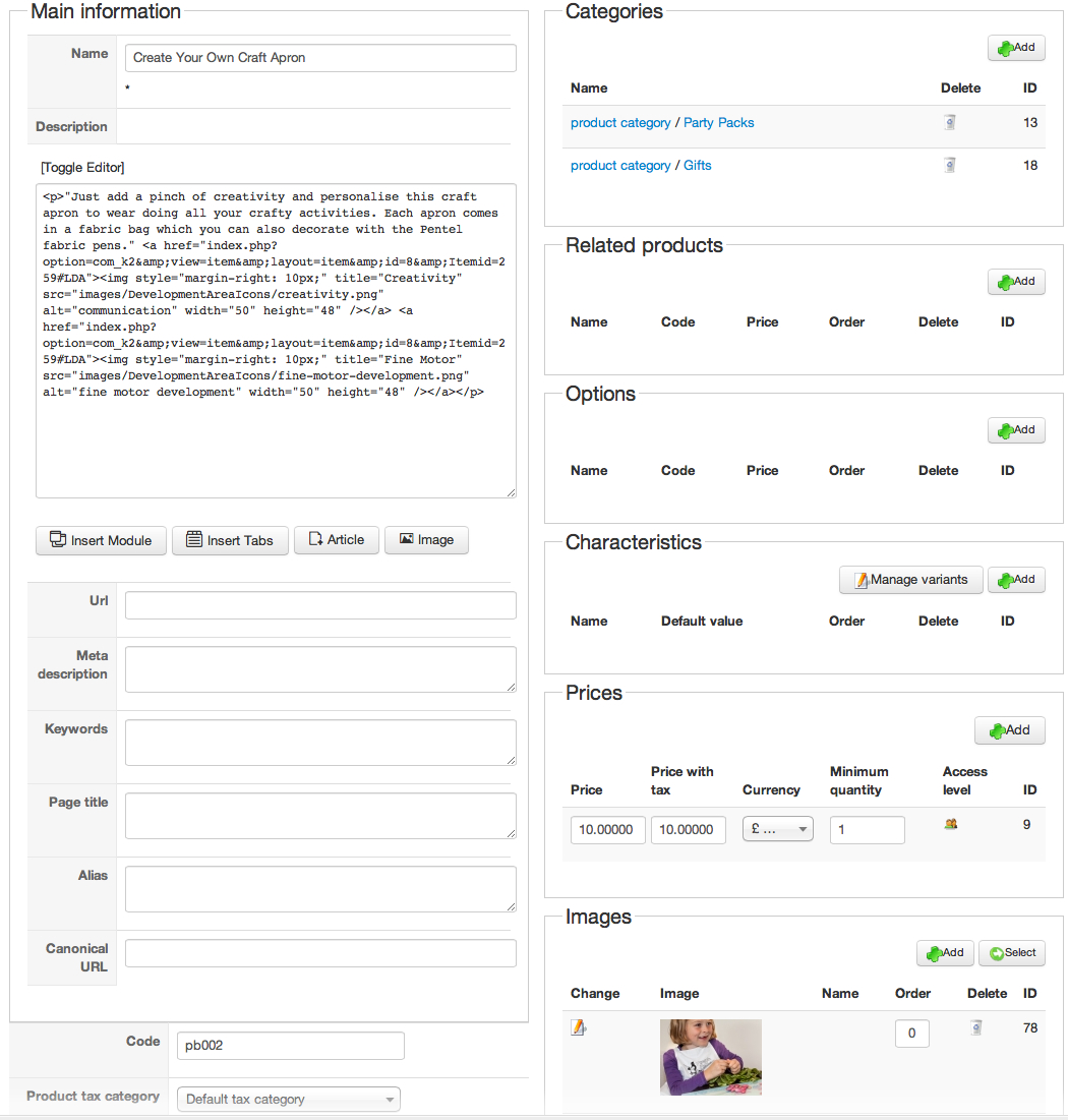

  • Posts: 26386
  • Thank you received: 4078
12 years 11 months ago #125272
Can you provide a screenshot of your discount configuration and of your product (in the backend) which is not in the "penguin pack" category ?

12 years 11 months ago #125288
Hi Jerome, Here they are...

Thanks.
I tried to reproduce your problem in my local website but it works correctly.
I see that we have a patch made during august which fix something around the "coupon applied on product only".
This patch in include in the latest downloadable package so, can you try to re-download HikaShop ?
Maybe you have a 2.2.1 package from before this fix.
