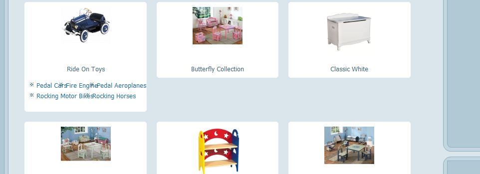

14 years 2 months ago #52399
Apologies....I have attached the screenshot now.
