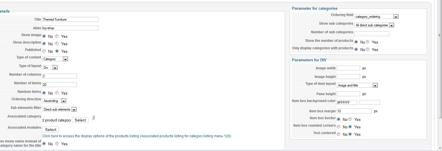

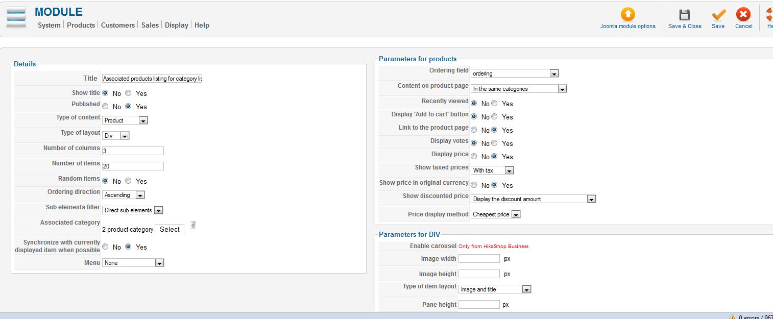

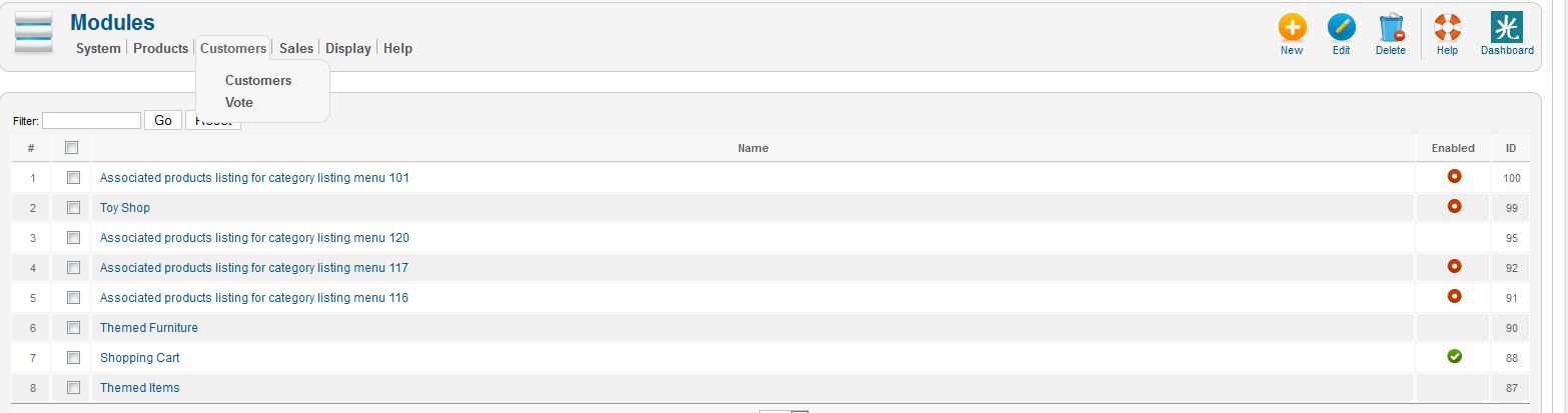

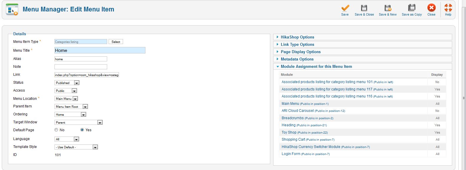

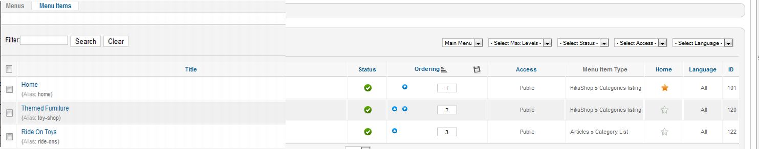

Hi and thanks.... I have made a real mess I think as I tried to put things right and probably made them worse! I've attached screenshots of my modules, menus and options.... site is www.thetoyattic.co.uk

  • Posts: 86181
14 years 3 months ago #51554
Could you give screenshots of your modules and menus' hikashop options ? They can be accessed via the menus Display>Content menus/modules.

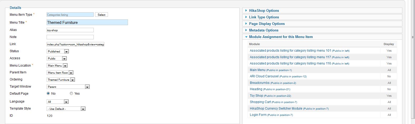

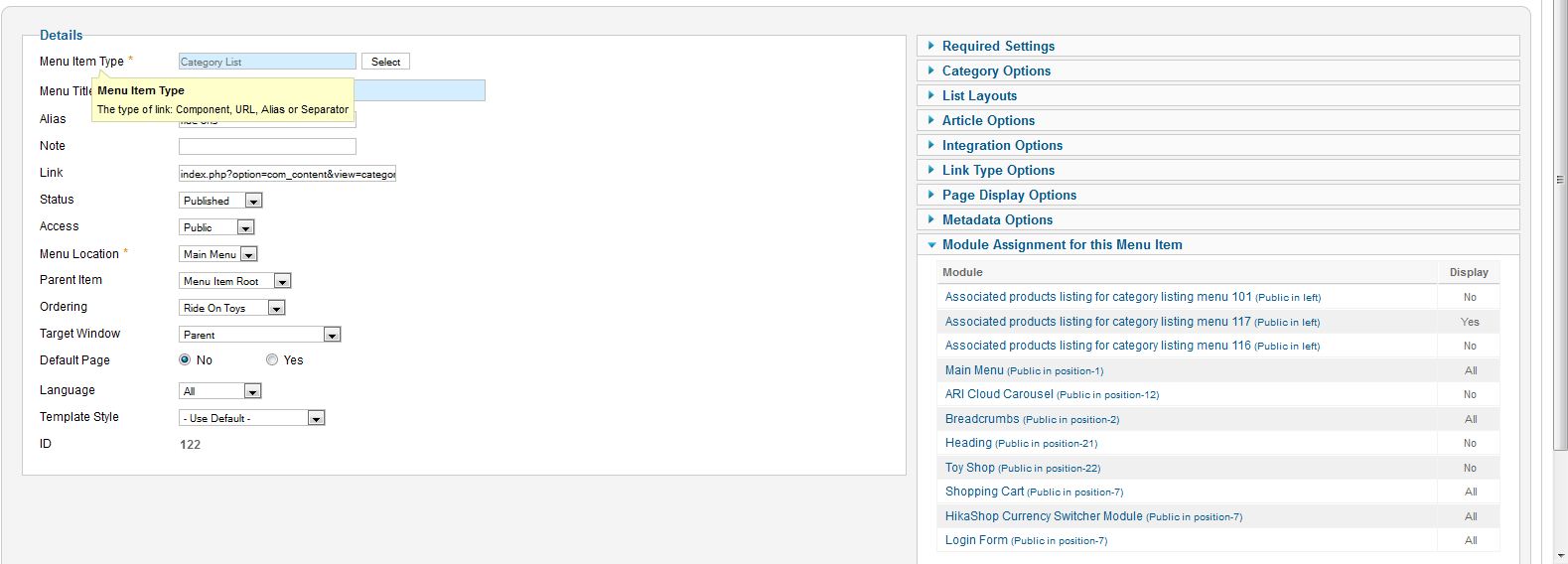

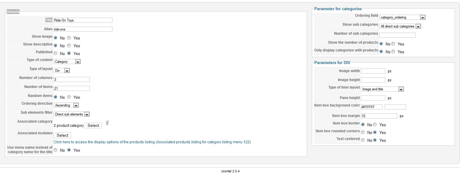

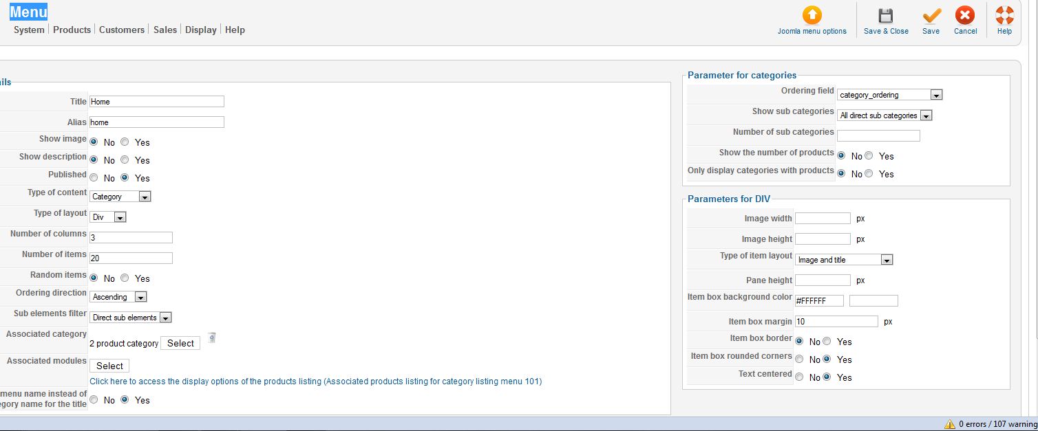

  • Posts: 76
14 years 3 months ago #51556
Sorry - have attached my hikashop options pages now...

  • Posts: 86181
14 years 3 months ago #51584
Thanks, we're moving forward.
Could you also give screenshots of your modules' hikashop options ? They can be accessed via the link you see in your menus' hikashop options in the "associated modules" option.

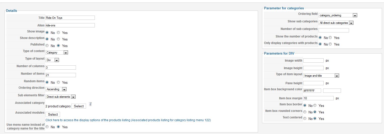

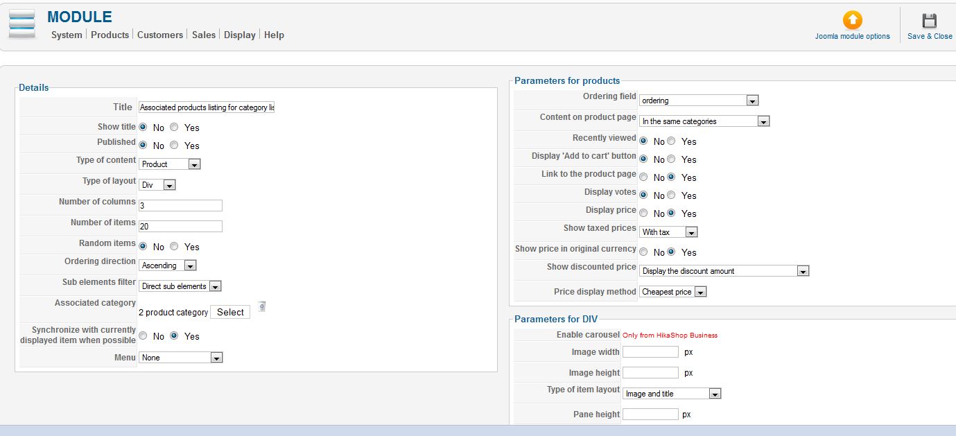

  • Posts: 76
14 years 3 months ago #51600
I have attached the screenshots you asked for.

  • Posts: 86181
14 years 3 months ago #51703
So if you want to display different categories on different menus, you need to select the parent category corresponding to one group of categories in the "associated category" option of each menu.
That means that you need to have a multi levels category tree, instead of a one level category tree like you did. Otherwise, you can't have one main category parent of each group of categories.

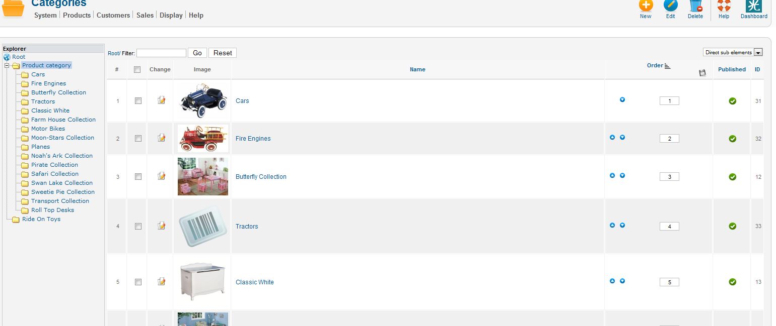

  • Posts: 86181
14 years 3 months ago #52121
Go in the menu Products->Categories in HikaShop. There, you can manage categories.

  • Posts: 76
14 years 3 months ago #52310
Thanks very much for your help. I have worked out how to make the category tree now...... on my main category page though I get links to the sub categories that just run into each other - with no spaces between or formatting. Is there a way to format these links ... or to stop them showing at all so that they are only seen when the main category is clicked on?
