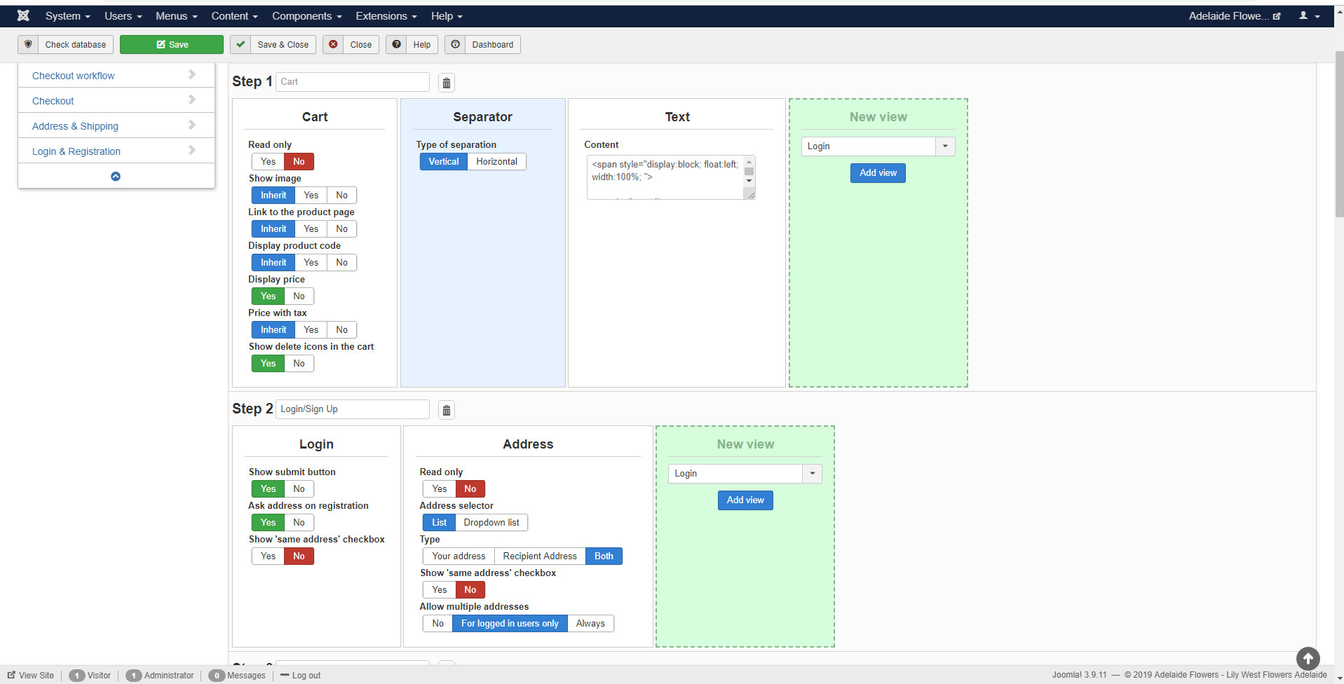

7 years 3 months ago #310242 by Mohamed Thelji
Can you show us some screenshots of how you configured your checkout workflow via "Hikashop->System->Configuration->Checkout" ? So that we can have more information to understand your issue ? Thank you.

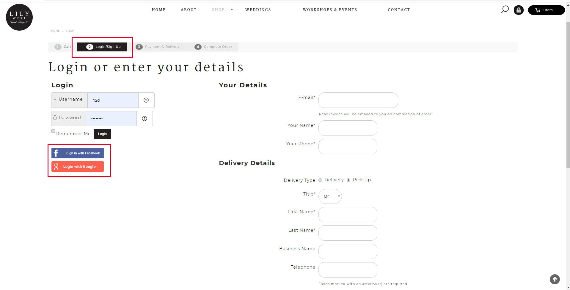

This is where the facebook login module is loaded on Step 2:

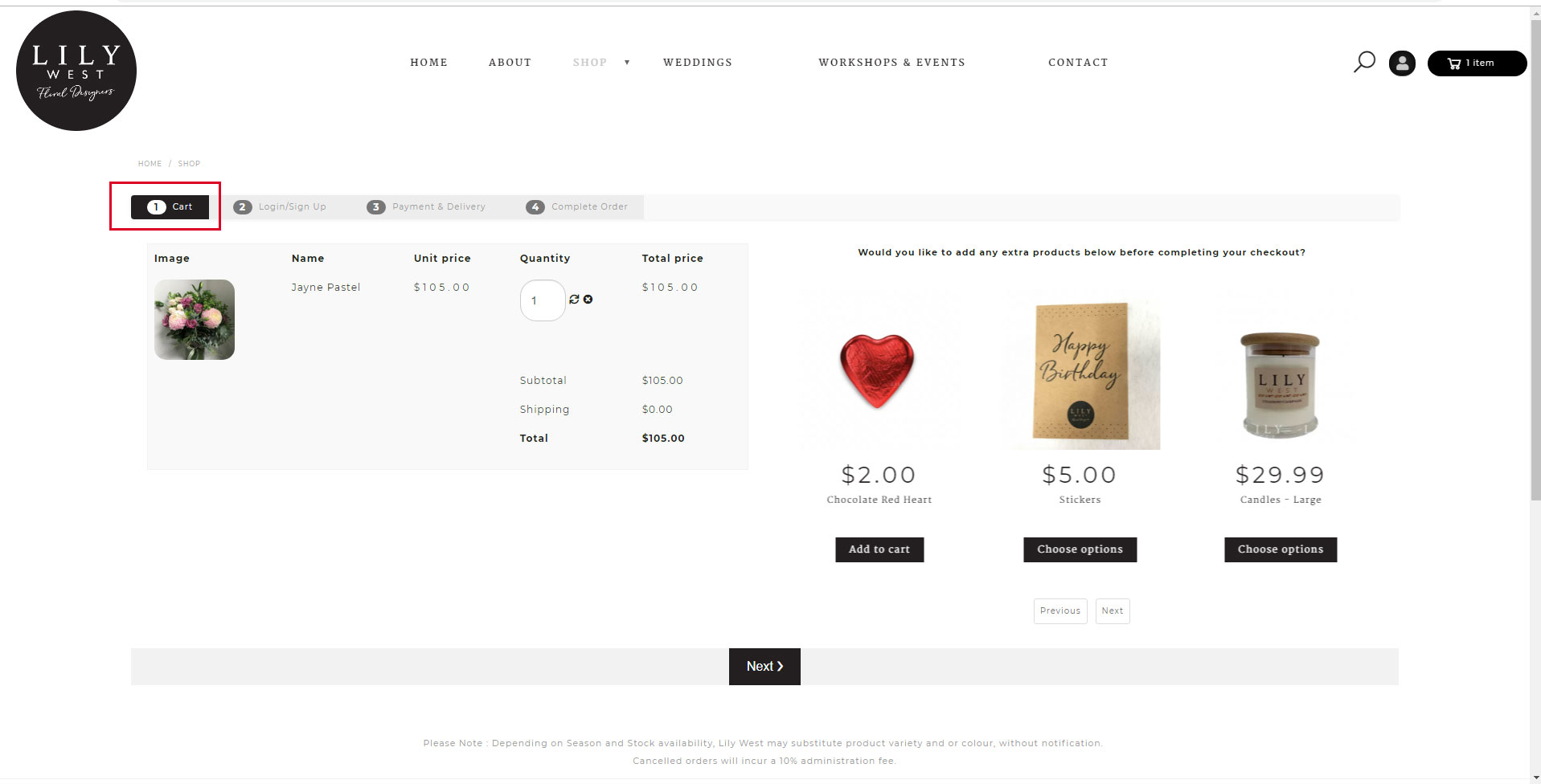

Once a user has logged in they are kicked back to Step 1:

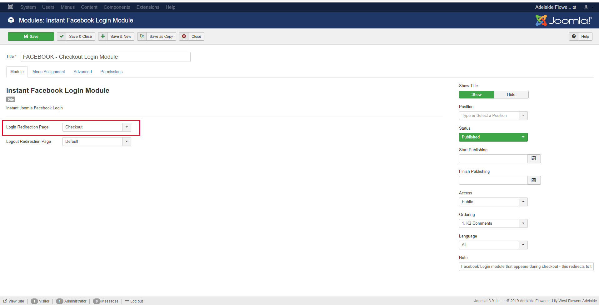

I have set the login module to redirect to the Menu item "Checkout" which links to the hikashop checkout menu - alternatively setting this to "Default" redirects to the main shop page once a user has logged in:
This is a breakdown of the checkout workflow:

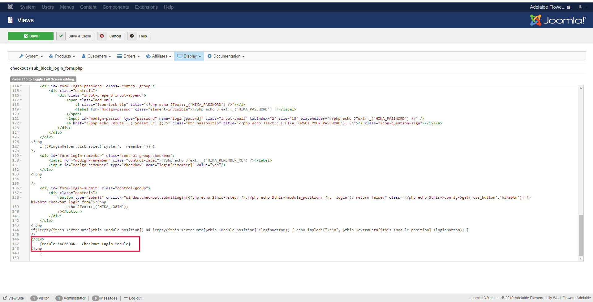

This is how I call the Facebook Login module into the checkout - using "modules anywhere" to add the module to "checkout/sub_block_loginn_form.php":

The issue is with the "login redirection page" you selected in the plugin. This "checkout" you selected is I suppose a menu item of the type HikaShop checkout. In that case, it means that it's redirecting to the main page of the checkout, and thus the first one.
What you should do is create a menu item of the type "external URL" in a hidden menu via the Joomla menu manager. And in it, enter the URL of the second step of your checkout.
Then, select that menu item in the "login redirection page" setting of the plugin so that it can redirect to the second step after the login.
