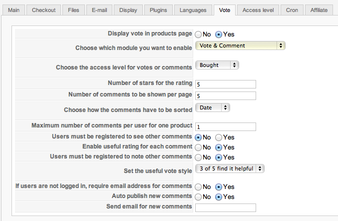

Could you do a screenshot of the "vote" tab of the configuration ? Maybe there is something else...
