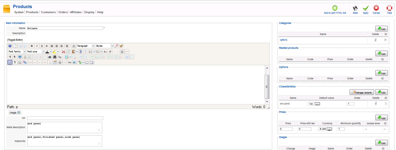

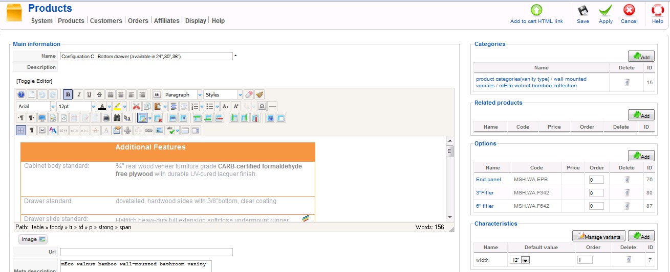

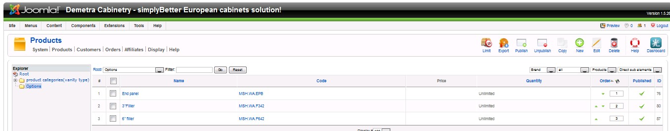

Can you do a screenshot of your main product, its options and its variants edition pages so that we can see how you configured all of that ?
There must be a problem with some of their quantities.

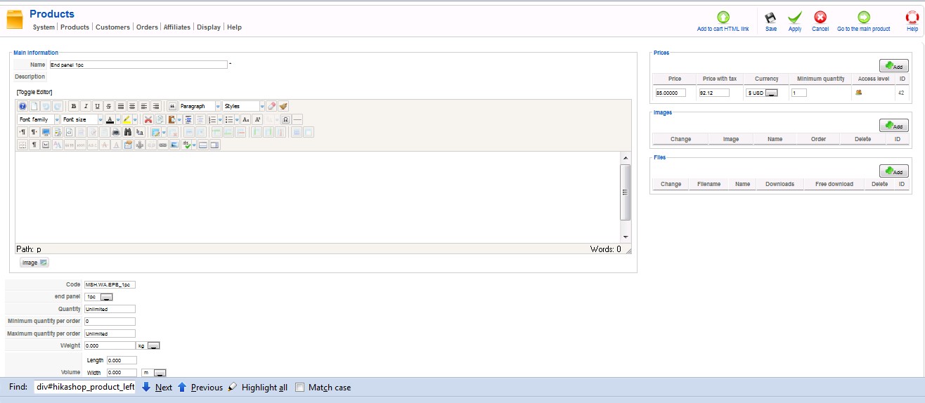

  • Posts: 76
14 years 2 months ago #56017
See attached.

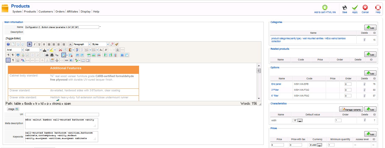

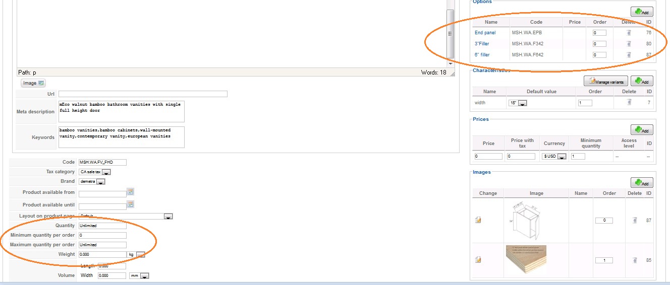

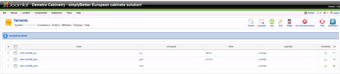

  • Posts: 86181
14 years 2 months ago #56051
It would help if you could include the quantity/min and max quantity fields in your screenshots.
And maybe explain which one is for which part of your products.

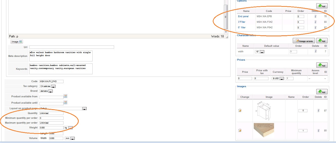

  • Posts: 76
14 years 2 months ago #56191
See attached. I didn't set any min.or max quantity for the product items and its variants, neither did the option items.
  • Posts: 86181
14 years 2 months ago #56248
I tried to access again the product page to look more closely at the problem but the link is not working anymore.
Could you provide a working link to that product page ? Maybe a back end access would help in order to understand the problem and easily look at your configuration...
