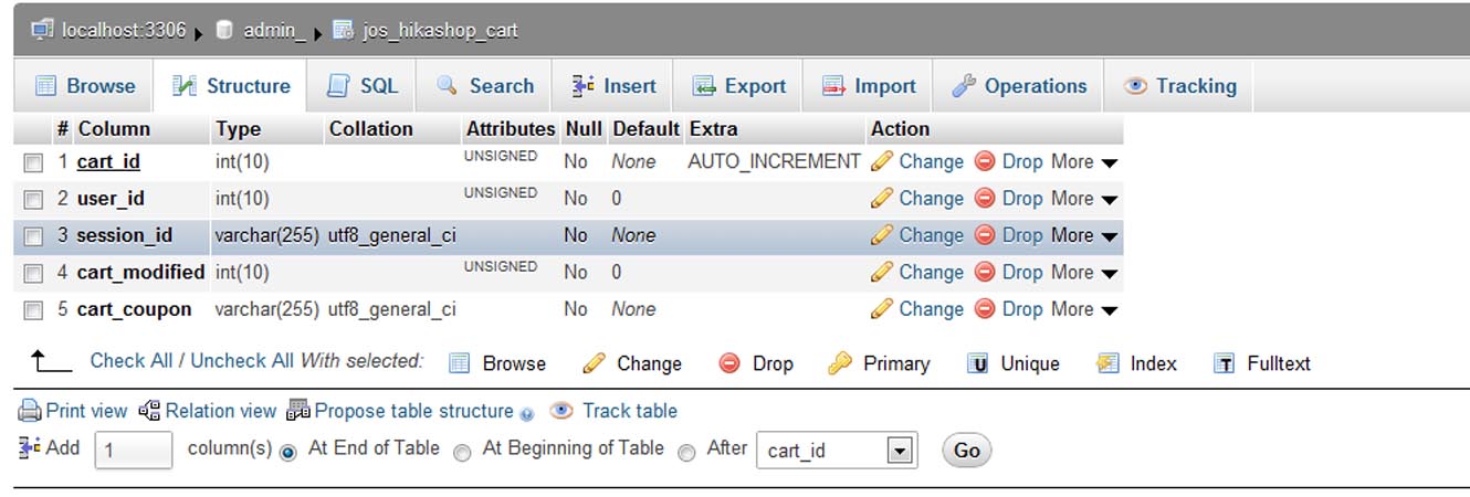

  • Posts: 53
12 years 11 months ago #57794
ok have checked the table and all seems to be ok. They all have auto_increment laid out like the attacthment. Should they all have auto_increment or should it just be the main heading?
any ideas where we go from here? change hosting provider maybe? i am literally stuck.....
