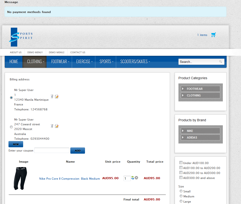

I followed the instructions and when the address is overseas, the user doesn't get the 'Payment Method' option, therefore, cannot proceed with the checkout. On the top of the website, a message appears as 'No payment methods found'.
Functionally this is fine, but is there way that I can do this more 'user friendlier' way. Such as a message on the page where the items are displayed. I have attached a screenshot with how the message is displayed by default.

You can for example change the "no payments methods found" translation word by editing the English (United Kingdom) file in "Hikashop->System->Configuration->Language" and changing the line :
NO_PAYMENT_METHODS_FOUND="No payment methods found"
by :
NO_PAYMENT_METHODS_FOUND="your translation"
Hope this will help you.
