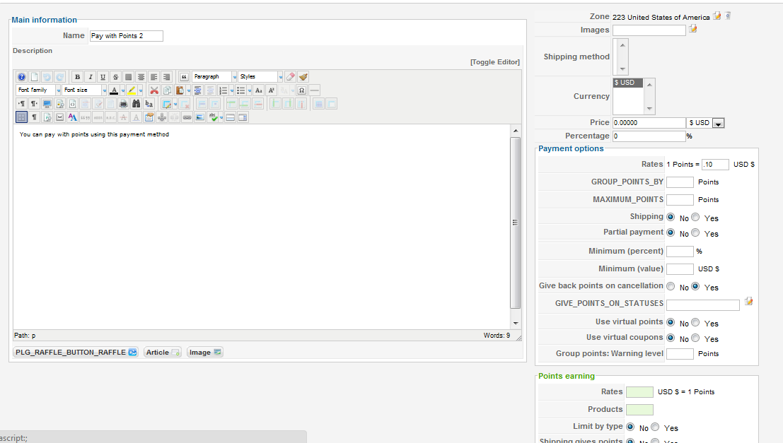

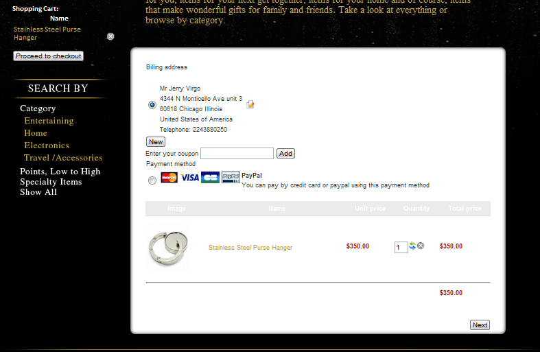

Hi, I have the latest version of alphauserpoints 1.7.4 on joomla 2.5.4 with hikashop 1.5.8.
I attached a screenshot of the alphauserpoints settings as well as how the shopping cart looks on checkout. I want to set it up so that users can only pay with alphauserpoints, however it doesn't display that payment option. I have a test user setup which already has points to purchase items with. I setup the paypal payment plugin for testing purposes (if disabled, it says no payment option available).
Do I have something setup improperly?

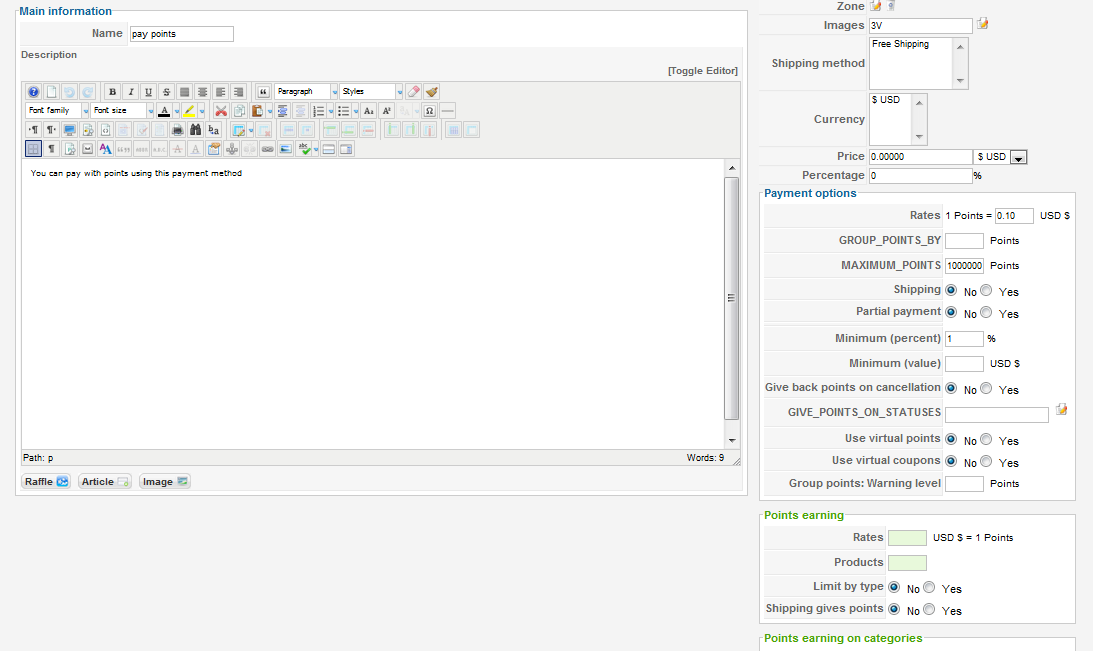

  • Posts: 18
14 years 1 month ago #59329
Here it is sorry, I attached the wrong file

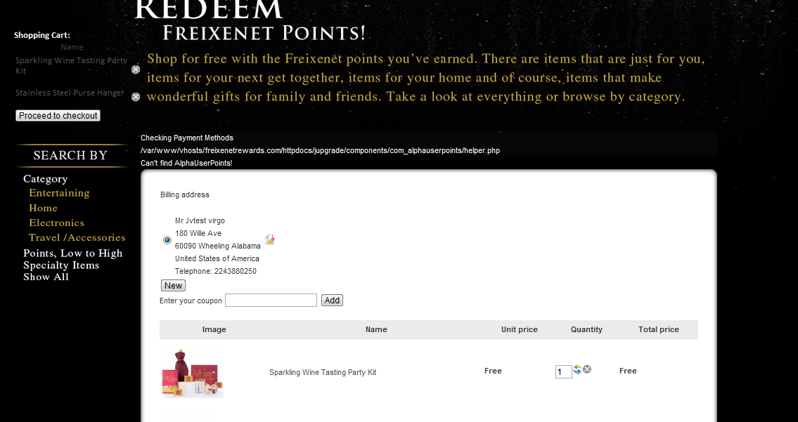

  • Posts: 18
14 years 1 month ago #59352
My developer put in some echos into the hikashop payment plugin into alphauserpoints in several areas to see where it was breaking. It's saying it can't find the file while checking if it exists, while all other alphauserpoints functionality still works in other components, just not hikashop. Here's a screenshot of the echo.

Please remove the zone restriction and the currency restriction from the AlphaUserPoints plugin. Then, make sure that you also set a big maximum number of points (MAXIMUM_POINTS option).
Then, make sure that your user has enough points (more than 10 times the total amount in dollars since 1 points = $0.1) or turn on the "partial payments" option of the AlphaUserPoints plugin.
Also please note that payment methods never display if the order total is 0. I see that you have a free product in your last screenshot, so in that case, it's normal that payment methods don't display.

14 years 1 month ago #59508
Thanks for the help. I've adjusted the settings as shown in the attached image. However, it's still having the same problem. I tried it with an item that cost $1 using those settings, and it still displays no payment method.
