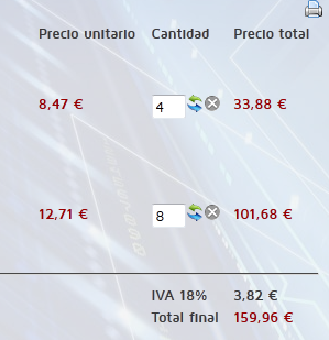

14 years 1 month ago #59184
Hi. I wanted to calculate my invoices tax from the sum of the prices without tax of all of the order products, so I installed the custom quantity tax plugin that was made for that purpose. I activate it, went to Configuration->Display and set not to show detailed taxes, but taxes are not showing properly. The checkout is only showing the tax of one unit by line, so is the same tax if I have 1 unit that if I have 10 units. I attach image.
Please help. Thanks.

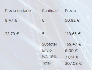

  • Posts: 107
14 years 1 month ago #59205
Well, definitively this is not a good solution for me. This plugin does not separate the VAT taxes, I sell in my shop products with different VAT taxes and the invoices are completely unreadables. I must guess which are the products that have VAT and which VAT tax they have. I sell to companies and they aren't going to accept this type of invoices.
I attach image of a bought who has an incorrect VAT cuote for only a few products. VAT tax is 18% for all these products and for shipping costs too, the order/invoice calculates a VAT cuote of 31.61€ and the real cuote is 31.58€
I've tested to make the calculations by several ways and VAT tax is always the same (31.58€)
It's only a 0.03 cents of difference but it's enough for me to try to find a solution.
I'm waiting for only this problem with quantities to publish my shop.
Please help. :S

  • Posts: 107
14 years 1 month ago #59308
Thanks for answering Nicolas.
I have enough with one line for each tax type at the end of the invoice, exactly as it is, but with the image I have attached to you in the above post, I can't find any calculation to get the tax that appears in the invoice, summing each price or rounding it from the whole total.
Please, Could you tell me how can I do the calculations to get that quantity?
Thanks.

  • Posts: 107
14 years 1 month ago #60749
Hi, I've just installed the new release 1.5.9 and I have the same problem as in 1.5.8, I have differences in tax quantities, making the calculations by product or by the total. In the image I posted above there's the difference in only a few products.
I've tested making the calculations by several ways and VAT tax is always the same (31.58€)
Please help.
PD: Also in 'Add to Cart' button I have to clik twice to get it working.
Last edit: 14 years 1 month ago by lanzanet.

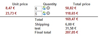

  • Posts: 107
14 years 1 month ago #60827
Hi Nicolas.
I've tested the tax calculation override plugin and I can't use it because I can have products with different taxes in the same order/invoice and the plugin doesn't separate the taxes quantities, so I made a test too with some products (without the plugin) and I think there could be a bug in normal calculations without using that plugin. I attach the image again and I would like if you could tell me how hikashop arrives to that result on tax quantity.
I've made the tax calculations BY THE TOTAL, also by product price (then calculate the tax BY UNIT and then multiplying by units bought), and also by units bought multiplying by unit price (and then calculate the tax, BY LINE). I don't know if there's someway more to do the calculations, but in all three ways I get a tax quantity of 31.58 EUR (not 31.61 EUR).
Please, if I'm in a mistake, Can you tell me the calculation procedure on how hikashop gets a tax of 31.61 EUR?
Thanks.
Last edit: 14 years 4 weeks ago by lanzanet.

  • Posts: 2334
  • Thank you received: 403
14 years 3 weeks ago #61373
Hello Lanzanet,
I just tried to reproduce the bug you're experiencing and I get the right result as you can see in the attached screenshot.
I activated the tax override plugin in order to get this result and you should be able tu use it as weel since it can handle different taxes in the last version.
Just be sure sure you have the last Hikashop version and you should get what you want.
Last edit: 14 years 3 weeks ago by Eliot.
