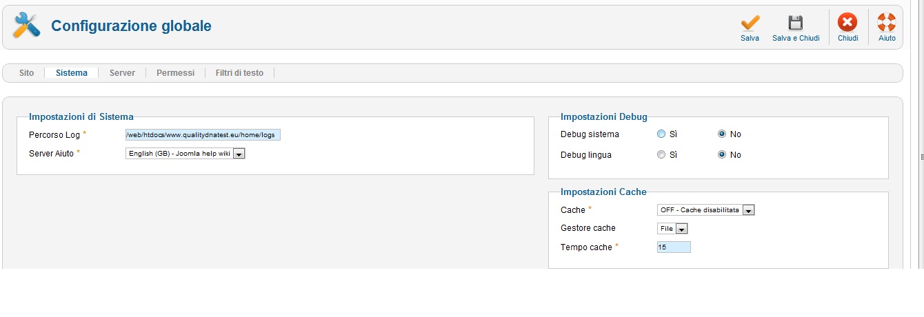

All caching of Joomla should be disabled.
There is also the joomla cache plugin and sometimes a caching option in your template.

here is what I get. I checked the settings for my cache and is disabled.

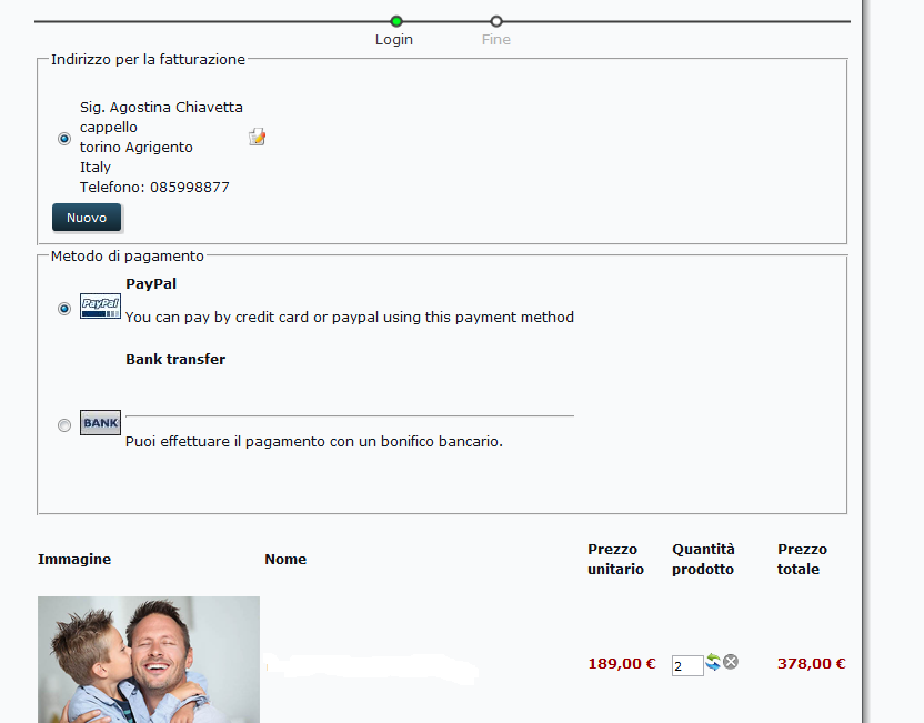

1) I continue to insert the last registered user
2) I sum all the products, when my number is 1
Should I get an external pluing to manage the cache maybe. I know recommend something?

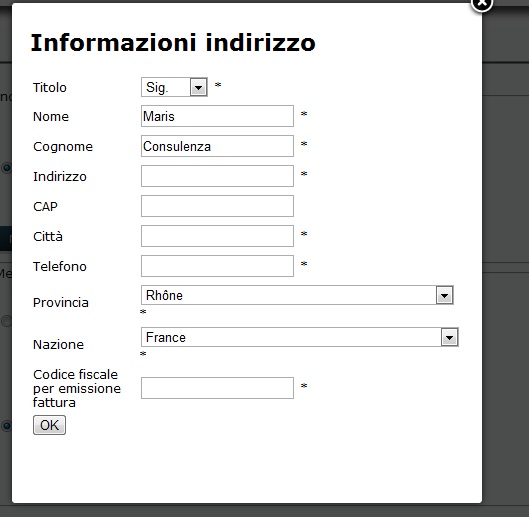

Why every time I do I register my data always appear:
Surname: Consulting
Those fields should be blank.

These appear because you are logged on your website.
HikaShop automatically set your joomla name as the name for the address in order to make it easy for you to fill your address.
Normally, your users won't be logged in so they won't see that.
Your website cannot be accessed without being logged in since it is in maintenance. So you actually cannot test a purchase in real conditions.
You should deactivate the maintenance on your website and use another browser to access your website and you will see that it works properly.
