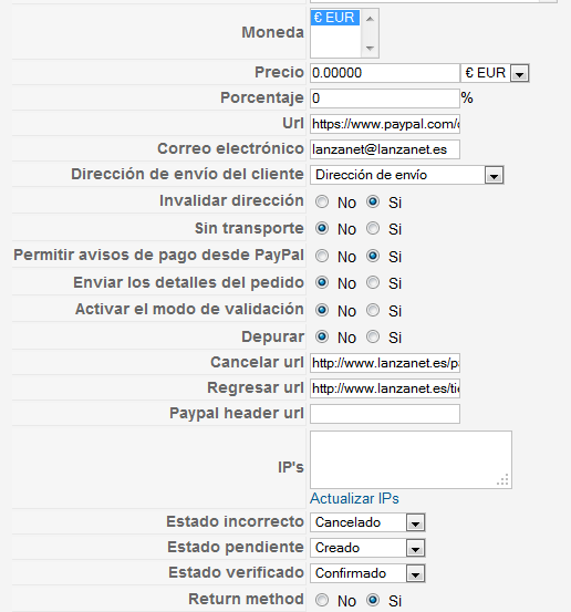

I just tried with both this option activate or not and it always get the same result (11.99).
Could you make me a screenshot of your paypal configuration?
  • Posts: 107
13 years 11 months ago #63728
Here it is. Thanks.

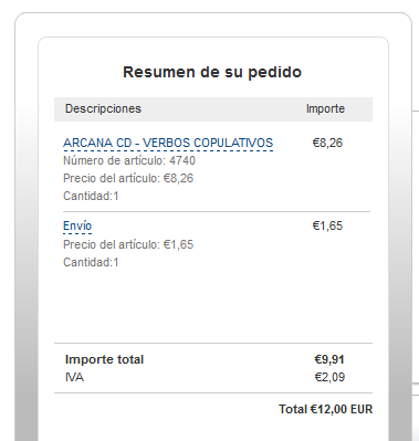

  • Posts: 107
13 years 11 months ago #63729
Hi, I attach too the image of paypal details. Tax is 2,09 instead of 2,08, and then the total is 12,00 instead of 11,99
Thanks.

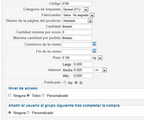

  • Posts: 107
13 years 11 months ago #63735
Product edit view attached. Paypal result with option activated (sending details) is attached in the above post. With option deactivated it shows only the total (11,99) and quantity: 1, Do you want I attach it to you?
It seems an error calc in tax, all quantities are the same but tax (2,09 instead of 2,08), and of course it affects the total amount.
Thanks.

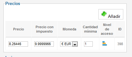

  • Posts: 107
13 years 11 months ago #63746
Sorry. Price fields attached.
  • Posts: 2334
  • Thank you received: 403
13 years 11 months ago #63757
That's the problem.
Why do you have so much digit after the coma? Is it normal?
If it's not, just put 8.26 as a no taxed price and everything should work fine.
The new tax calculation isn't rounding anymore so you have exact prices when you pay (it's useful for big quantities)

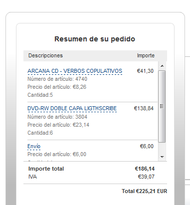

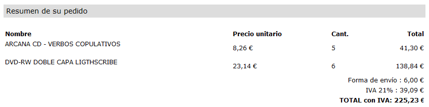

  • Posts: 107
13 years 11 months ago #63776
I've tested it and now it works with the data I gave to you, but I've made other test with 2 products and it doesn't work. Both products have only two decimals in price without tax, and now the difference between paypal and order are 0,02. I attach images.
All quantities are the same except the tax, and the correct tax is calculated in hikashop order and not in paypal invoice.
Last edit: 13 years 11 months ago by lanzanet.
  • Posts: 2334
13 years 11 months ago #63779
The only solution there is to disable the details option.
Let me explain you the issue.
The new version of Hikashop is now avoiding every round on price in order to calculate the exact price. This feature is really useful for a lot of people who want exact amount on checkout and avoid every round errors. However, if the total displayed in Hikashop checkout is perfect, when you activate the "send details" option, paypal is making round with the given prices. Thus, the calculated total price is different since paypal round the product price and so on.
That's why the only solution there is to disable this option.
I hope I've been clear, do not hesistate if you have any other issues :).
