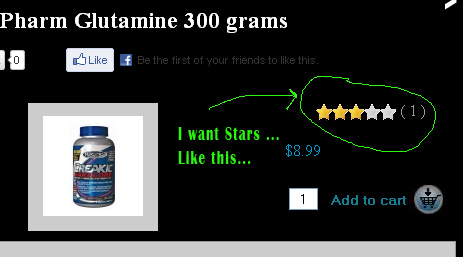

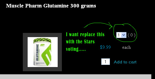

Hello guyz..
I would like to change the Voting view from drop box to Stars, but can't find out where.
I have upgraded to 1.60 version. When I had 1.58 version, Stars were shown.
Thanks in advance!

  • Posts: 28
13 years 11 months ago #63878
Thanks Nicolas
Here is website: www.tsnsportsnutrition.com
-hikashop is located in the "TSN Store menu"
I was working with 1.58 hikashop and the "voting" worked, then I installed 1.60 hikashop when I move cart to clients website, and "voting Did Not Work."
Thanks for looking into this. If I must, I will reinstall 1.58 because i really want the voting to work.
