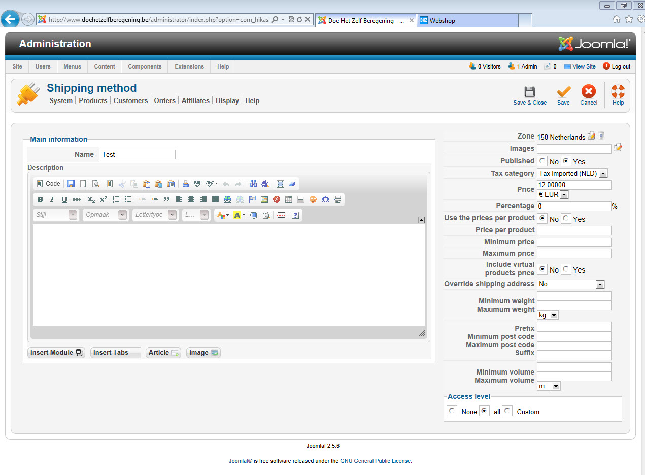

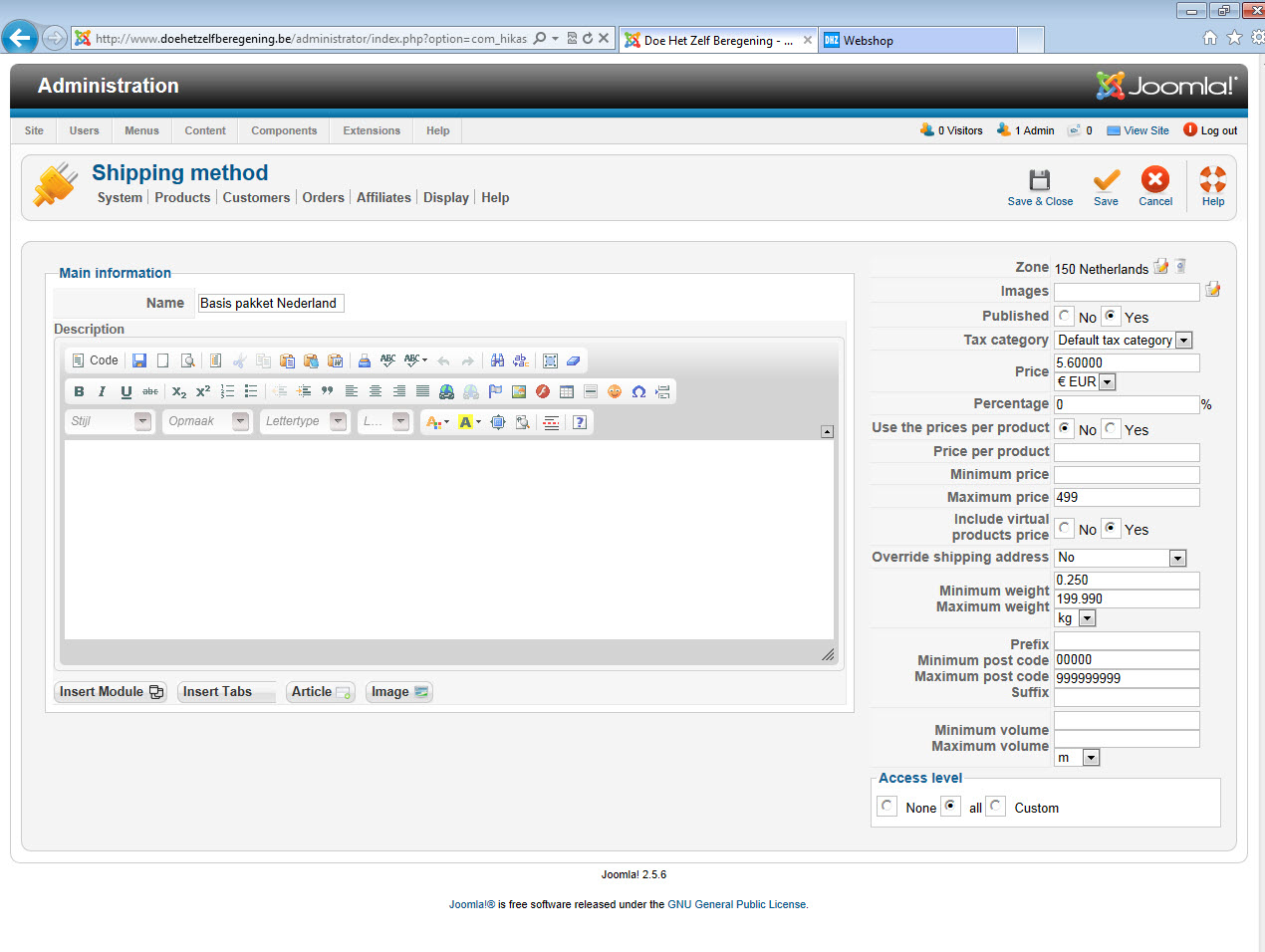

Please do a screenshot of the options of your shipping method so that we can see how you configured it.
  • Posts: 5
13 years 11 months ago #64589
Hello Nicolas,
Please see the screenshots. The first one is of a test setting with the only selection being the Dutch country and the other should be the basic parcel within the Netherlands. I have many more configured, but they all have the same issue. The first one I created to test without any parameters set an have a test.

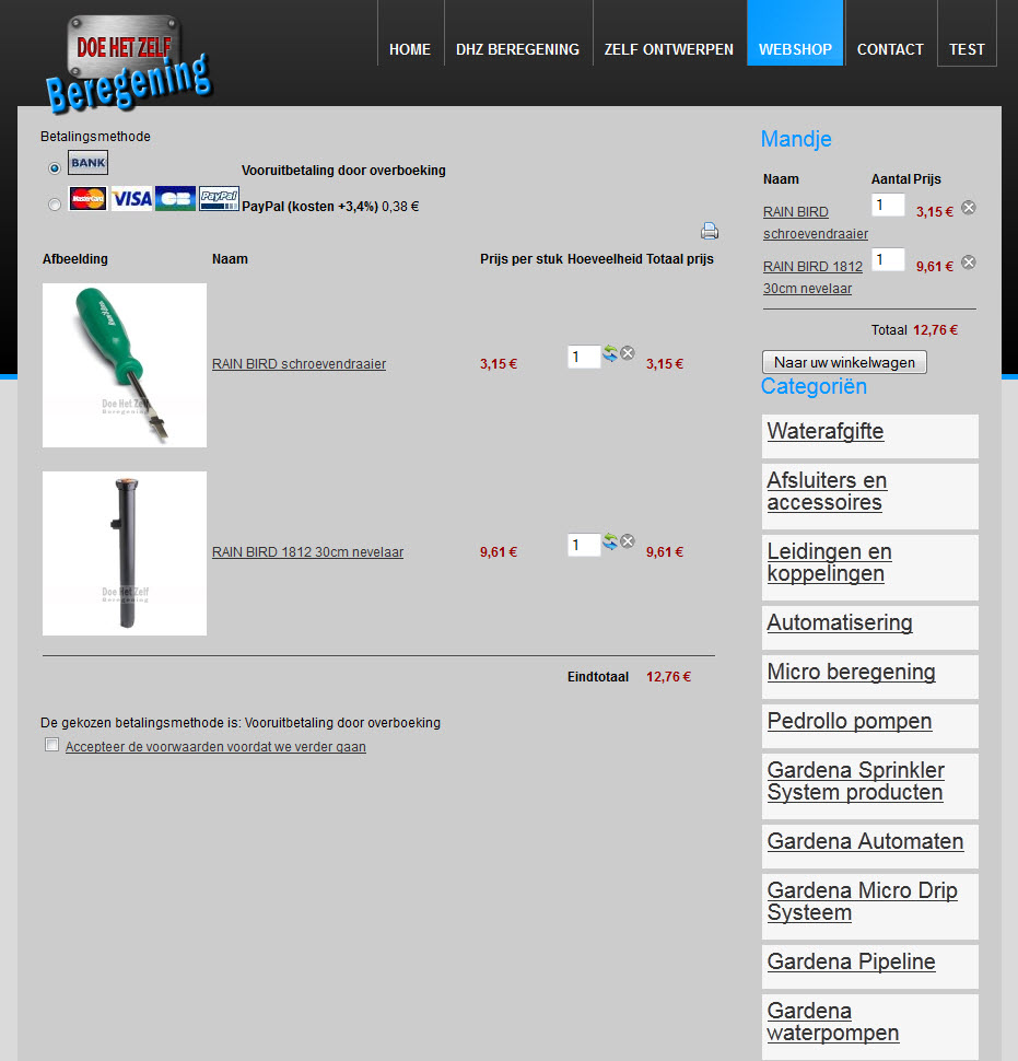

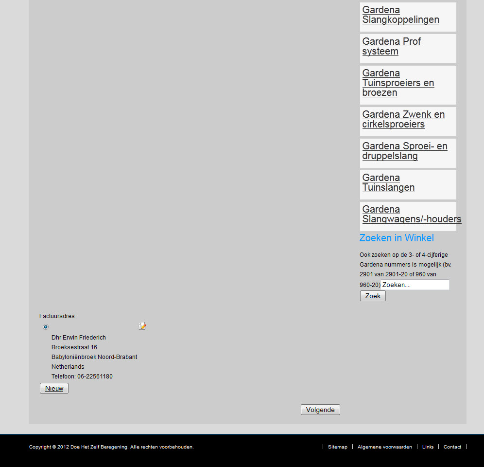

If all that is correct but that it's still not working, please do a screenshot of your checkout page.
  • Posts: 5
13 years 11 months ago #64630
Yes, the address I used is in The Netherlands. I'm building everything for delivery in Belgium and The Netherlands only.
I have also published the manual shipping method.
I attached two screenshots of the checkout page as it is rather large. Still some work to be done in design and layout.....
Erwin
  • Posts: 86079
  • Thank you received: 14186
13 years 11 months ago #64744
I only see the billing address edition and not the shipping address edition interface.
That means that the system detected that your products didn't need any shipping.
This usually happens because the products in the cart don't have a weight and that the option "force shipping regardless of weight" is turned off in the configuration.
If you turn it on, that should solve the problem.

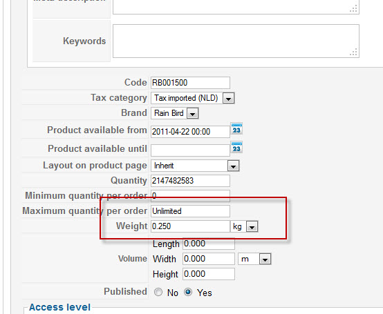

  • Posts: 5
13 years 11 months ago #64781
The weight is defenitely filled in. Please see screenshot of an example.
Even after forcing shipping it says that no shipping is availlable.
How can we resolve this?
