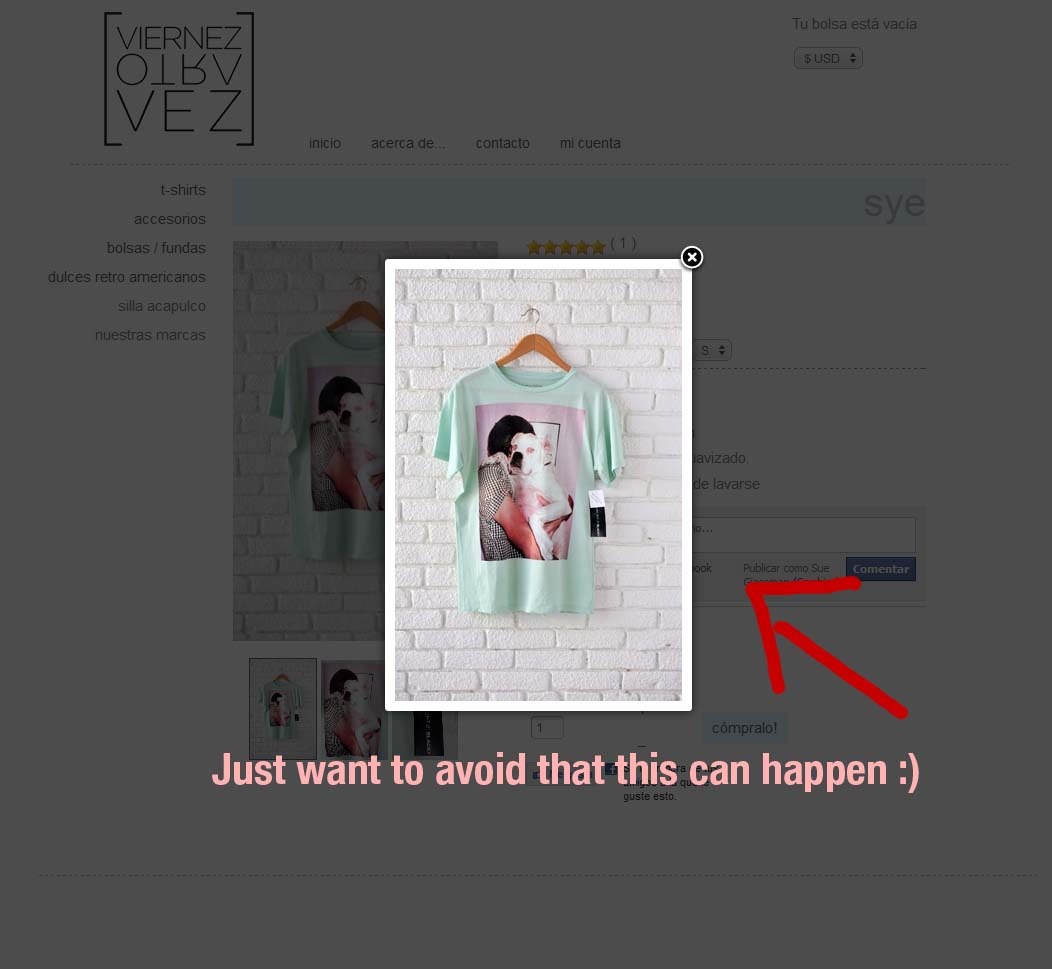

Im so sorry of my lack of knowledge, i will try to explain myself the best i can.
I have a crazy client that doesnt like that images in the product page can be linked, he only likes the hover and the way they display, but he doesnt like that clients can make click on them. I feel that this is something very simple and i feel very embarrased but im having a real hard time finding the php code that could disable this function.
Could anybody help me? Im desperate! thank you so much in advance!
Sue.

You will have to edit the file administrator/components/com_hikashop/helpers/image.php and remove the onclick attributes in the HTML links there.
