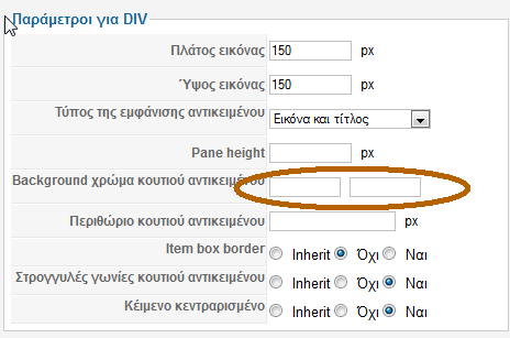

Hi I've made my categories and products transparent by going to... > hikashop > display and in menu content (2nd choice) you will have to change in every menu you created the background color of box. You must leave this field empty.
The same thing you will have to do with the 3rd choice (modules) under display tab. Change every background of all modules and all Associated products listing for category listing menu items. Go inside all of them and change the backround color. Leave it blank.
Don't forget to do that first in the main menu System > Configuration > display > options for DIV'S
I don't know if that helps.
Try it.

olioneill wrote: Hi Kooky,
Thanks for your message.. I've changed them all but it hasn't made a difference :(.
If I right click in Chrome and "Inspect Element" I can see the DIV tag for each part, I wonder if it could be as simple as changing each part of the table to transparent? But I don't know which CSS file it is stored in!
So you changed all of them and made them as the attachment shows and you saw no difference?
