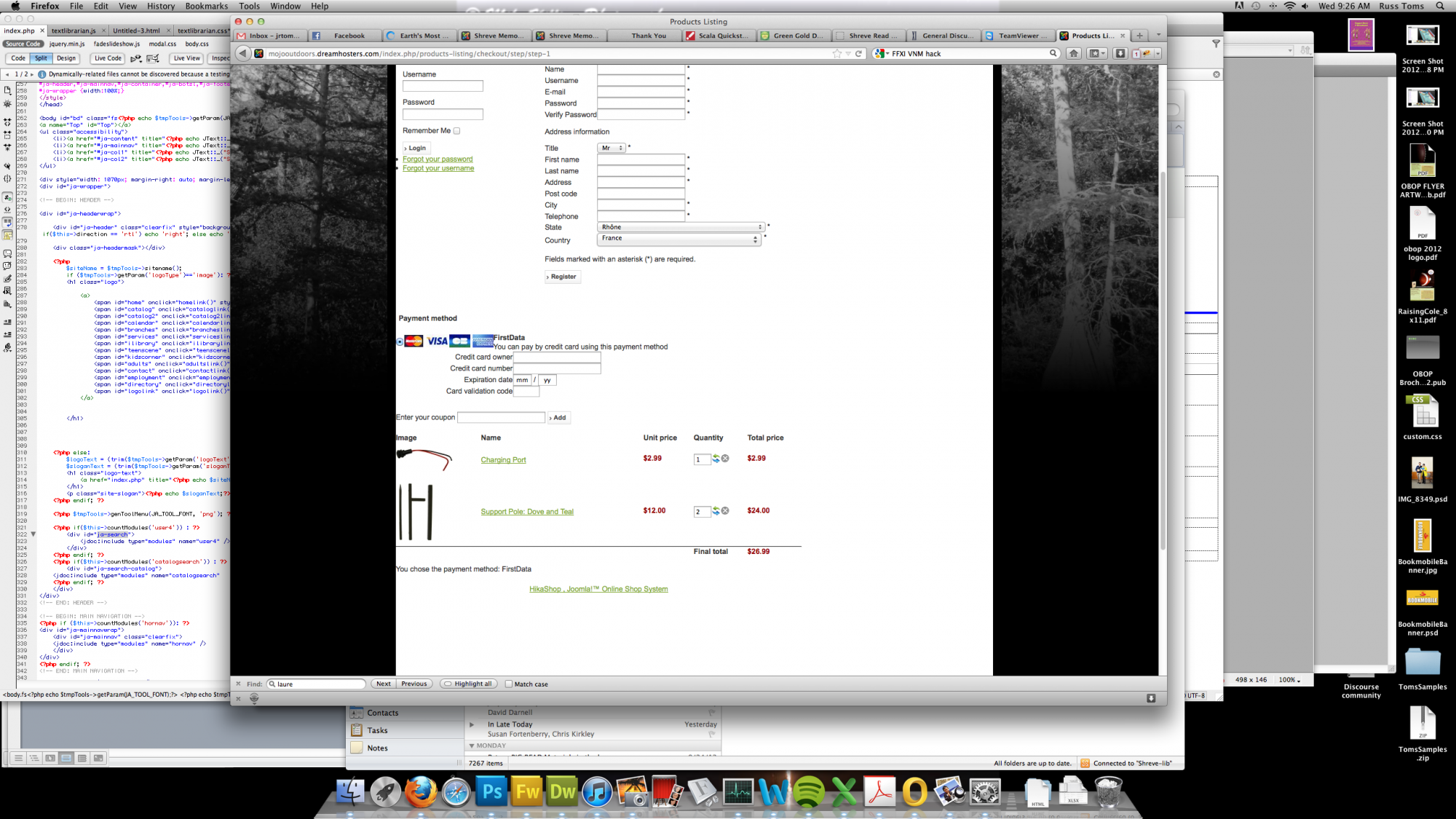

I have set up price ranges for the manual shipping plug in and for a time, they were working perfectly. My client decided to change the price and the ranges, so I changed them as needed. Ever since, I have been getting either wrong price ranges on shipping, or none at all. I'm attaching a screen shot as an example, of how the wrong one is being selected.
Please help, shipping has given me 15 kinds of headaches.

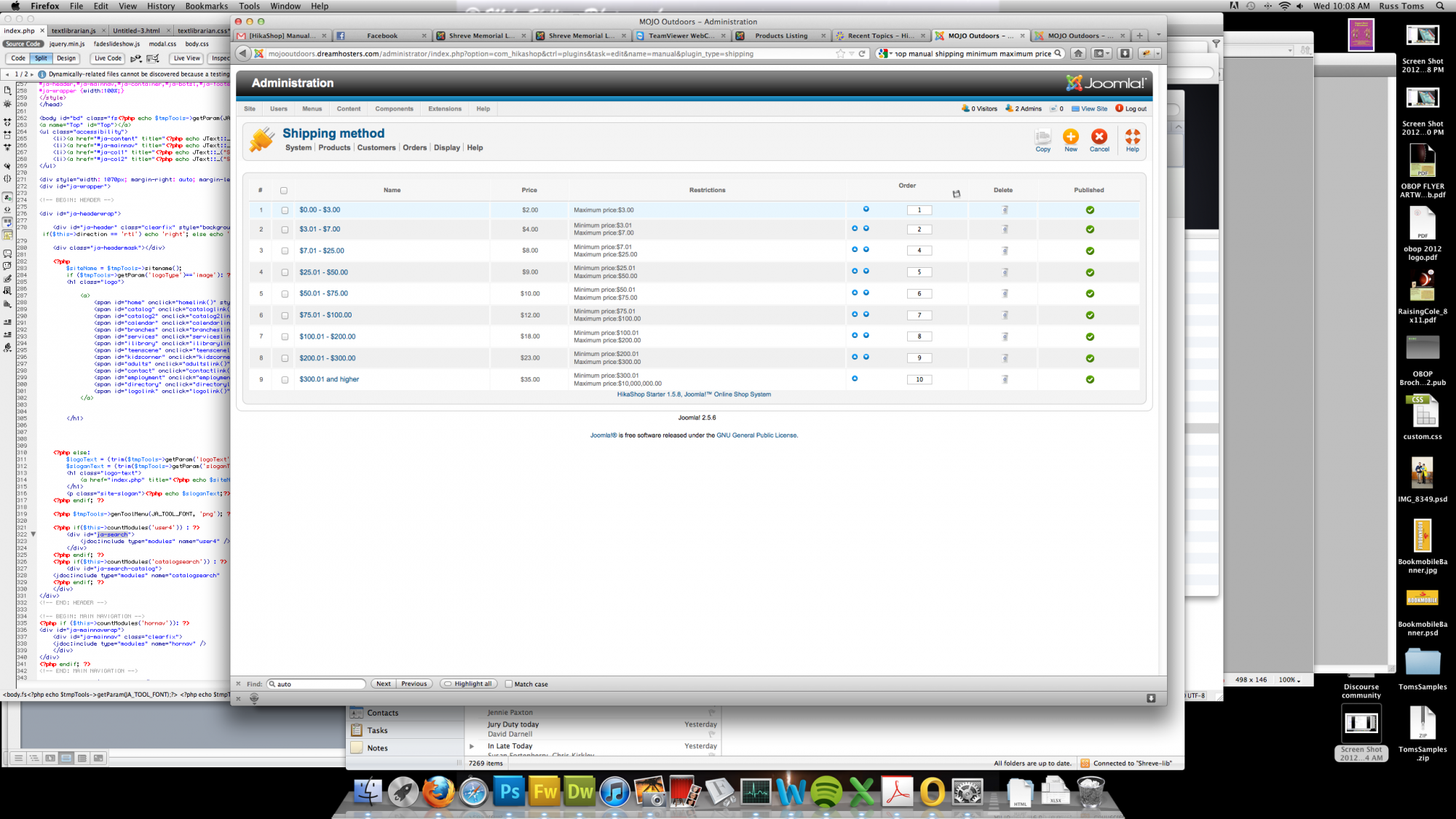

2. Can you send me screenshots of your manual shipping methods that you have now

2. Attaching shipping methods and also an example of a wrongly selected shipping method on the frontend.
3. I want the shipping method to automatically select the correct shipping price based on the order price. For example, if I have an order of 23.99 the price should be $8.00 for shipping.

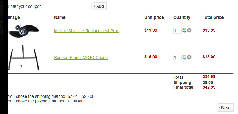

Ok, something that I did made it work somewhat (added weights to every product in my catalog) but when I update the quantity when viewing the full cart, the shipping costs go away on that page. If you hit next, they come back. A small error at this point, but my client is demanding consistency :(

It's still not showing a shipping cost when refreshing the quantity of a specific product in the cart. :(

That's because you removed the "shipping" view from your checkout workflow option of the configuration.
Without it, the system is not recalculating the shipping method when you change the products in the cart.

That fixed it! Thank you very much! :D :D :D
