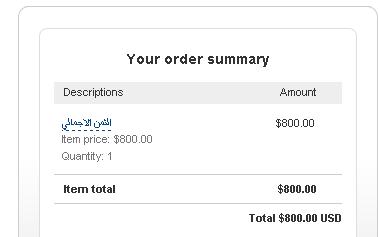

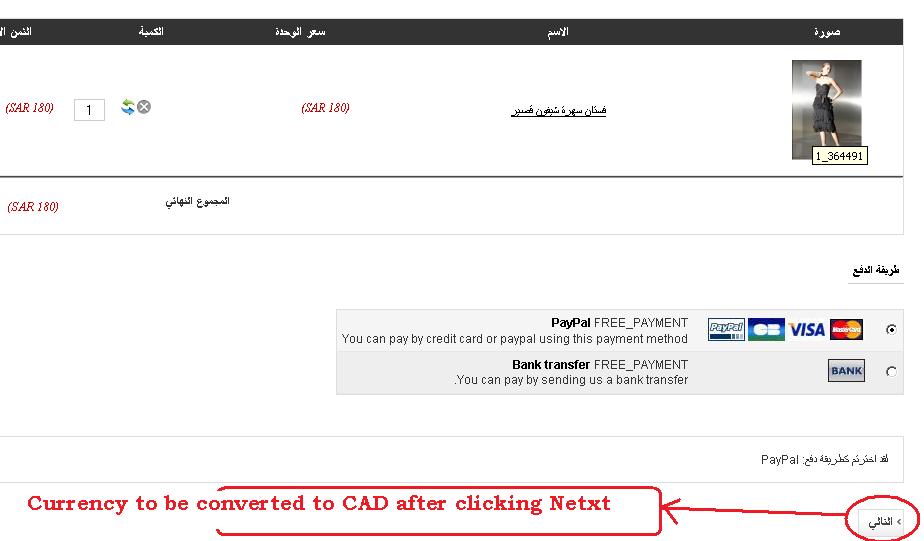

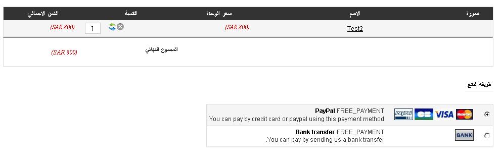

  • Posts: 25
13 years 11 months ago #69767
I was able to get paypal methods shwoing in the checkout page , but when I chose paypal method and click "Next", it does not convert
the SAR Currency to CAD. it shows the same SAR amount in CAD ? :blush:
So, I'm wondering if you guys could help me in this, or is there a simple way to make the SAR currency converted after the user click "next" button.
pls see attached file.
Thanks again :)

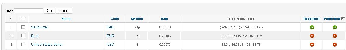

  • Posts: 86179
  • Thank you received: 14217
13 years 11 months ago #69903
You just have to make sure that the SAR currency has the conversion rate setup via the menu System->Currencies.
By default, all the currencies have a rate of 1.
We can't set a rate by default since it changes everyday.
  • Posts: 25
13 years 11 months ago #69911
Thanks Nicolas for your quick response :)
I set the rate as you said, but it still takes the same SAR amount in the checkout page to paypal in USD after clicking "Next" without conversion. :blink:
Here is my configuration :
Only SAR currency is published and displayed , no other currency.
Main currency: SAR
Products price : SAR
Please see attached files.

  • Posts: 25
13 years 11 months ago #70140
Thanks Nicolas,
I have changed the default currency and also tried several thing, and I have conclude that the currency conversion process takes a place only during the checkout process ( I mean when the user hit the "End" Button after adding an item on the shopping cart), it redirects him/her to checkout page with converted currency and a message saying that "the currency you chose is not accepted currency, it will be converted to USD ).However, that's not what I am pointing to.What I am looking for if it is possible to have the conversion step done after the user leaving checkout page when he/she click next to be redirected to paypal. :)
