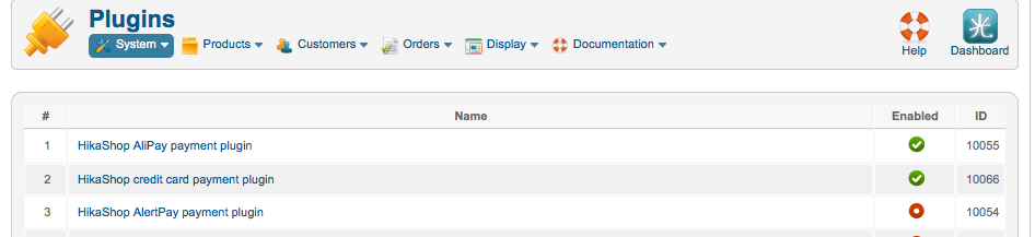

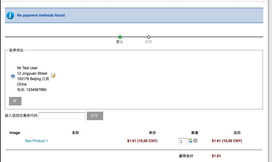

13 years 9 months ago #80968
Even after changing the address and currency Alipay is not being diplayed. Kindly check the attached screenshot. Anything else missing?
