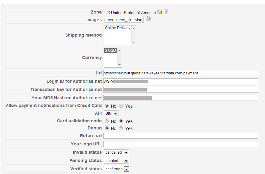

I was having difficulty getting First Data Payment to work but then ran into a post that suggested using Authorize.NET in SIM mode and that seems to be an option on First Data's Global Gateway e4 (GGe4). Configuration seems to be straight forward and I entered the values required. I'm not sure what the problem is but it doesn't seem to want to work. I keep getting the following errors from GGe4:
The following errors were found:
* x_line_item # 1 - Taxable is too long (maximum is 3 characters)
* x_line_item invalid
* x_relay_response : Parameter x_relay_response must be empty or TRUE
* x_relay_response : x_relay_response too long. Maximum length is 4
* x_test_request : Unsupported value used for x_test_request.
I tried all different combinations of settings to no avail. If anyone can shed a light on what the problem could be, I would really appreciate it.
Thanks for your help,
-Nazih
