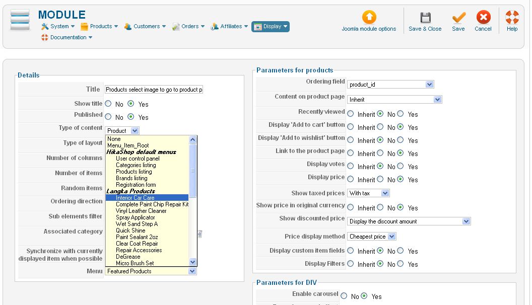

I have a carousel that shows all of our products.
All I want is for the links on the carousel to go to the product pages in my main product menu. They go to the product page but its a different link.
link to site:
65.61.122.164/langkatest/
Main product link from menu:
65.61.122.164/langkatest/index.php/most-...aint-chip-repair-kit
Main product link from carousel:
65.61.122.164/langkatest/index.php/compo...epair-kit?Itemid=116
I tried assigning "Langka Products" in the "Menu" of the details section, but it won't let me select it. It will only let me select one of the products in the menu. Which works better but not what I am looking for.(it still goes to a different link) Can the carousel be made to go to a specific link?

That's indeed that "menu" option that you need to change.
Note that your "main product link from menu" uses the "most popular" menu item, and not "Langka products" which is not a menu item but a menu type (so it's normal that you can't select that).

I tried rearranging my menu so my menu looks like this: Langka Products / Product listing / then my category products. This allowed me to select "product listing" to associate as the menu for my carousel. This still didn't work.

You have two modules: LANGKA PRODUCTS and PRODUCTS SELECT IMAGE TO GO TO PRODUCT PAGE.
You have one menu called PRODUCTS.
In the "menu" option of your modules, just select that PRODUCTS menu and that will do what you want.

I did exactly as you said. I added the "Products" menu to the module "Products select image to go to product page" and it still has two links.

The links are still going to different menus in your modules.
So either you didn't change the option for the correct modules, or you have some cache activated on your website which prevents you from see the changes. So make sure that the caching of the joomla configuration and the cache plugin are both deactivated.
