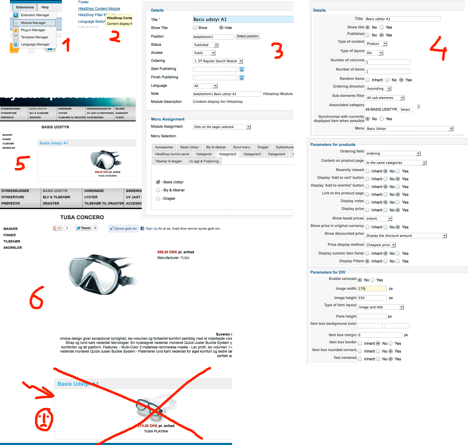

13 years 10 months ago #72859
Thanks for your reply, but I do not think you understand my dilemma.
Let me show you what I do and tell me where I make mistakes.
  1. I choose Extensions -> Module Manager -> New
  2. -> HikaShop Content Module
  3. I I fill in details in the module description, just like the picture. There chosen, the module must only appear in 1 menu item.
  4. I go into HikaShop Options. I fill it, just as shown in the picture
  5. I think I have made it good. I go on the website press menu and there comes my module. I am happy. It comes only there and nowhere else.
  6. I click on the title of the module to get to the product. The product arrives. The module also occur. It should not. The module must not be displayed with the product.
Last edit: 13 years 10 months ago by Tomasz.
  • Posts: 86212
  • Thank you received: 14219
13 years 10 months ago #73157
The menu item that you selected in the "menu" option of your module is the same as the one you have in the "menu assignment".
So what you did tells the system that when the user clicks on a link of the module, you want to redirect him to the same menu where he is already and for which the module is set to be displayed.
The solution is simple. Just have two menus: one where your module is assigned to (with the menu assignment option). Another one where the module redirect the user when he clicks on the link of the module (with the menu option).
