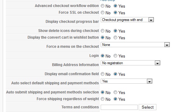

I have set Yes for "Force shipping regardless of weight" Option
now also it is not working,

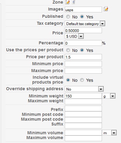

i have attached my manual shipping setting

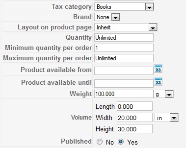

13 years 10 months ago #74477
in the previous post i have attached the shipping method configuration.
I have attached the ebook configuration.
i have attached the system->configuration->checkout page settings also

  • Posts: 86179
  • Thank you received: 14217
13 years 10 months ago #74889
after setting the weight for the ebook, when select the ebook product alone it is not taking the shipping cost
If you look at your ebook settings, you have a weight of 100g. If you look at your shipping method options, you have a minimum weight of 150g.
So it's normal that the shipping method does not display when there is only that product in the cart.
