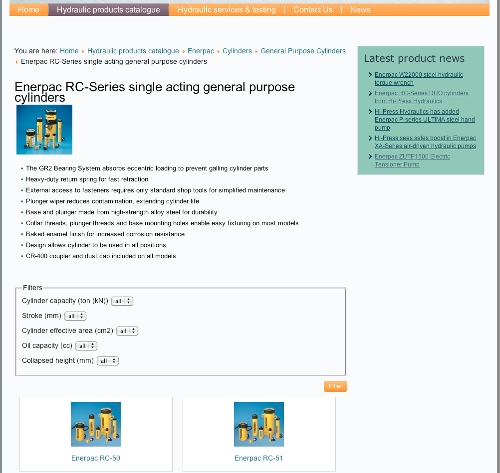

Hi, thanks for getting back to me. I've tried that, but don't get any options in the dropdowns, as you'll see on: www.hydraulic-products.co.uk/index.php/h...gle-acting-cylinders . Do you have any idea what might be going wrong?

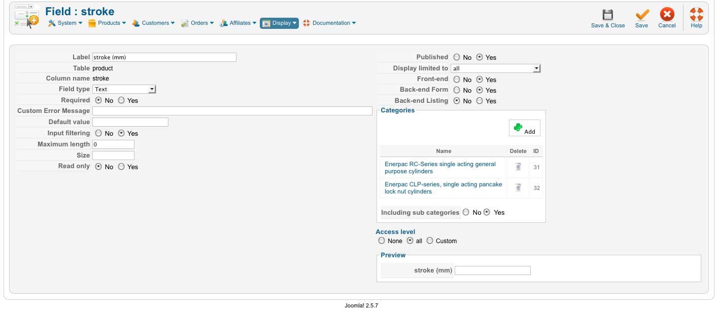

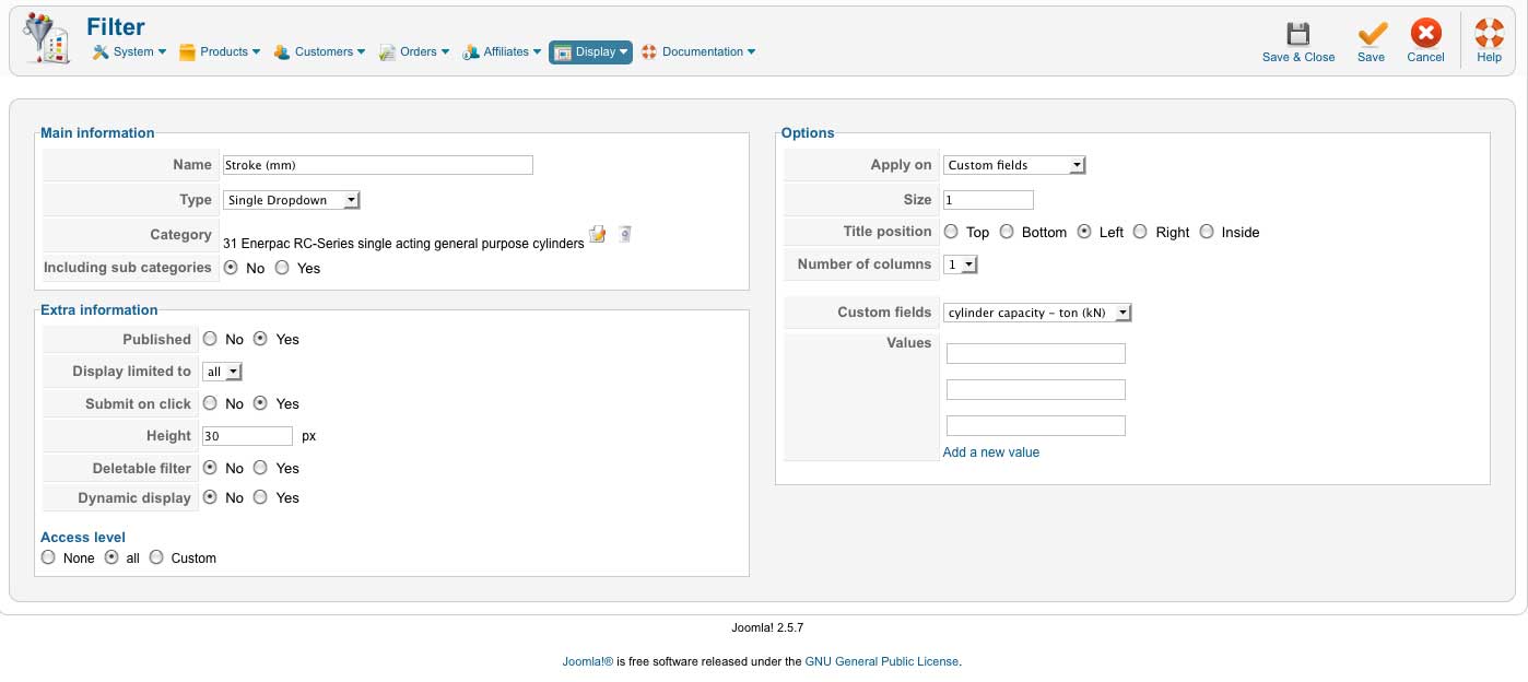

13 years 10 months ago #75324
Could you give me screenshots of the Stroke custom field configuration and the Stroke filter configuration ?

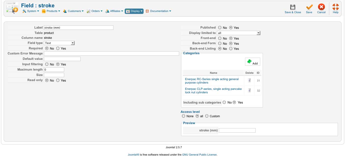

  • Posts: 35
13 years 10 months ago #75346
With pleasure, please find them attached:
Best regards,
Curtis
13 years 10 months ago #75358
To have the value of the Stroke custom field, you need to set the Custom field value in your filter configuration on "Stroke".
In you custom field configuation, you must have another Field type to set values if you want these values in your filter.
For example a custom field with the type "Single Dropdown" and add values.

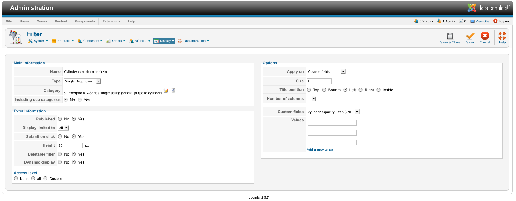

  • Posts: 86177
  • Thank you received: 14212
13 years 10 months ago #75611
It would, but only if you select 'Stroke (mm)' in the "custom fields" option of your filter.
On your screenshot, we can clearly see that it's not the case and that you selected there the custom field "cylinder capacity -ton".
Change it to the custom field you want and that should be ok.

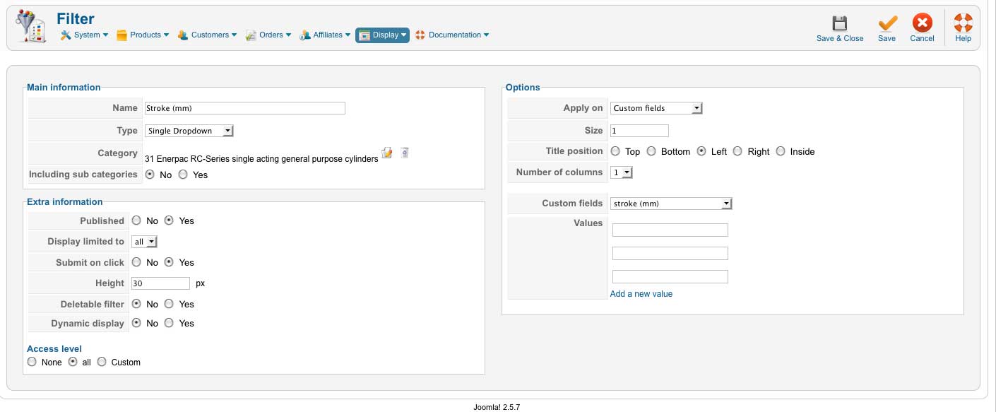

  • Posts: 35
13 years 10 months ago #75887
Hi, I sort of figured out that might be the case, but I've tried changing that, as you'll see from the attached screenshots. I'm probably being an idiot, and doing something wrong somewhere that I can't see. Any ideas? The fields are populated, by the way - if they were empty I could perhaps understand it.
Thanks again.
Curtis
the url for the catalogue display for this is: www.hydraulic-products.co.uk/index.php/h...gle-acting-cylinders
13 years 10 months ago #76069
To have the default value in the filter, you must have the Custom Field with the type "Single Dropdown" or "Multiple Dropdown" with values for this custom field.
Else it will no work.

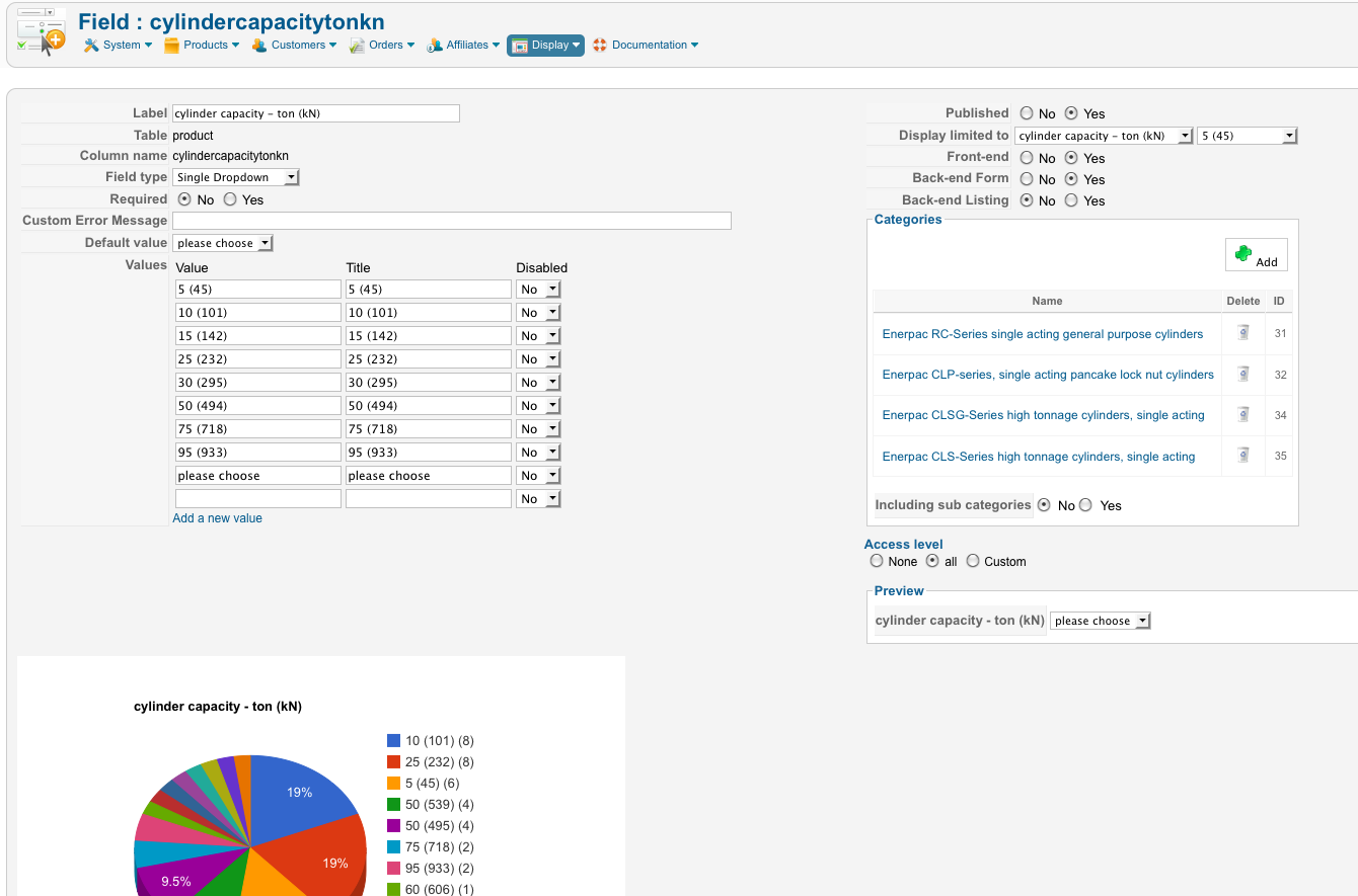

  • Posts: 35
13 years 9 months ago #80672
I'm still struggling with these filters I'm afraid. I've tried all kinds of things but can't get it to work. I accept this is something I'm doing, rather than a glitch in HikaShop, but I'd be grateful if you could let me know what I'm doing wrong.
First of all, am I right in thinking that it is not possible to set up a filter to be automatically populated with the data entered in a particular custom field for each product? For example. I have a custom field 'cylinder capacity - ton (kN)' for which I have already entered values in the 'Products' menu, if in the Filter for 'Cylinder capacity - ton (kN)' I select: Apply on 'Custom fields', then select for 'Custom fields' 'cylinder capacity - ton (kN), it will not automatically populate the filter with the values entered in that field for each product?
Secondly, I've attached a couple of screen grabs, so that you can see where I might be going wrong. I've selected 'single dropdown' in Field Type, and entered a selection of values, as you'll see. These values do display when I click on 'Cylinder capacity - ton (kN)' on the page (which is linked from here) , but I still can't seem to make it work.
Any help you can provide would be appreciated.
Best regards,
Curtis
  • Posts: 86177
13 years 9 months ago #80796
The system will take automatically the values of the custom field to populate the filter, but not the values that you would enter as text value for each product for the custom field.
The problem with your first filter is that the second filter has the same namekey for some reason. Please delete and recreate the second filter so that it has another namekey than the first one and it will work.
