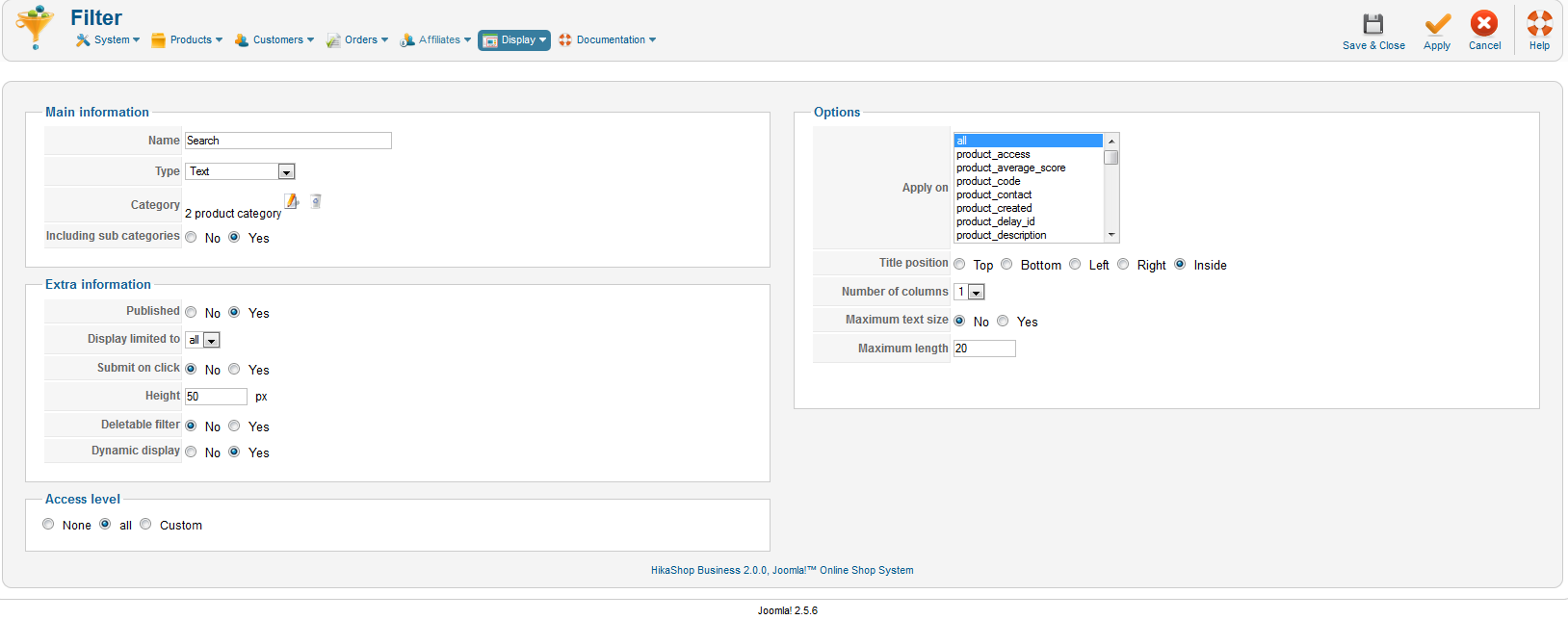

sorry where can i find this? I looked in Extensions - > Module Manager -> name of Filter module but can only see
Filter button position Left Right Inside. I select Inside but its still outside

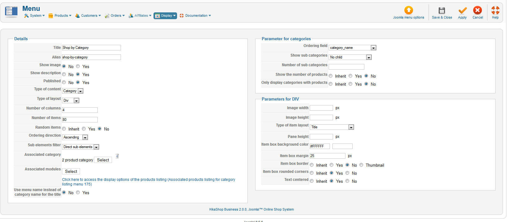

13 years 10 months ago #76187
I dont see the option for the filter in the menu option for category listing(see attached). Im looking in the menu option for the category listing, is this correct? I did also check the filter module and the button is set to be inside but it still isnt
see attached screenshots
