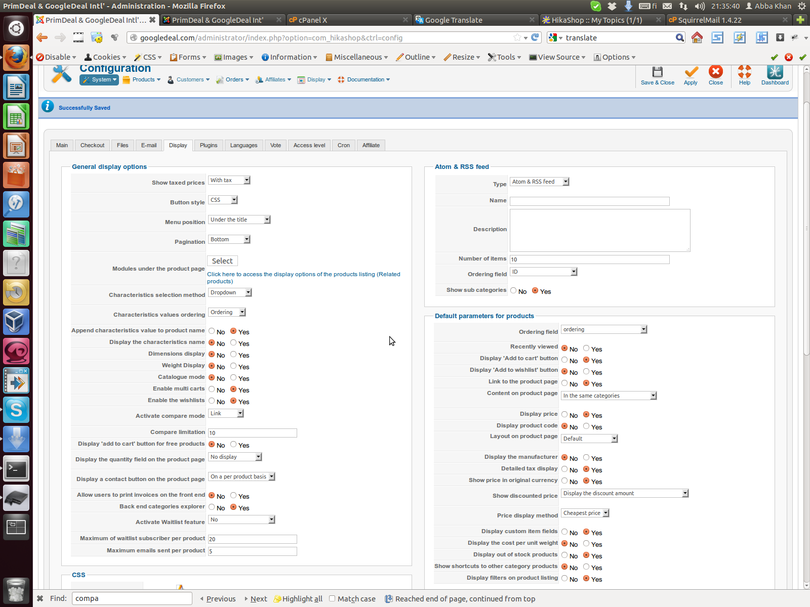

Both of my Wishlist and Compare mode is on. Wishlist button shows normally but when I click it I get the following error:
"An error occurred"
The "Add to compare list" button does not appear at all!
You can see here:
googledeal.com/fi/categories/14-pariisi-ranska.html
Settings can ve viewed from the file I have attached.

For "Compare list" I do not find any settings other than following 2 settings in "System->Display":
Activate compare mode (My selected value is "link")
Compare limitation (My value is 10)
I have checked:
1. System->Plugins
2. Display->Content menus
3. Display->Content modules
AND also other setting pages and tabs, but could not find any setting option(s) for "Compare list". The fact is the Compare button was being viewed for a while after I did make the above mentioned 2 settings (in bold), but suddenly it just disappeared.
About Wishlist, by activating the debug mode of Joomla!, I could not detect any new errors, a white window appears with the error: "An error occurred", nothing new. :(
Moreover, when a product contains Option(s), "Choose options" button is visible correctly but the "Add to wishlist" button disappears.
Sorry, I did deactivate the Wishlist as it was producing error. I have reactivated the module so you can try it.
