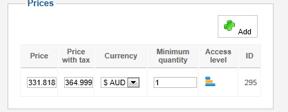

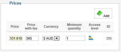

Hi, have just upgraded a site to v2 and am getting a weird calculation problem when adding new products.
When I add the price with tax and then click into the price box it correctly calculates the pre-tax price. eg: $365.00 price with tax calculates the price before tax as $331.818181818.
As soon as I hit "Apply" the prices revert to $364.999998 price with tax and $331.818181818 price before tax.

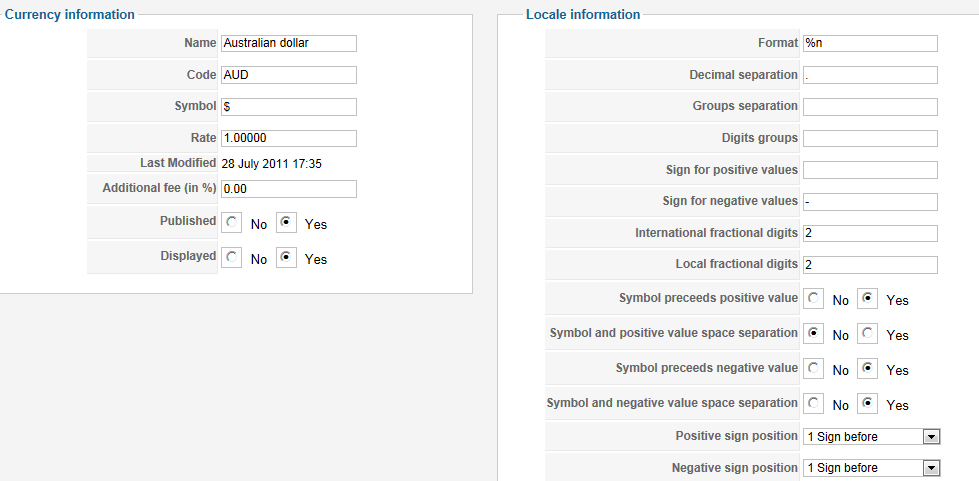

This is my currency setting:
Is there some new setting I need to change somewhere in v2 to keep the price with tax at 2 decimals?

13 years 9 months ago #77890
The price with tax is re-calculated on apply based on the price without tax. That's why the price with tax change.
Just change the price without tax value to obtain the price of $365.0.. and all the prices displayed will be well rounded.

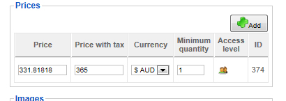

Hi, thanks for the reply but it does seem that something has changed between v1.5.8 and 2.0 in the way this works. Using your advice, in order to get an exact post tax price of $365.00 I need to enter a pre-tax price calculated to a full 9 decimal places!
In a store using Hikashop version 1.5.8, all I need to do is enter $365.00 into the post tax price and it calculates the pre tax price without changing the post tax price at all.
This is from a store using 1.5.8:
Okay - but means that now knowing the pre-tax price to it's full decimal value is key to getting the right prices shown. A few Excel worksheets no doubt... But if there is a workaround to what appears to be a rounding problem it would be appreciated.

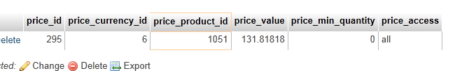

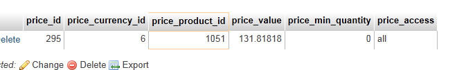

13 years 9 months ago #78688
Actually, Xavier's solution above does not work. I can enter as many decimals as I like into the pre-tax box to have it correctly calculate the with-tax price, but as soon as I hit Apply the pre-tax price is rounded to 5 decimals resulting in a with-tax price shown to 6 decimals. (Weird but true!)
For example, an item selling at $145 (including 10% tax):
Before save:
Enter pre-tax: $131.81818181818 to calculate $145 with-tax (yes! 11 decimals required!!)
After save:
Pre-tax = $131.81818 and with-tax $144.999998
In fact, where Jerone says that the prices are stored precisely in the database, this is not the case as my pre-tax price is only being stored to 5 decimals. In effect - BOTH prices seem to be now incorrect.

13 years 9 months ago #78747
This is not a limitation of HikaShop but it is your database.
If you want more precision in HikaShop, you have to modify your table #__hikashop_price and change the type of the column "price_value".
Your actual type should be "decimal(16,5)" and you want "decimal(16,11)" (or "decimal(24,11)" if you want more accuracy for big numbers).
