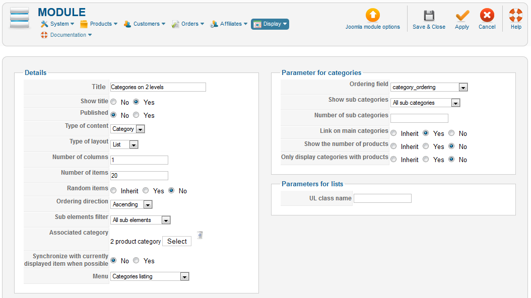

13 years 9 months ago #78333
In HikaShop > Display > Content modules, create a module like that:

13 years 9 months ago #78441
The screenshot is in a previous post of Xavier.

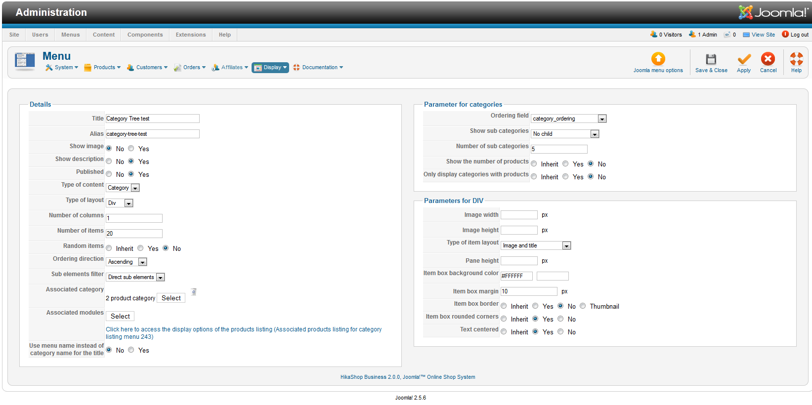

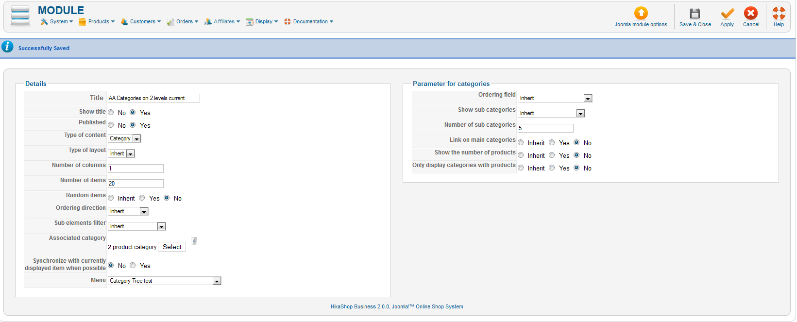

  • Posts: 115
13 years 9 months ago #78715
tried the above but not working like the demo site and still not looking right, I renamed the categories on 2 levels module to AA Categories on 2 levels current so it was easier to find
Ive attached screenshots
1) the website is www.britishfoodabroad.co.uk
2) the test menu option I am using for this test is called Category Tree Test
3) the module I am using is called AA Categories on 2 levels current (been renamed as there were multiple modules called Categories on 2 levels)
Can you help?
13 years 9 months ago #78735
The options of your module does not match with that what I gave you in my previous post.
Please, follow our recommendations.
