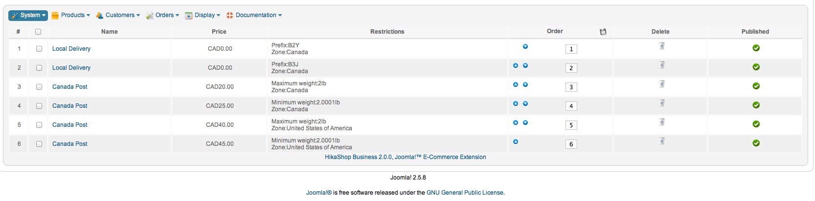

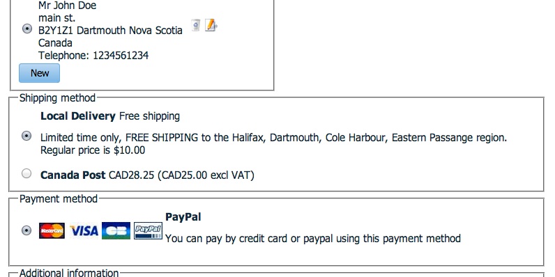

Is there a way, in the manual shipping plugin, so that only the 1st valid shipping price is displayed, not all matching prices?
I want to provide special local shipping pricing, based on the postal code. I've added a method (see attached) to filter on the postal code. That method is first on the list, however the plugin still selects and shows all the matching methods (see the other attached image)
thanks
Trent

  • Posts: 6
13 years 9 months ago #79441
Thanks, that's a good idea, but I only showed 2 of the local delivery postal codes, in fact their are 12 of them, and they are not consecutive. I fact, I had to had the manual.php program a little bit for it even to work properly. I guess that I'll try to hack it a little bit more.
I will make an enhancement request -- an option that would allow the administrator to select if they want all matches, or only return the first matching manual shipping method
-Trent

  • Posts: 26386
  • Thank you received: 4078
13 years 9 months ago #79532
That's right, it's not possible to put a city as a zone.
So the best way would be to override the "checkout | shipping" view
If you just want to display the first shipping method, you can replace
foreach($this->rates as $rate){
By
$rate = reset($this->rates);
if(!empty($rate)){
The following user(s) said Thank You: tdilkie
