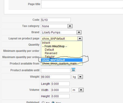

trying to create a custom "show_default" view or page.
i created a copy of the "show_default" with a new name, and saved it.
When i assign it to a product, as shown...
and save it, when i go to try to view it in the store, i get a "500 - Layout show_MAPdefault not found" message.
how do i correct this?
