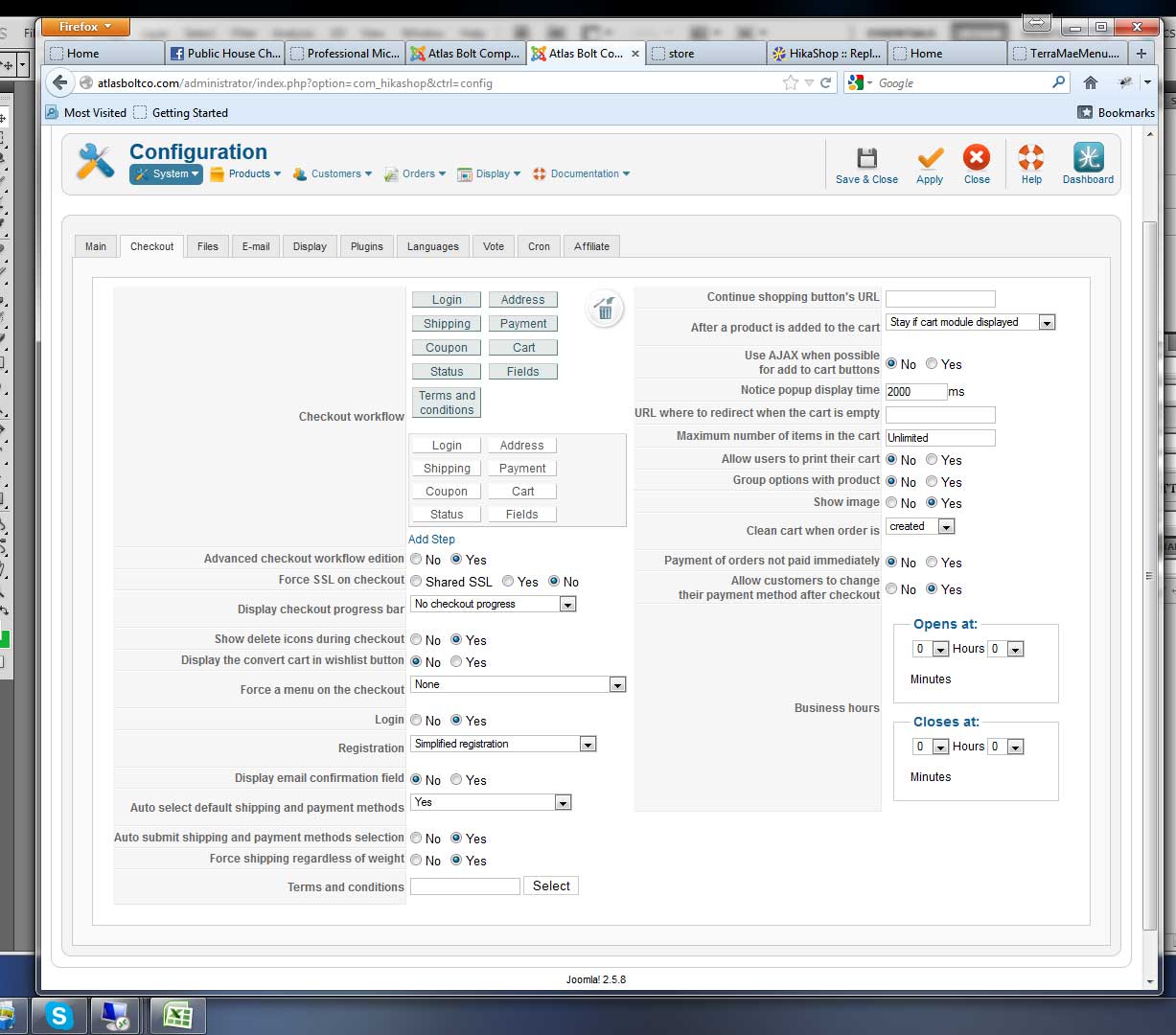

I continue to get "No Shipping Method Found".
I have checked the following:
1. I have made the zone United States and have tested with no zone - either way - I get the same "No Shipping Found"
2. I have selected UPS next day air, second day air and ground
3. The plugin is public and I have re-saved it.
4. I have forced shipping by weight, and my test product has weight of 13lbs.
5. Shipping is part of the checkout process in configuration.

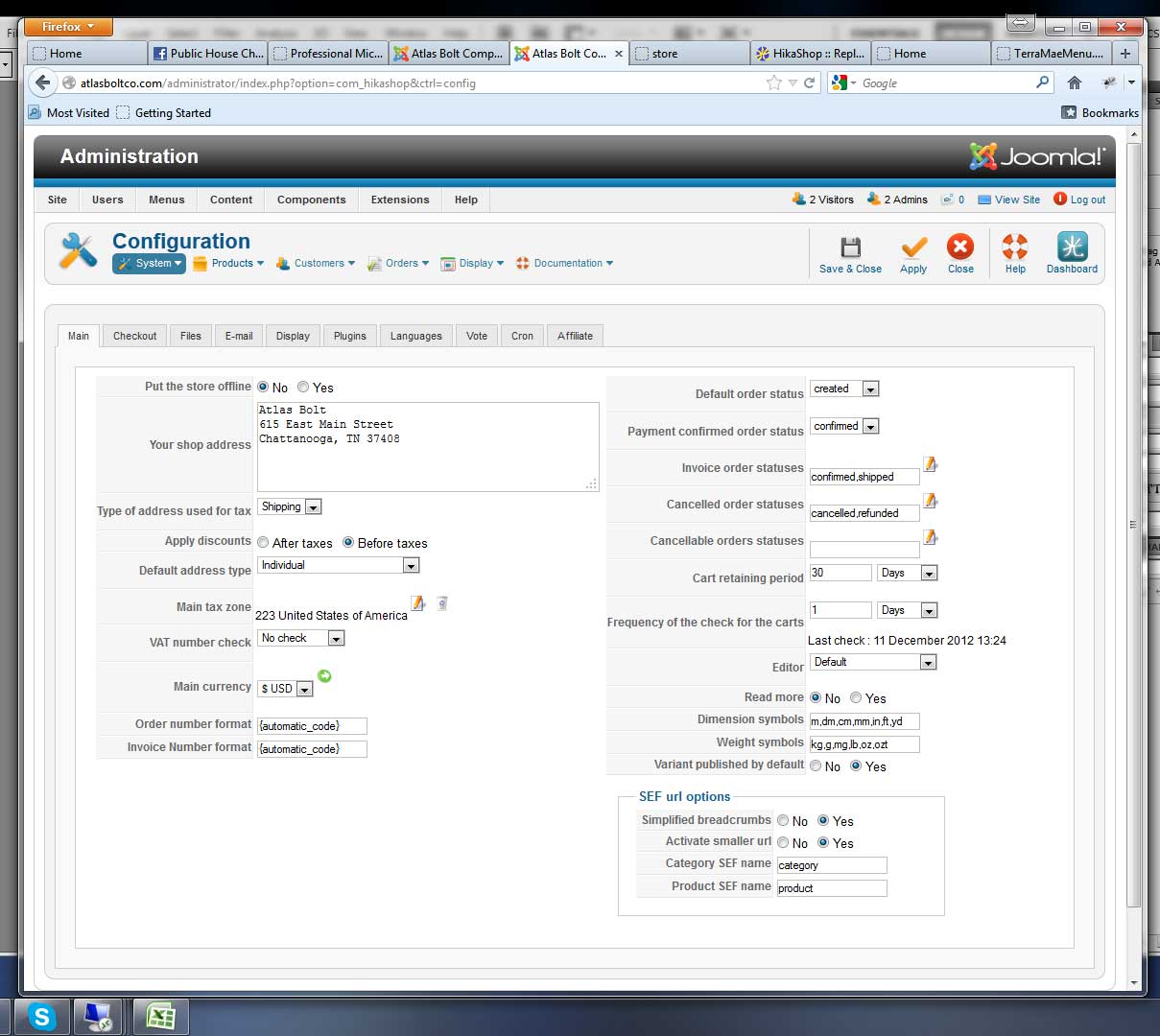

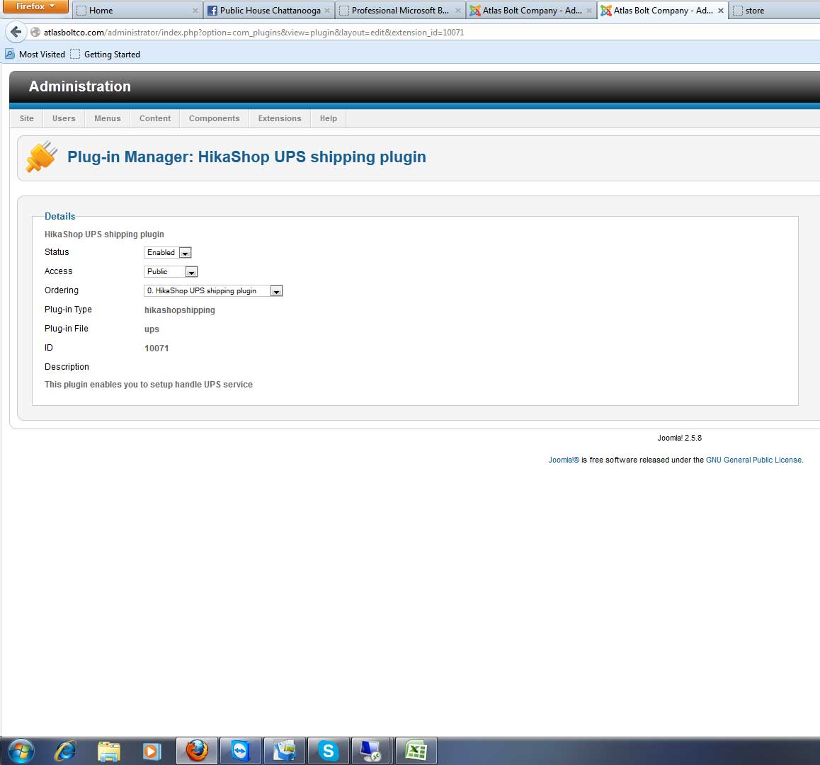

  • Posts: 71
13 years 9 months ago #81424
I am using the latest Hikashop version.
I do not see a debug mode on the UPS plugin. Where would I find that? I have looked at the UPS shipping module and the joomla plugin UPS shipping module.
The client's address is correct, and we are using 223 United States of America.
Please see attached screen shots.
