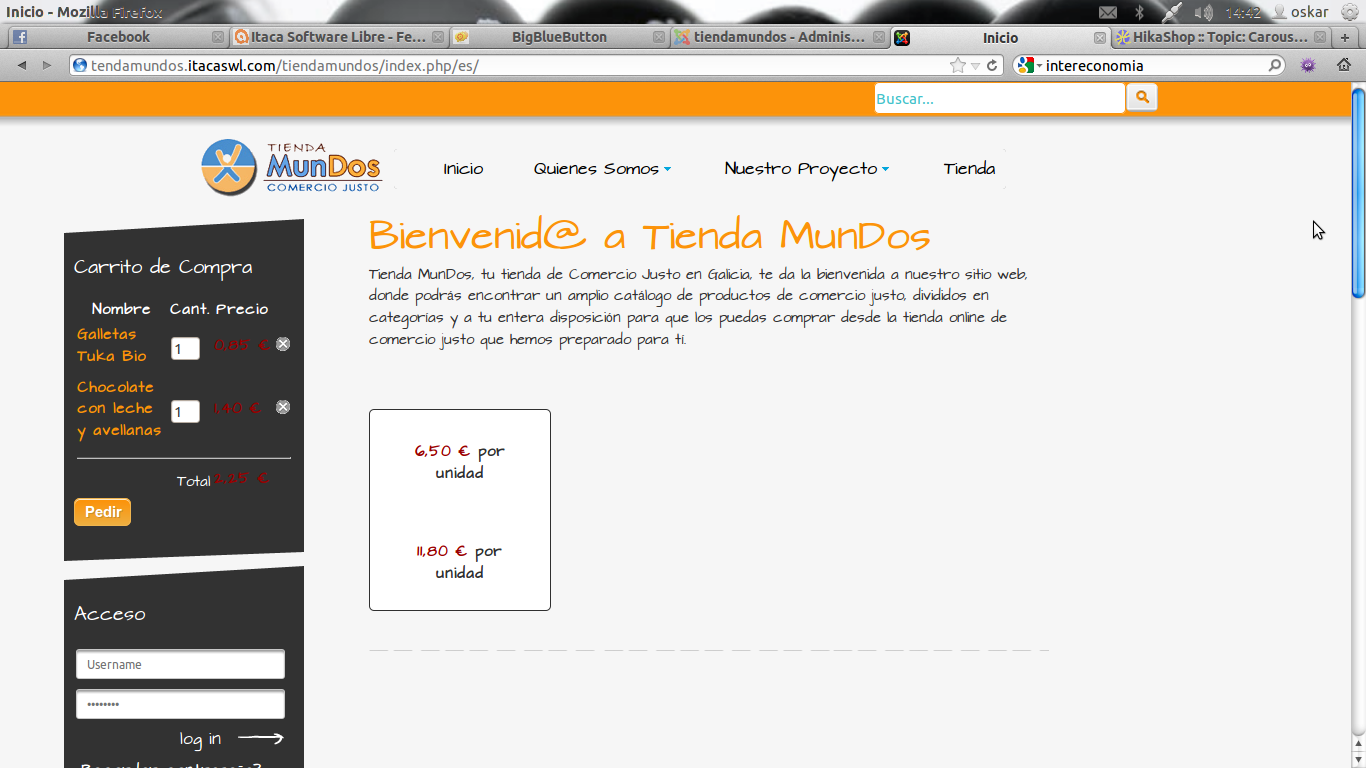

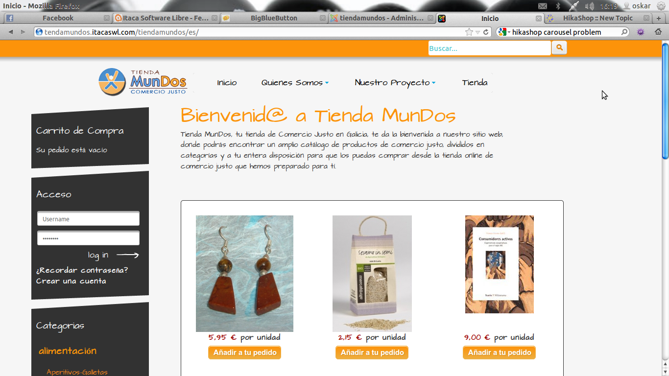

Hi i have a problem with the carousel.
Sometimes dont work fine ...
Please help me.
To see the error, attach 2 pictures one working fine and another working wrong.

13 years 9 months ago #81594
The problem is not solved. The problem is that sometimes carousel not work fine

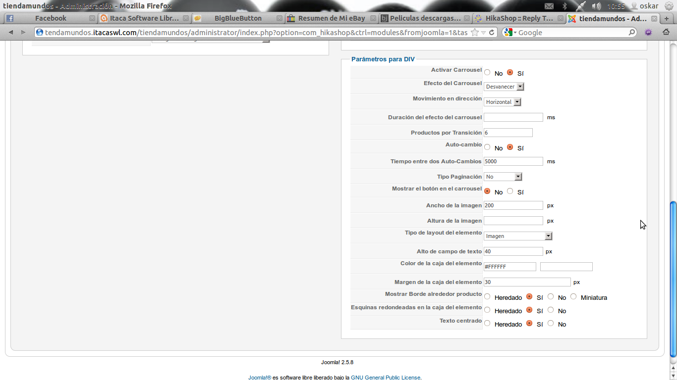

Could you give us a screenshot of you carousel configuration ?
Are you displaying other modules sometimes or not ?
Is the problem occurring always on the same page ?
  • Posts: 15
13 years 9 months ago #81617
the carousel is only in the home page.
Yes, there are other modules on the same page.
Attach
screenshots of settings.

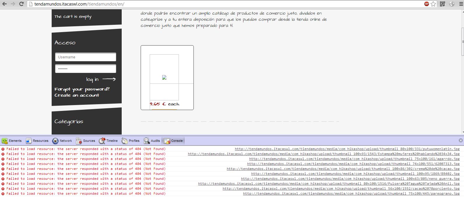

13 years 9 months ago #81761
I have see two times the problem by making several refreshs and the carousel does not really crash.
When I had the errors, a lot of images where "404 error" in the carousel. So I think that the missing images broke the carousel script.

13 years 9 months ago #81898
Thanks.
I think that the problem is solved.
Filling the value of widht and height , the carousel works fine .
