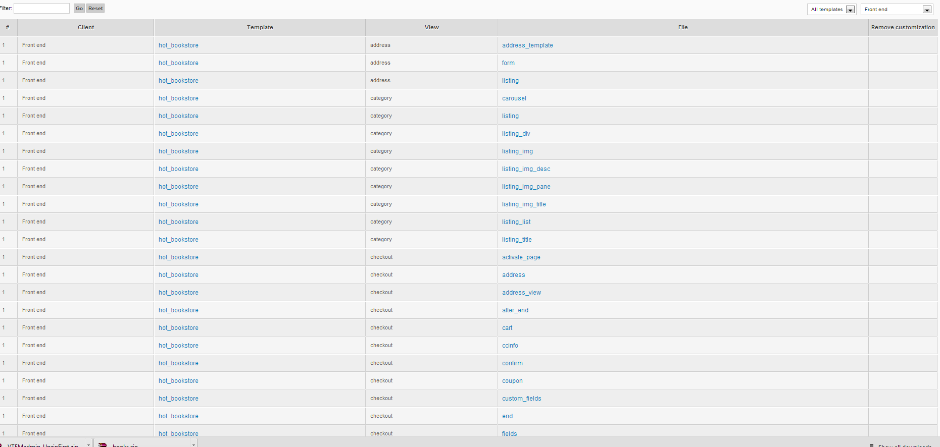

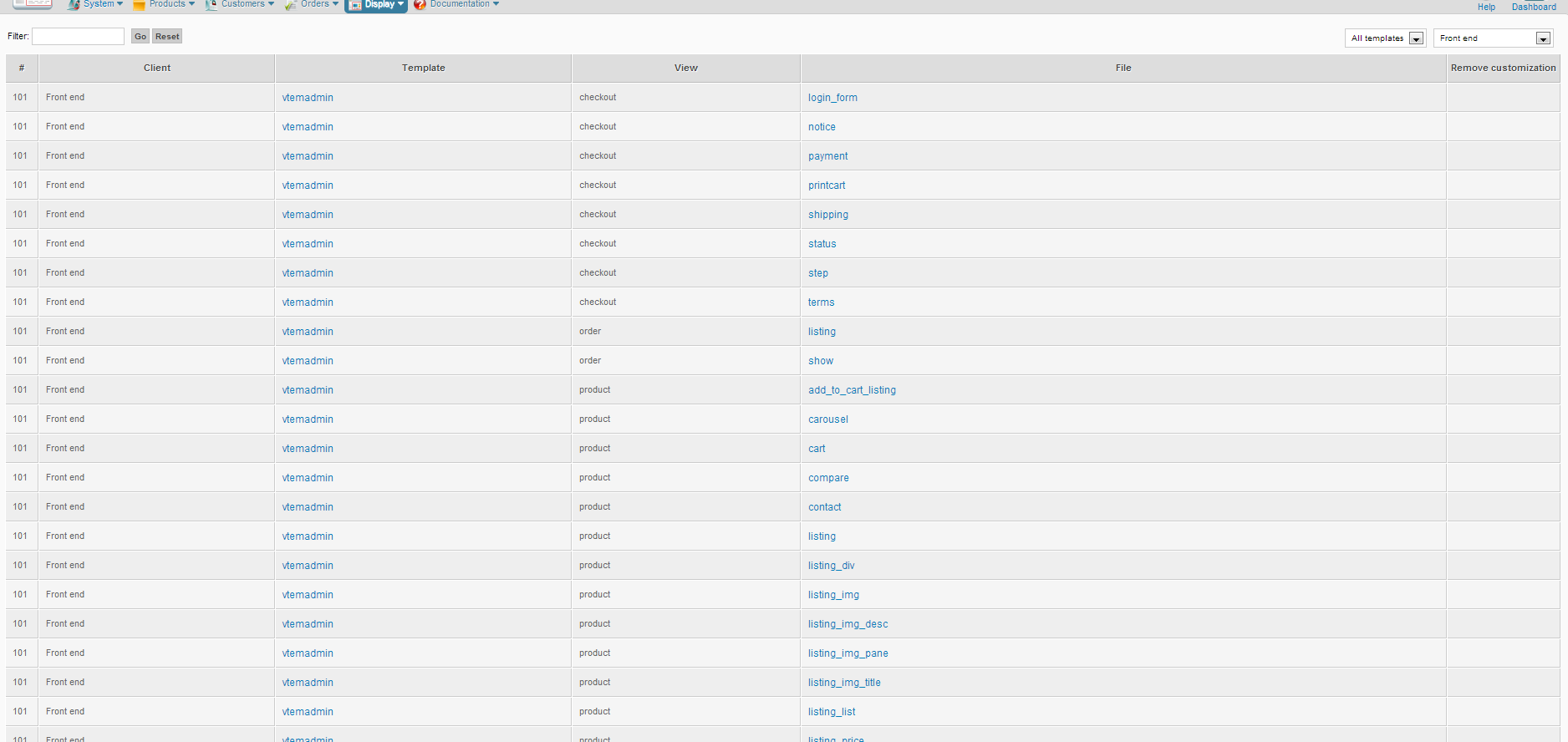

Dears, i am sorry, don't want to bother you but small question again. I had a problem that on checkout/step it changes template, puts back end template visible ?!?
I went to display-view, and saw that it took back end template. Images attached.
How to change it, delete it, to disable back end template in ALL front end. ??

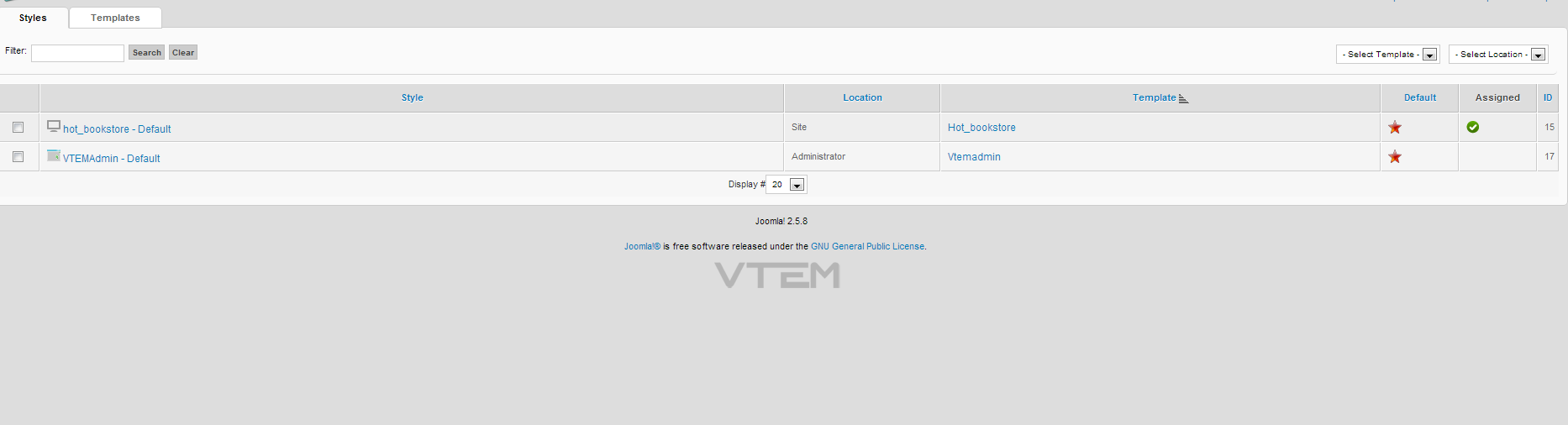

As you see, in joomla i defined tempaltes properly.
Please help me asap?

I think that your component which is changing your backend interface can interact with the templates assignation.
Try to disable it to see if the templates get back on the good views.
