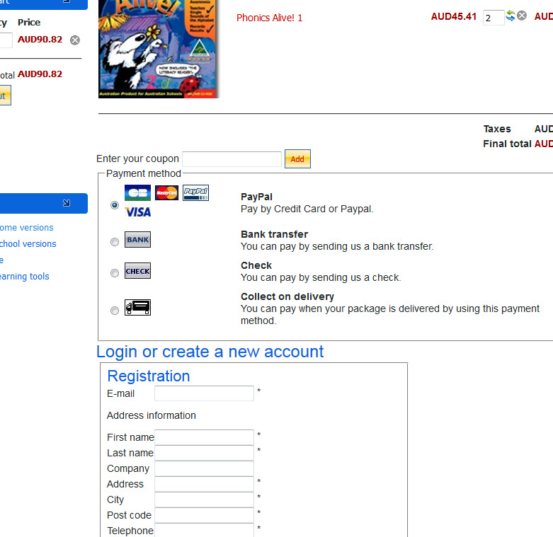

URGENT, please help, as I am trying to finish this job and it seems when I get close something goes wrong again with this.
I have changed the wording in the language tab in configureation as per this forum - as we want ORDER NOW or similar NOT REGISTER NOW and some other changes.
I did all these successfully, the job has been left for a few weeks and when I go back the wording is all changed again back to the original although the language file is there and saved with my changes.
PLEASE PLEASE HELP urgently.
See attached screenshot, I had changed this to ORDER DETAILS etc but now is jumping back to this.
Here is the link to the page - this is not in any menu so you need the link -
phonicsalive.com.au/index.php/home-versions
THANK YOU

That means that you did a mistake when you changed some of the text. You should turn on the "debug language" option of the joomla configuration. That will display all the errors in language files on the pages of your website at the bottom with the line number of the error, so you will see where is the problem.

I actually did this a few weeks ago and haven't changed anything and it was working. I have fixed it now by copying the text from another shop I made for which I originally copied this from the site that was not showing the correct changes I made. Hope you understand this, it just seemed to change on it's own and now I have copied the info from the other site that is working it is ok.

Did you use the language part or the override part ?
Language section could be overwrite by updates or by the "update language" button.
