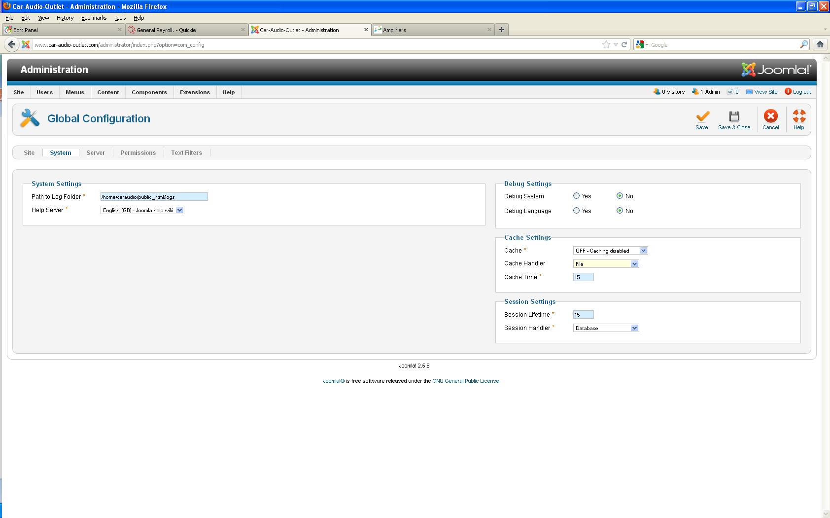

13 years 8 months ago #82684
If you're talking about disabling the joomla cache, I've check the settings - sett attached image - and it appears to be off. If you're talking about turning it off in hikashop - can you advise where and how to do this.

13 years 8 months ago #82878
The ajax add to cart system can only handle one cart module at the time.
So there are two solutions to your problem:
1. You use only one cart module.
2. You deactivate the option "Use AJAX when possible for add to cart buttons" in the Checkout tab of the configuration and that should work for both cart modules.
