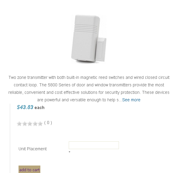

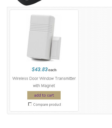

  • Posts: 11
13 years 7 months ago #87277
The custom fields keep disappearing from both category and product pages on and off, I deleted and re indexed the items changed categories, no changes the same problem, this was working for couple of weeks and just started doing that again Links:
www.websurveillance.com/index.php/hikash...for-products-listing
www.websurveillance.com/index.php/hikash...r-window-transmitter
13 years 7 months ago #87385
The custom field seems to be displayed in the listing.
For the product page are you sure that you haven't removed the code which display the custom field ? in the view "product / show_tabular"

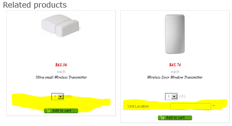

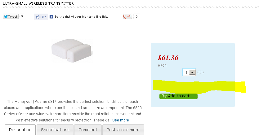

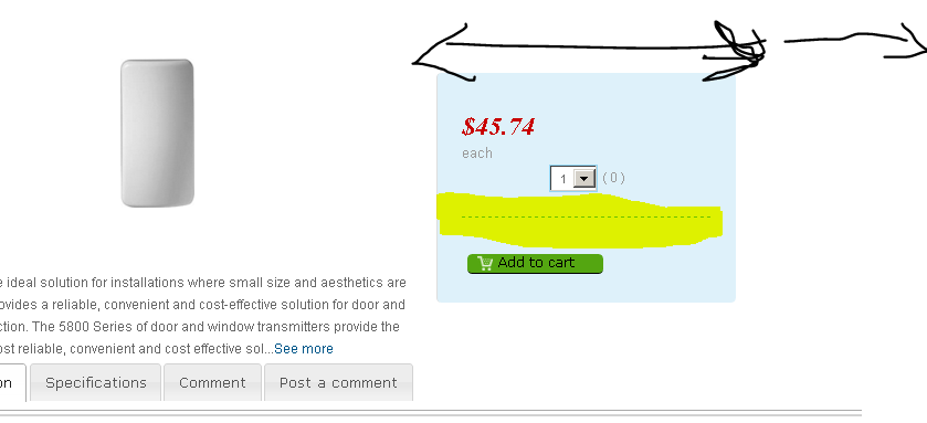

13 years 7 months ago #87452
Please see attached images, where always the first item has no (Custom Field)but all the other does, but when you click on any item the (Custom Field) disappear,
also please advice how to make the blue are in items wider. (see item.png)

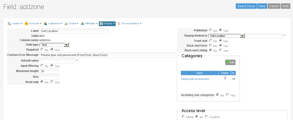

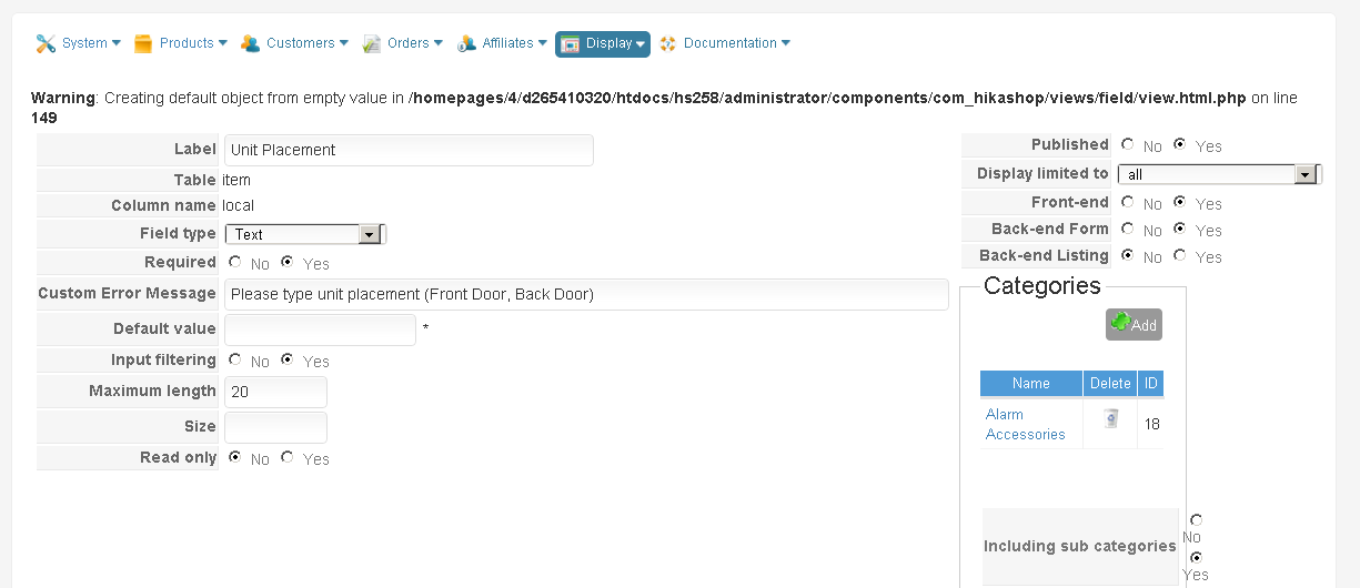

13 years 7 months ago #87481
Could you give us a screenshot of your custom field configuration ?
  • Posts: 11
13 years 7 months ago #87542
see attached image

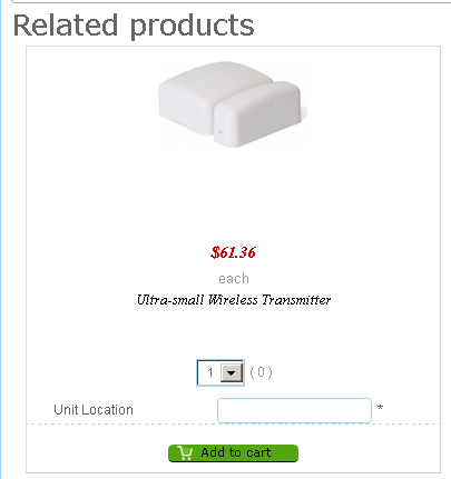

13 years 7 months ago #87596
Try to remove the limit ("Display limited to" option).
You restrict it to a category, that's maybe why the first product of the listing don't have the custom field. Is the product in the category "Honeywell Accessories" ?
  • Posts: 11
13 years 7 months ago #87609
I changed the category to main category instead subcategory, now it shows in related products but not when you open item
13 years 7 months ago #87627
Do you have removed the value for the "Display limited to" option ?
If you set a default value (temporary) is it displayed on the product page ? Try to add "echo $this->element->addzone;" in the view "product / show_tabular" and see if there is a value.
