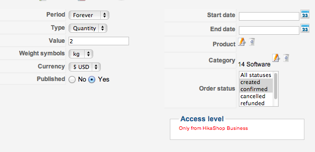

13 years 8 months ago #85929
How do you have set the limit ? Can you give us a screenshot ?
Try to set the limit on the software category only and not on the product.
  • Posts: 90
13 years 8 months ago #85973
I misspoke, I did actually set the limit on the category. It still functions the same way. Change the option to a different option and the limit doesn't apply.

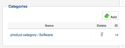

  • Posts: 86180
13 years 8 months ago #86036
So you're saying that whether the limit is set on the category, or on the product itself, you get the same behavior ?
Is the software category directly linked to your product ? If not, could you try to do it with the direct category of the product ?
  • Posts: 90
13 years 8 months ago #86039
By "Directly Linked" do you mean this?
:) — Josh
