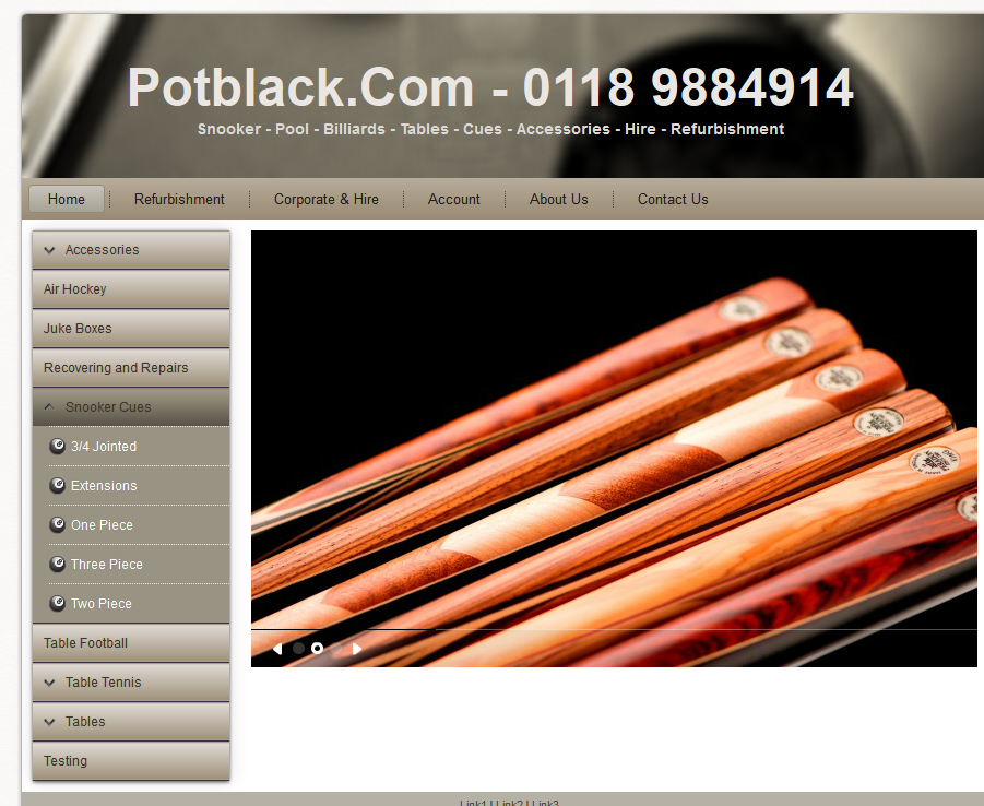

I am using the skyline accordian published on the left of a site im working on at the moment and it works as I want it. But now I want to change some of my product categories into subcategories.
For example if you look at the screenshot, i want to create a category Cues, then move snooker cues, into this category. Now I create the category "Cues", and it shows on the left. Now when I change the parent category of "snooker cues" from the default "product category" to "Cues", It does not show and the "Cues" category disappears from the menu and doesnt show at all.
It seems as soon as I change the parent category of an existing category it dissappears from the menu and I cant understand why. There are several categories on the left that have sub categories that show perfectly well, so not sure if its something I havent setup right or if its a bug.

Do you still see the category correctly in HikaShop after moving it ?
If so, then it sounds like a problem from that module.
Otherwise, there might be an issue with the parent category change in HikaShop and that would require investigations on our end.

Sorry for the delay in replying, this project had taken a bit of back burner. now back on it.
Yes indeed the category looks fine within hikashop and i can browse to it ok.
I have contacted skyline to see if they can help.
