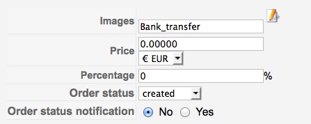

13 years 7 months ago #89154
is set to Created (see figure)
but the order is cleared from cart
regards

  • Posts: 86180
13 years 7 months ago #89346
If you want that the cart is cleared directly at the end of the checkout all the time, you can change the option "Clean cart when order is" to "created" in the Checkout tab of the configuration.
