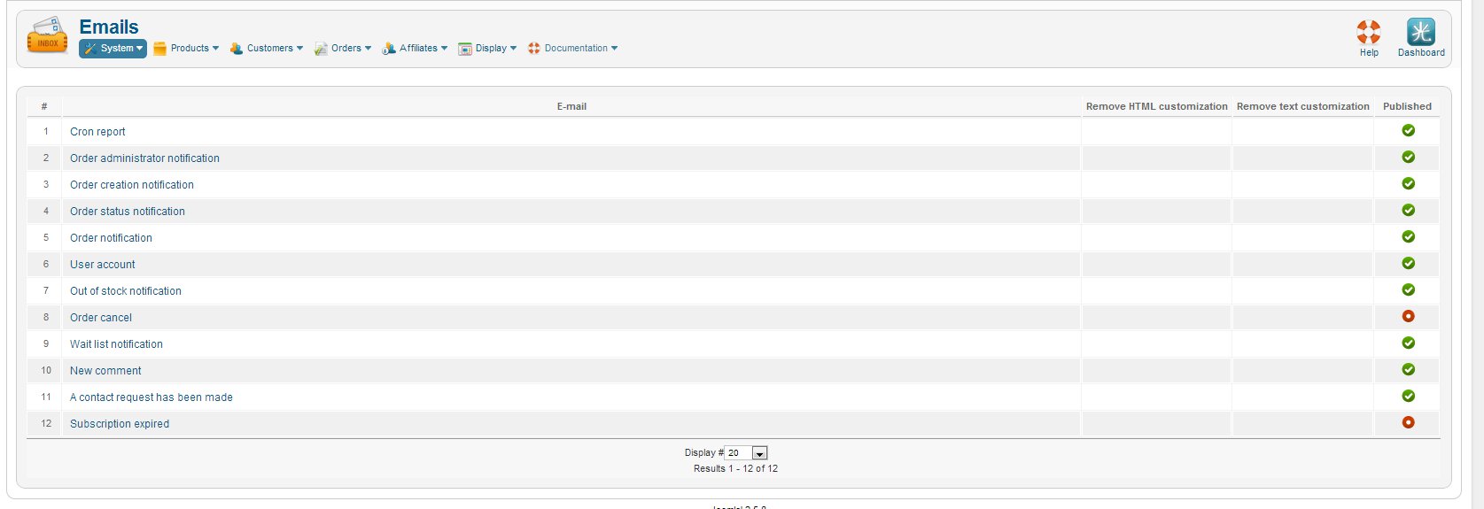

13 years 6 months ago #91588
There is an email called "Order administrator notification".
Please check that email is right published in the HikaShop backend.
  • Posts: 106
13 years 6 months ago #91595
Hi Jerome,
I checked but the Email are not changed (see attechment).
I hope you have a Idea.
Best regards, Gerard
