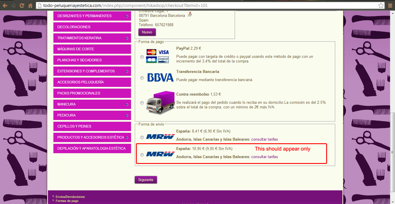

13 years 6 months ago #92485
shipping method as set with the weight of the products you see more than one shipping method you choose.
if weight is 0 to 1.99 kg = 6 €
if weight is 2 to 4.99 kg = 8 €
At Checkout 3kg weight is only showing the second option and not the two to choose.
thanks
13 years 6 months ago #92528
It's normal, if the weight is 3kg, so the shipping method displayed are the method corresponding to this weight.
You can't select a shipping method up to 2kg if you product has a weight of 3kg.
  • Posts: 14
13 years 6 months ago #92586

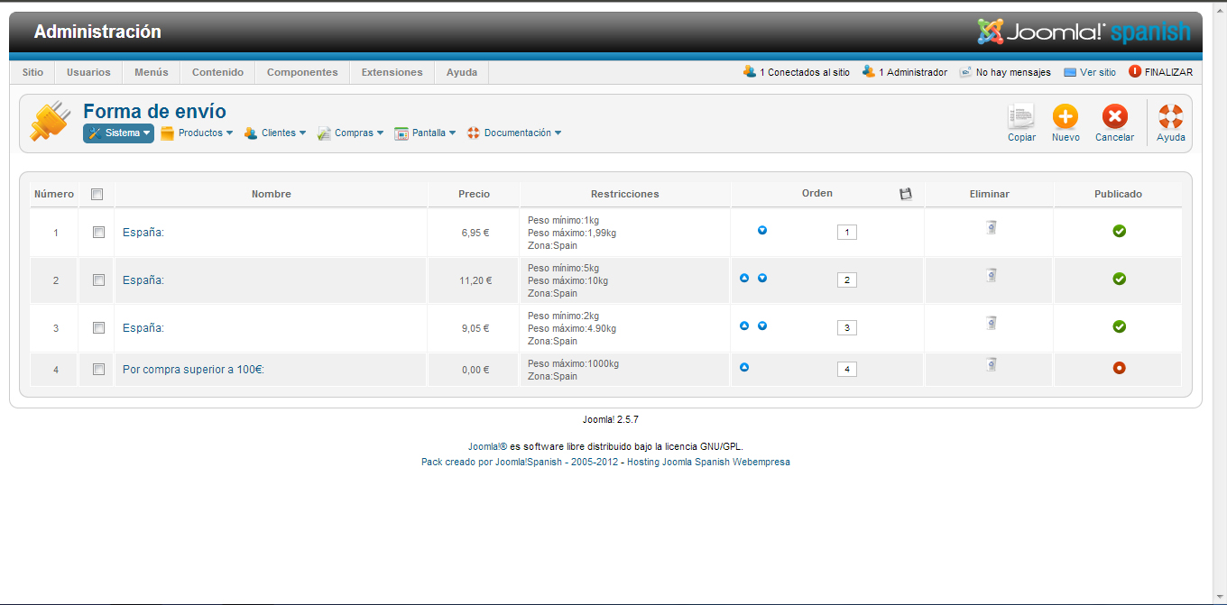

Yes, I agree with you. the problem is that it appears also sending 0-2kg.
you would simply leave the corresponding total order weight and several options for customer to choose els.
attached screenshots.
thanks

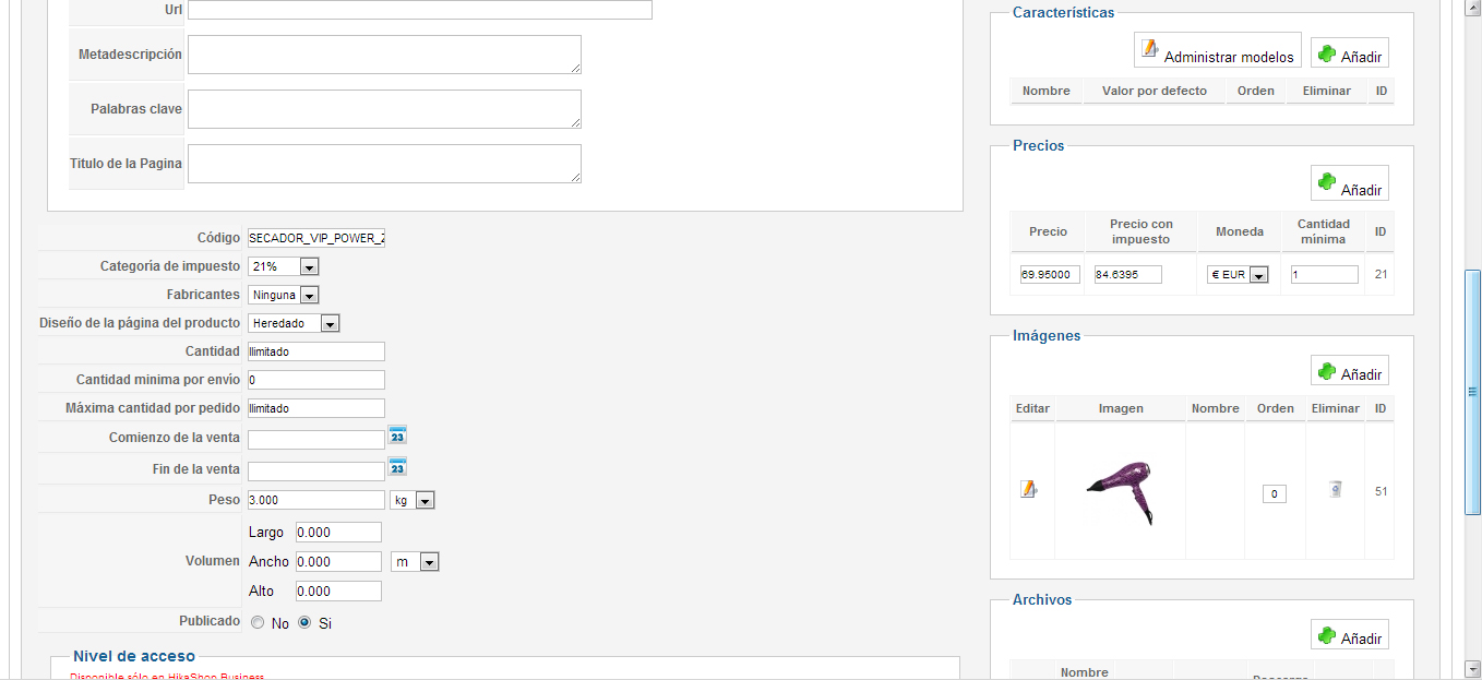

13 years 6 months ago #92625
Can you show me how did you configured your product (your product configuration page) through some screenshots ?
Thank you.
Last edit: 13 years 6 months ago by Mohamed Thelji.
  • Posts: 14
13 years 6 months ago #92644
OK, the product has a weight of 3 kg. and should only leave the weight for that right?
thanks
13 years 6 months ago #92803
Could you give us a screenshot of the less expensive shipping method parameters ? Or a backend access.

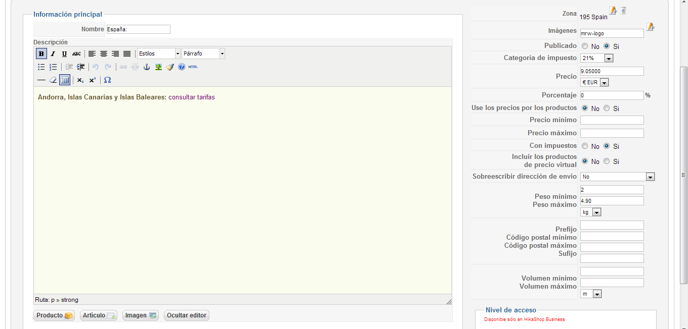

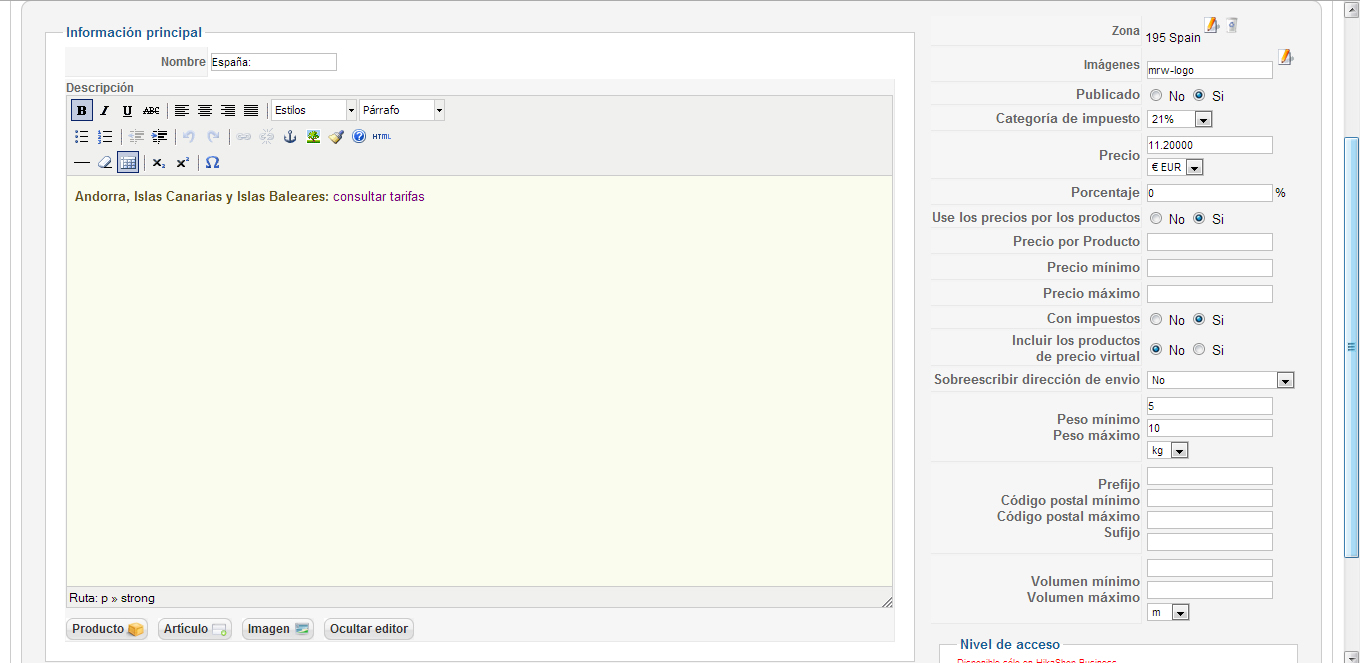

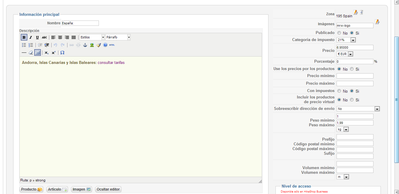

  • Posts: 14
13 years 6 months ago #92964
Hi xavier,
I send you screenshots of shipping methods, I have also created a user account
thanks
Last edit: 13 years 6 months ago by nicolas.
  • Posts: 86180
13 years 6 months ago #93156
In your first shipping method, please use 1.99 and not 1,99 for the maximum weight and that should help.
