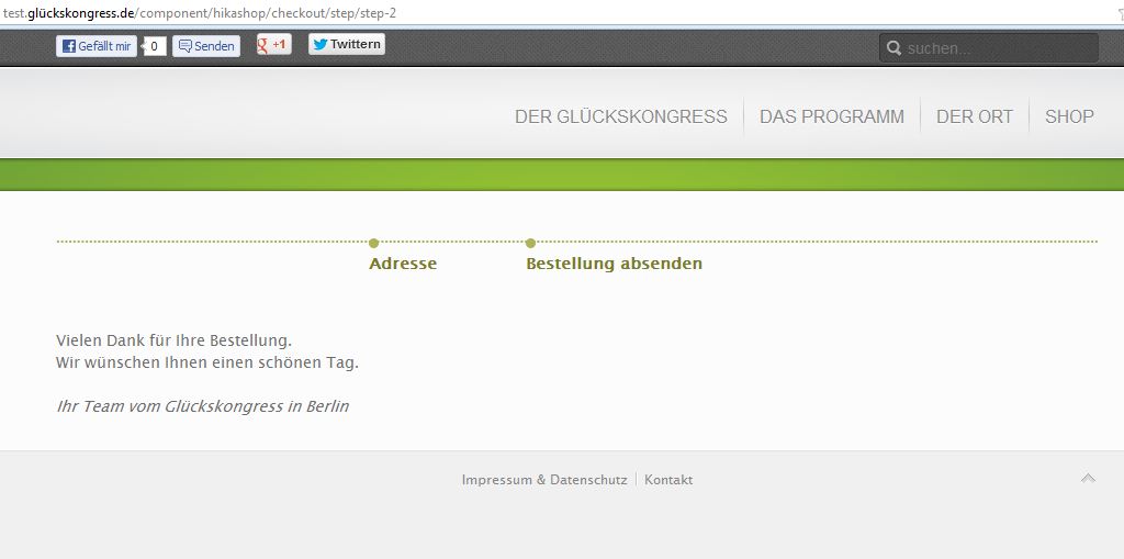

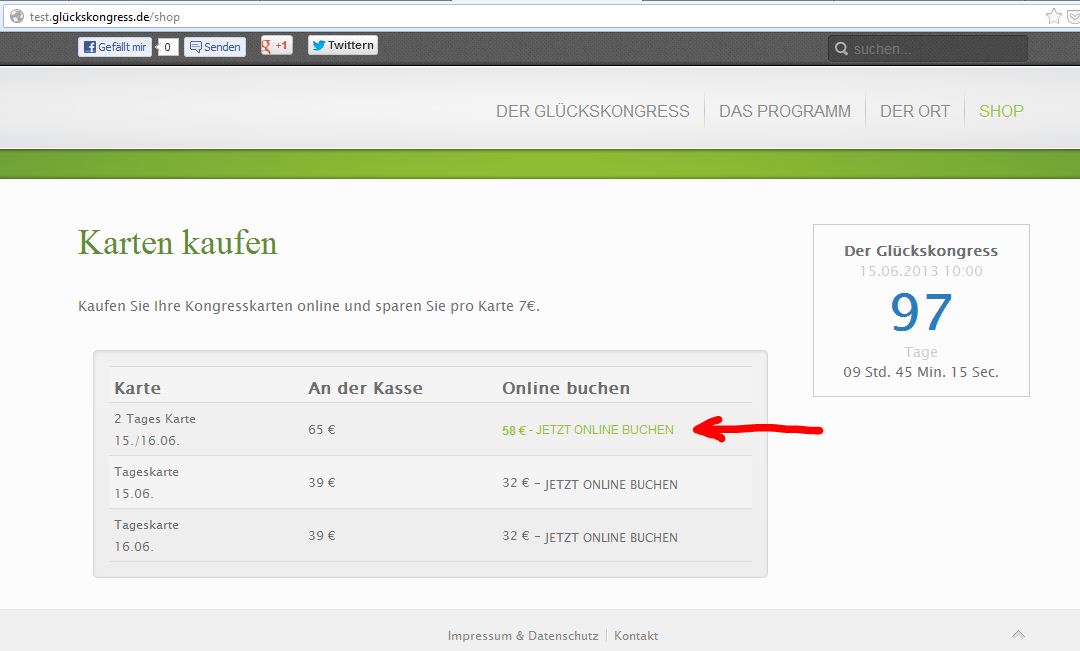

If you click there on "58 € - JETZT ONLINE BUCHEN" then the checkout process starts (no user registration).
After two steps it should redirect the user to paypal, what does't do. Not on the first attempt... If I restart the process then it works :S
Be careful, there is a real paypal account active - so don't finalize the payment, if its working...
I send you some screenshots.
Start: 1.JPG
Result (no paypal): 2.JPG

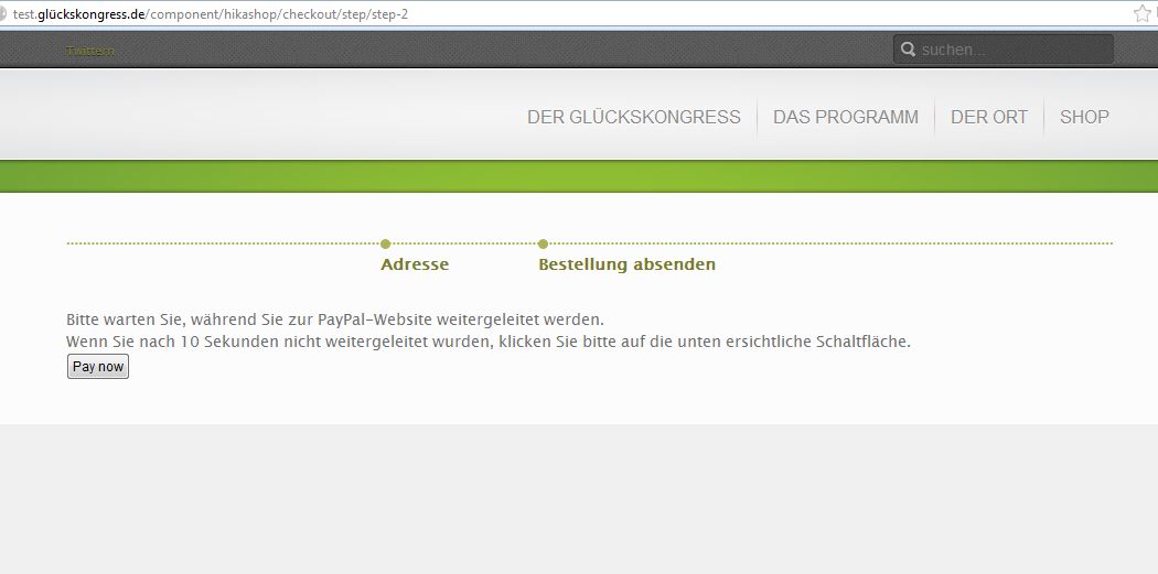

Then after an new start at: test.glückskongress.de/shop
going again through the process I end here, as my goal was: 3.JPG

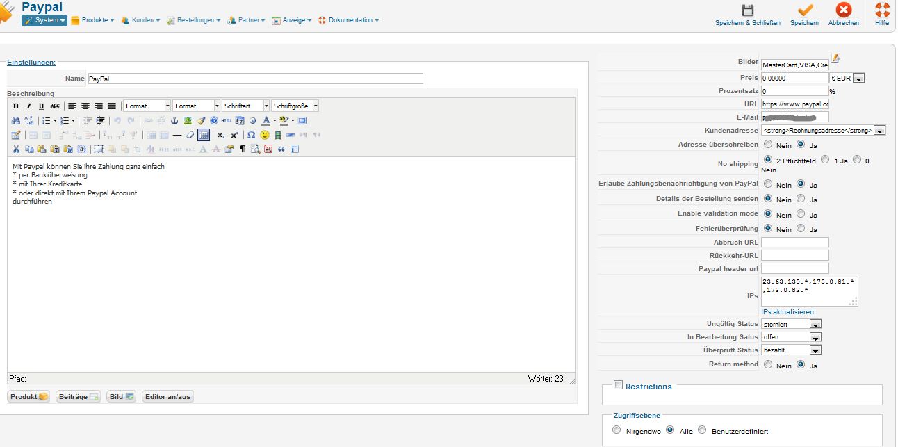

  • Posts: 7
13 years 6 months ago #93731
Now the backend settings...
The Problem is the same at FireFox and Chrome.

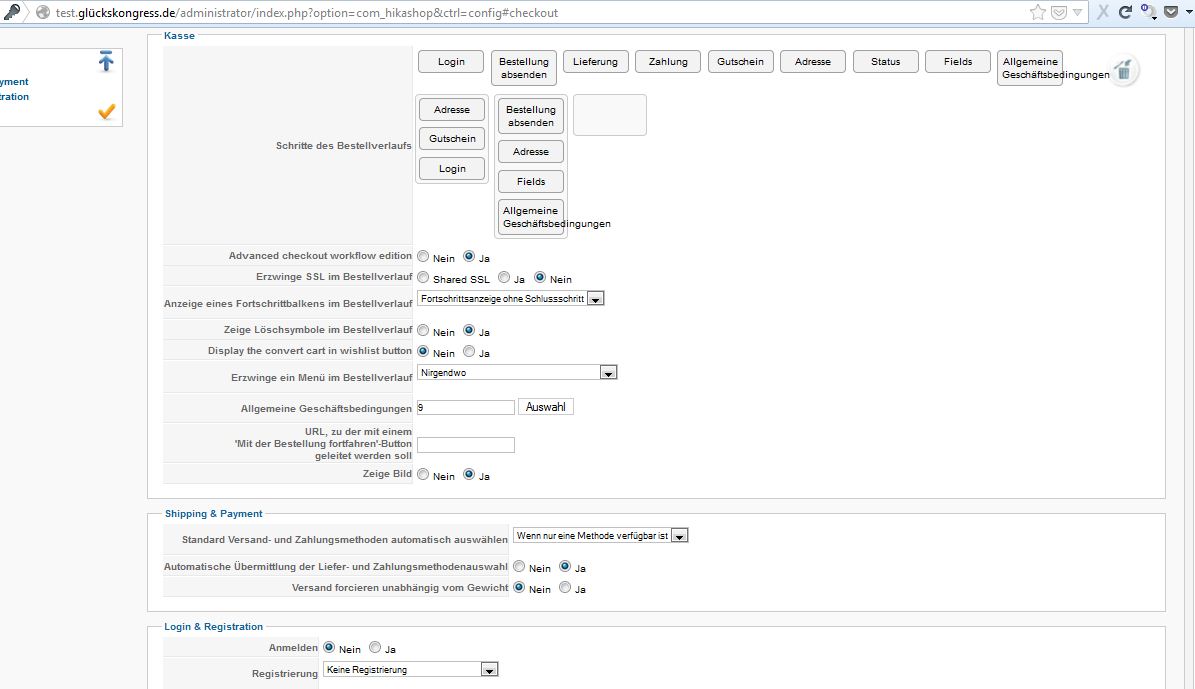

  • Posts: 86180
13 years 6 months ago #93739
You were missing the payment view in your checkout workflow. I've added it back and it's working now on the first attempt.

you are fast and great! That really solved the problem.
I had not expected that it is needed to add the payment view if only one payment module is activated, because there is no coice. But it has to - and now I now that!
