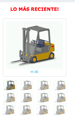

I have a Content_Module listing products in carousel mode. If I am not wrong some days ago each thumbnail was changing the central product once clicked. Now the "Hand" cursos appears when hovering on the thumb, but it is not reacting.
I have a custom view for the module, but when using default views the problem persists so I think it is not my fault.
I could not find any similar post in the forum so maybe it has to do with latest versions...

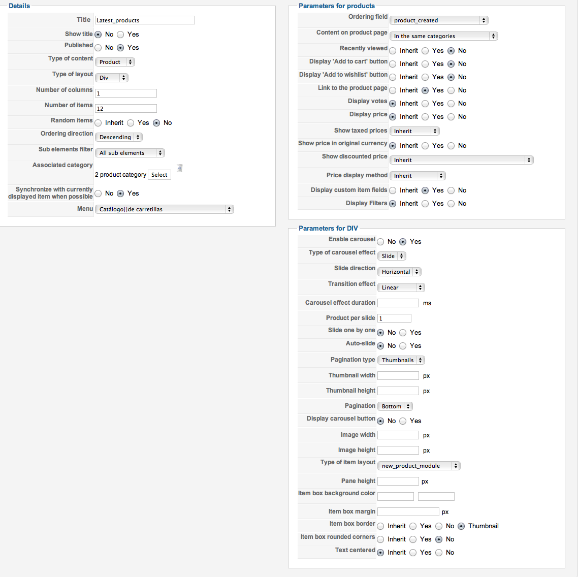

this is my setup for the module.

It come maybe from a JavaScript error, can you give us a link to a page where the problem occur ?

13 years 5 months ago #99293
You have a javascript error, probably coming from your custom module:
TypeError: $(...).addEvents is not a function
[Stopper sur une erreur]
"click" : function(event){
At the line "199" of your homepage source code.
$("slide_number_hikashop_category_information_module_104_0").addEvents({
totIncrement = increment*(-0);
if(totIncrement<maxRightIncrement){ [...]
