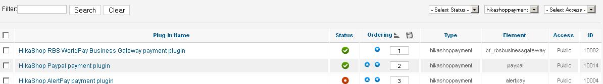

13 years 4 months ago #104088
Hi Nicolas, please see the picture attached. Worldpay is indeed the first in the ordering!

  • Posts: 86180
13 years 4 months ago #104279
I checked your website and it seems that you turned off the option "Auto select default shipping and payment methods" of the configuration.
Please make sure that this option is on or the first payment method won't be automatically selected.

  • Posts: 21
13 years 4 months ago #104281
Hi Nicolas, I set "Auto select default shipping and payment methods" to YES and cleared the cache PayPal is still selected. Can you try at your end so you can see this yourself? You won't have to buy a Diamond ring!
  • Posts: 86180
13 years 4 months ago #104289
On my end, Worldpay is now selected by default on your website.
