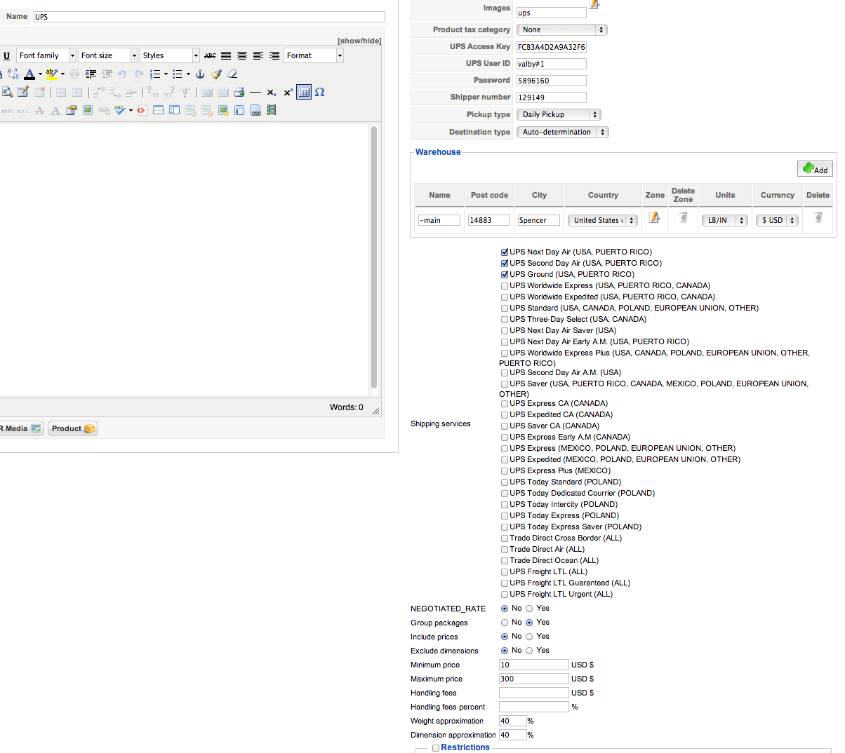

Just configured the UPS plugin for shipping. It seems to work with 1 of each item, and several items - one of each. If you add more than 1 of an item (2), I get No Shipping Method Found. Any ideas?
13 years 5 months ago #99915
It come maybe from the configuration of UPS, have you set restrictions ?
Can you give us a screenshot of your UPS configuration ?

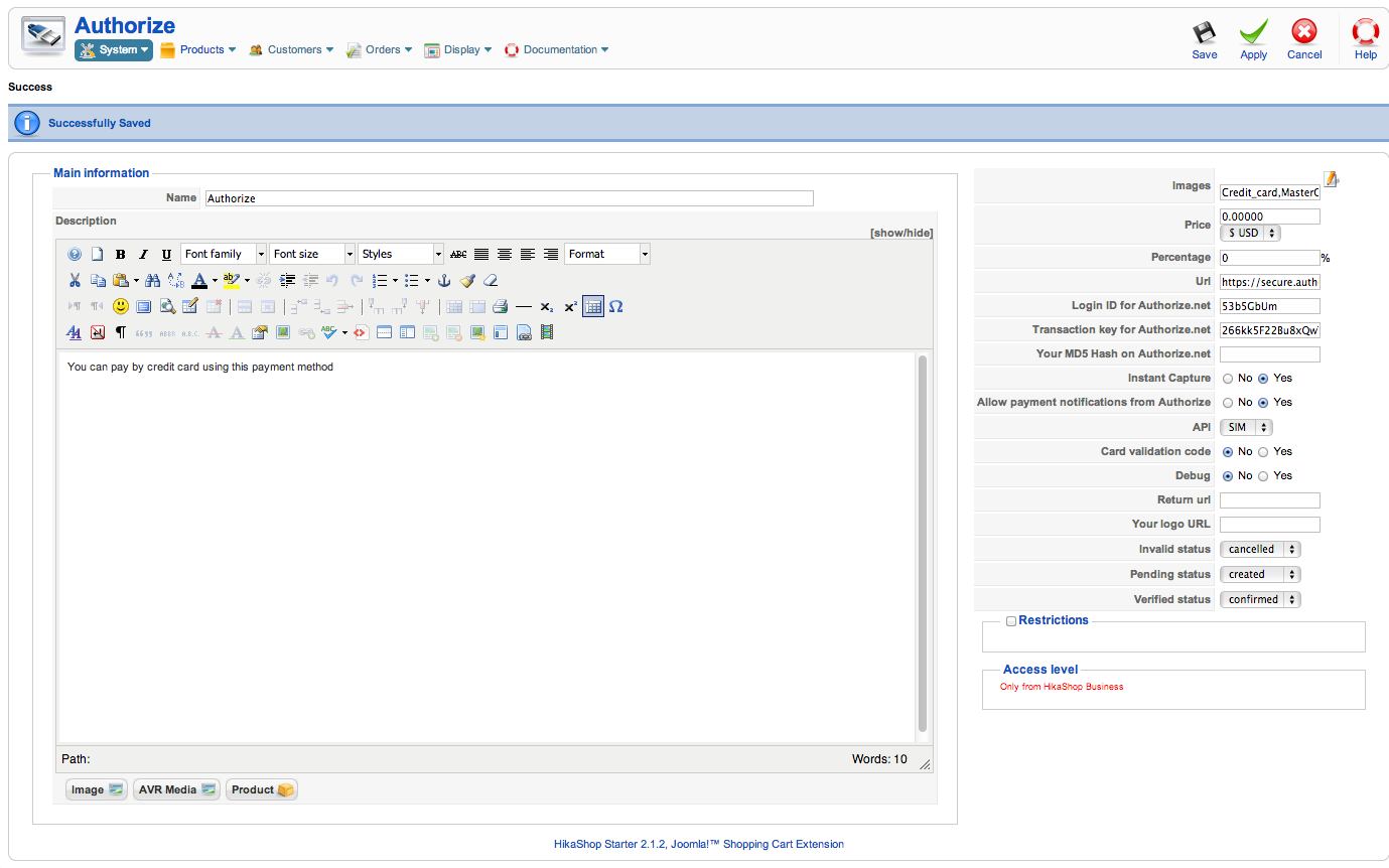

Here is the screenshot. I was able to get the shipping to show up, but it does not add the shipping amount to the order when you go to payment processor.
  • Posts: 86180
13 years 4 months ago #99999
What payment processor are you using and what configuration did you set in the payment plugin ?
  • Posts: 3
13 years 4 months ago #100005
Using Authorize.net. That has been working well for 2 years. We used to use the manual shipping method, I but I upgraded Hikashop on Wednesday to include the UPS shipping method.
