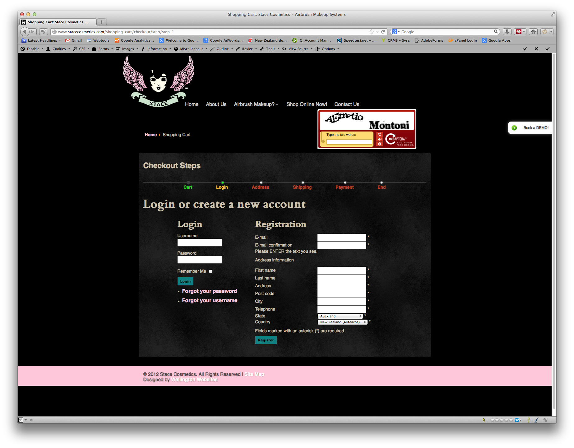

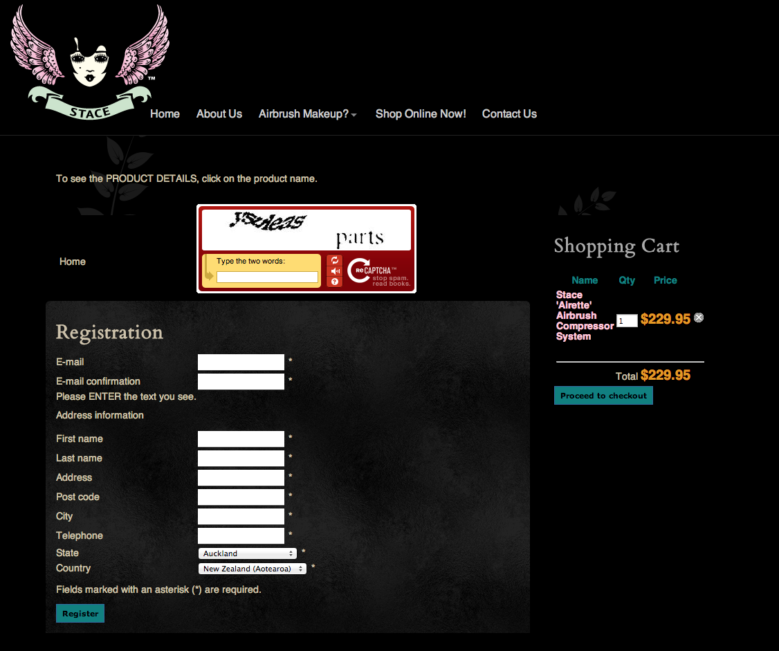

I have had to invoke reCaptcha on this site as we have been receiving many, many false (bot) registrations.
But the reCaptcha box is placed well above Registration Form -- it is even above the article component -- making it really unusable.
(see attached screenshot)
Website: www.stacecosmetics.com

  • Posts: 293
  • Thank you received: 9
13 years 4 months ago #100219
Add something to the cart and try to check out.
It is there.
See attached screenshot.
  • Posts: 86180
13 years 4 months ago #100287
I can see it now. I couldn't yesterday.
It comes from your template's CSS:
#recaptcha_widget_div {
position: absolute;
top: -140px;
in the file www.stacecosmetics.com/templates/rt_visage/css/joomla.css
Remove that code and it will work.
  • Posts: 293
13 years 4 months ago #100401
I modified that CSS and it looks perfect now.
